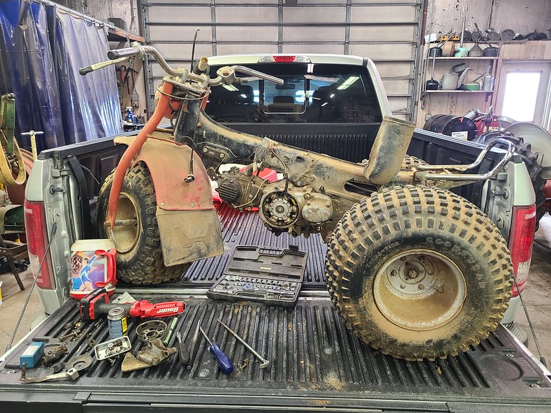

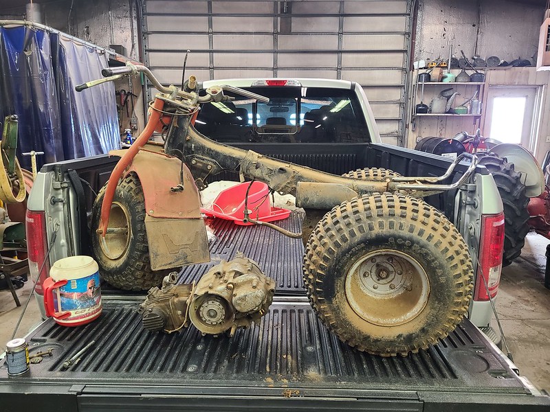

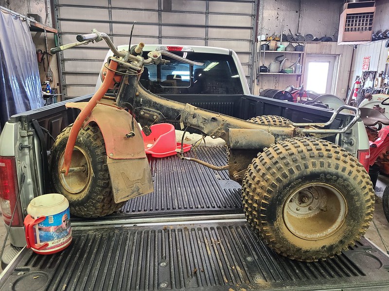

Did some rearranging in the chicken house to make room for my pickup bed, while I had it out I did some looking at my 110.
Will need isolator bushings for the drive sprocket

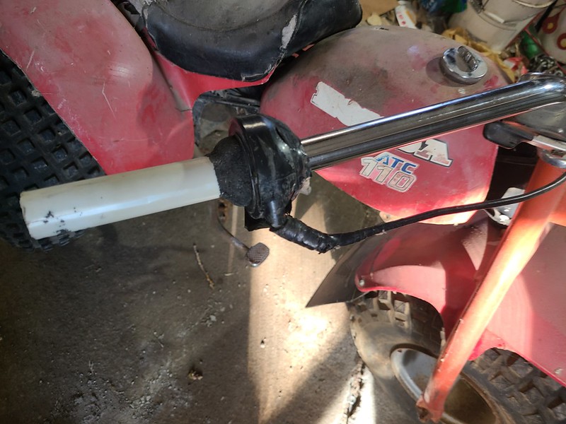

Somebody added a twist throttle to it which is of course broken and the cable is seized. Thumb throttle is still on the handlebar so I need a throttle cable for that and both grips.

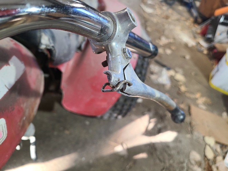

Handlebar brake handle is broken, it does have the parking brake clip though. I don't even remember our old one having one, it might get deleted. Cable is good for that though...
Not much to them without the plastic and tank (need bushings for the fuel tank)

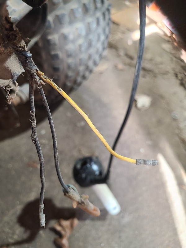

Mice have been into the wiring going to the engine.

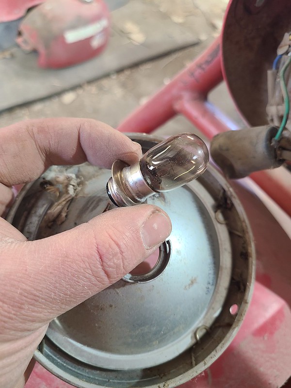

So I pulled the headlight off to check to see if we still had connections from A to B.
Yeah, I was as surprised as you are the headlight bulb was bad...
But yeah, the wiring still goes where it needs to go so I think a little heat shrink will fix that.

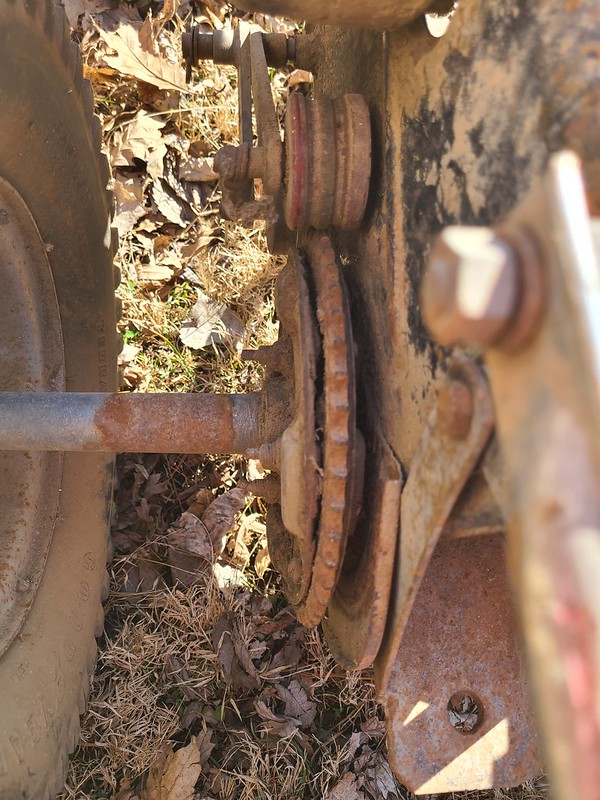

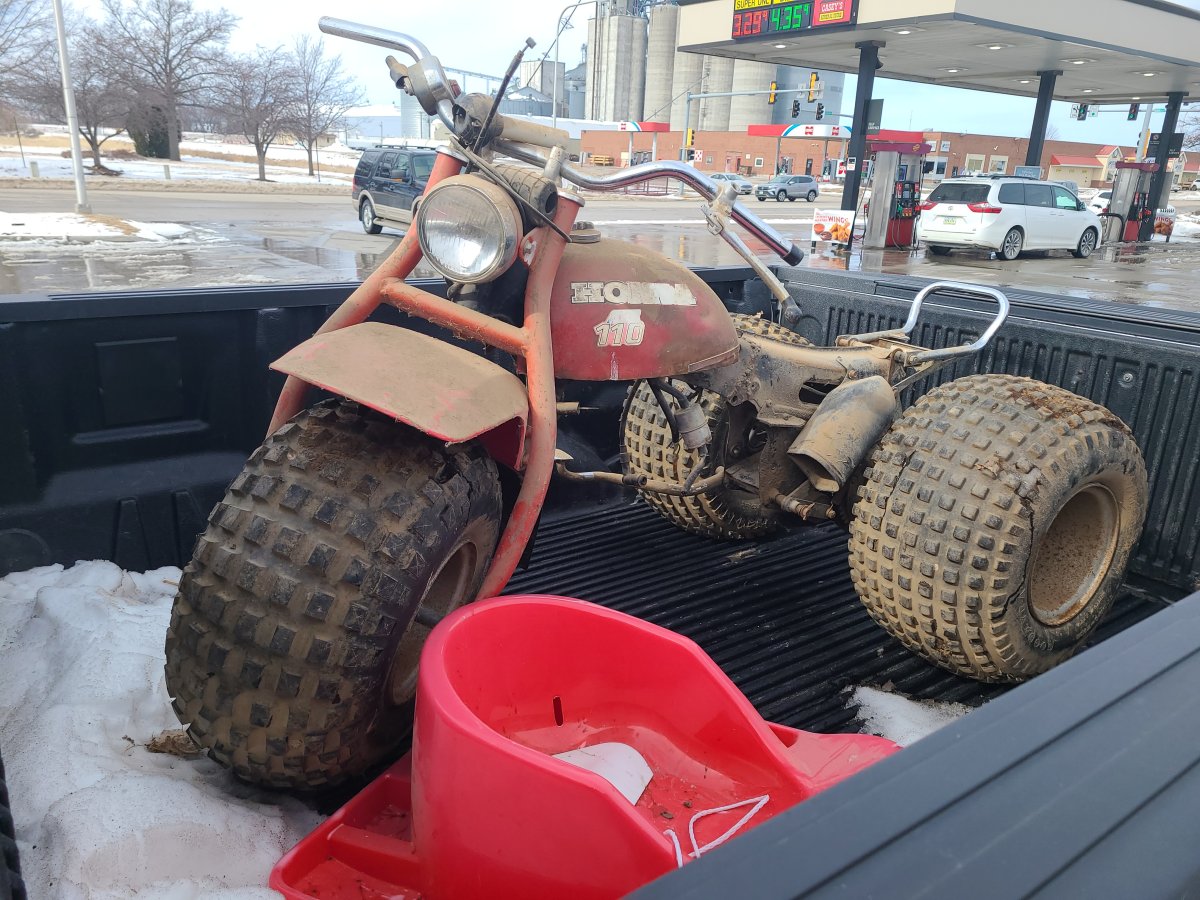

It needs a lot which I knew when I initially bought it for parts... but not turning around yet on reviving this thing. Just a bunch of piddly crap, the voodoo that is the rear axle is kind of daunting though. I know there is an adjustment to the rear axle but for the motion the thing has and the growl when it rolls I bet the bearings are toast.
The rear carrier bearings are some of the easiest bearings I've ever had to replace. First whack of the dead blow and they come flying right out. Got new ones from ebay for like 12$ shipped.

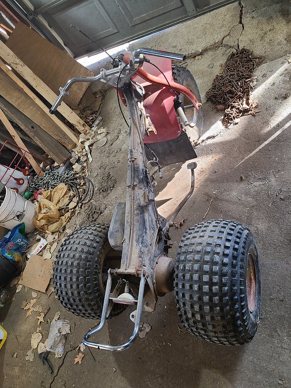

Two years later, going to play with the 110 today.
I oughtta figuratively fire back up my 200x project.. ugh. Project ADD is soul crushing.
