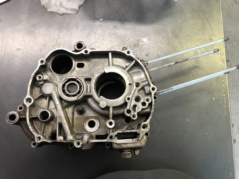

Slipped the cover off my wife's and more bad news there. The boss that broke off is actually part of the transmission case. So if I have it welded I have to explode the trans.

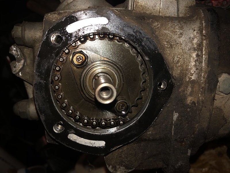

Going deeper into the 110...
1984 atc125m
1984 atc125m

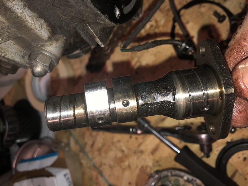

Cam doesn't look bad.
1984 atc125m

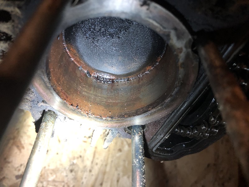

Top end is clean.
1984 atc125m
It might clean up, she is still stuck tight though. Some scoring but it looks like water got in it and it rusted more than anything.
1984 atc125m

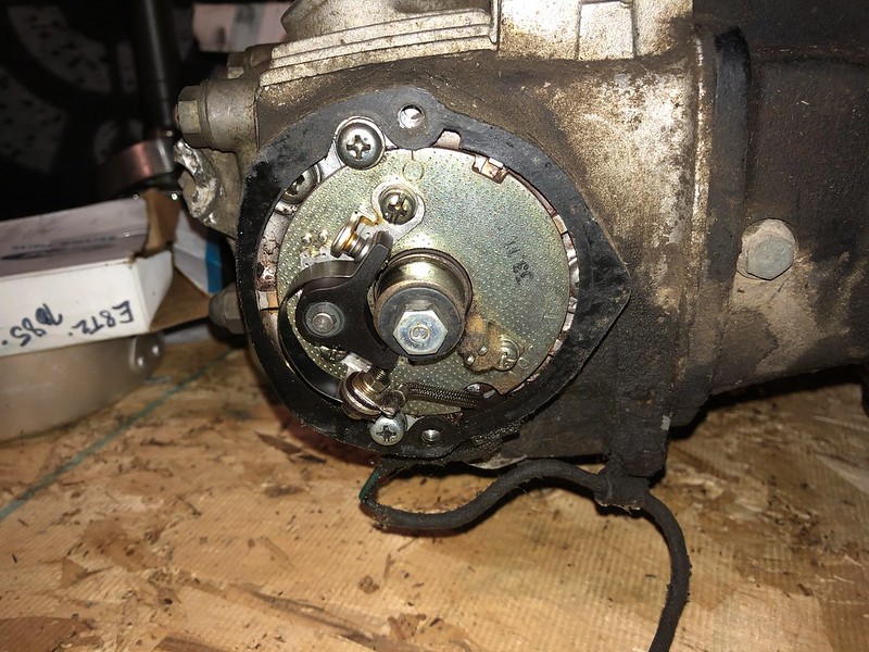

I am probably just going to set the valves in the 90, clean the filter, change the oil, replace the points and poke it in.

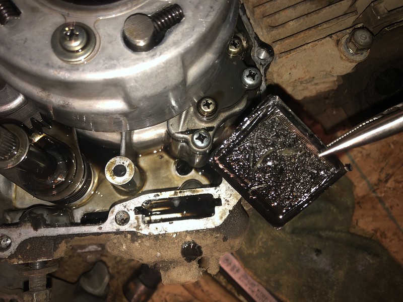

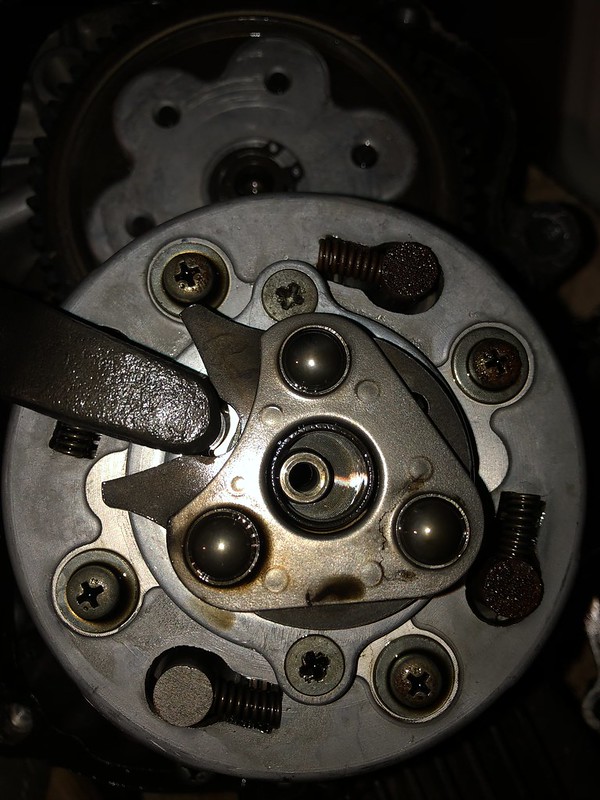

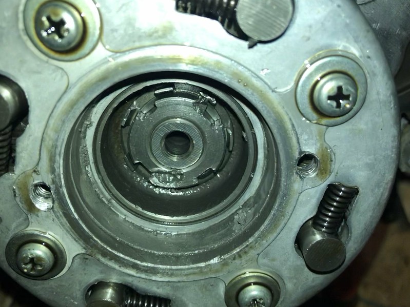

Tore into the 90 to clean the oil screen and centrifigul oil filter. Missing screws on the clutch cover, it looks like they came off because that plate is deformed:
1984 atc125m
Some gunky buildup in behind the cover:
1984 atc125m
Oil screen has stuff on it like it should:
1984 atc125m

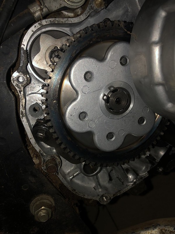

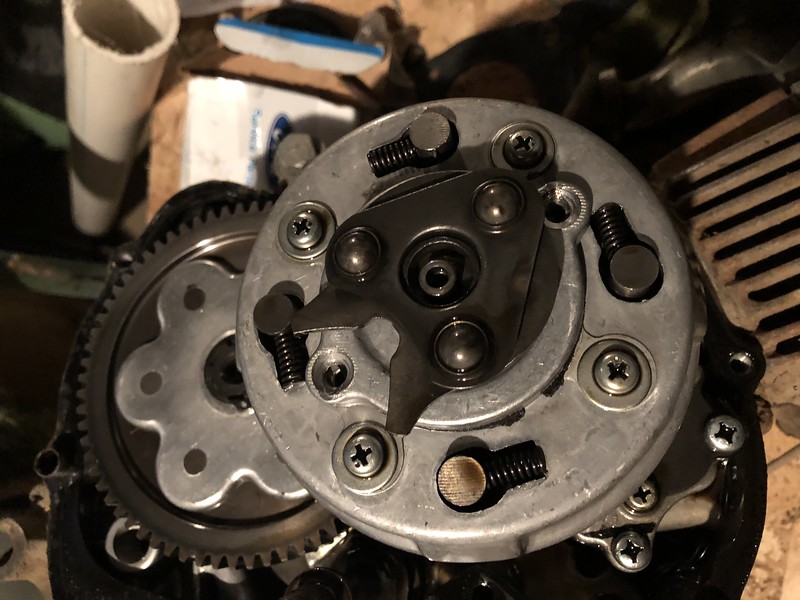

Tore into the 110 to see if it had screws and how that endplate looked. Screws are hardly award-winning, plate looks good though.
1984 atc125m

The boss that is known to break has been welded, now just to blow the whole thing apart and swap crankcase halves... after I get the engine for the 110 done.
