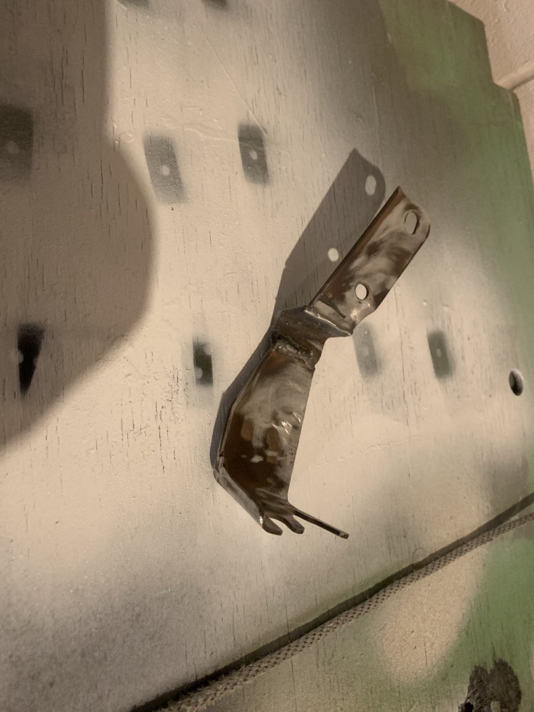

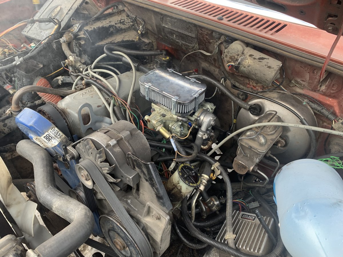

Got it all together and running today. It took some fiddling with the mixture screw to get idle right but it seems to idle nice now. I’ll still have to set the high idle and stuff up. I had to modify the throttle cable bracket and plumb coolant to the choke but other than that the 5200 was plug and play using an adapter for Jeeps with Carter 1bbl carbs. The heater tube on my water outlet is buggered up and sprayed coolant everywhere on my test drive so now I have to wait for the RTV to set before I mess with it more. I have a cheap air cleaner I found on eBay for now until I can fab something nicer up. If my photos don’t work due to size I’ll try and get them up Monday when I have a pc again.
