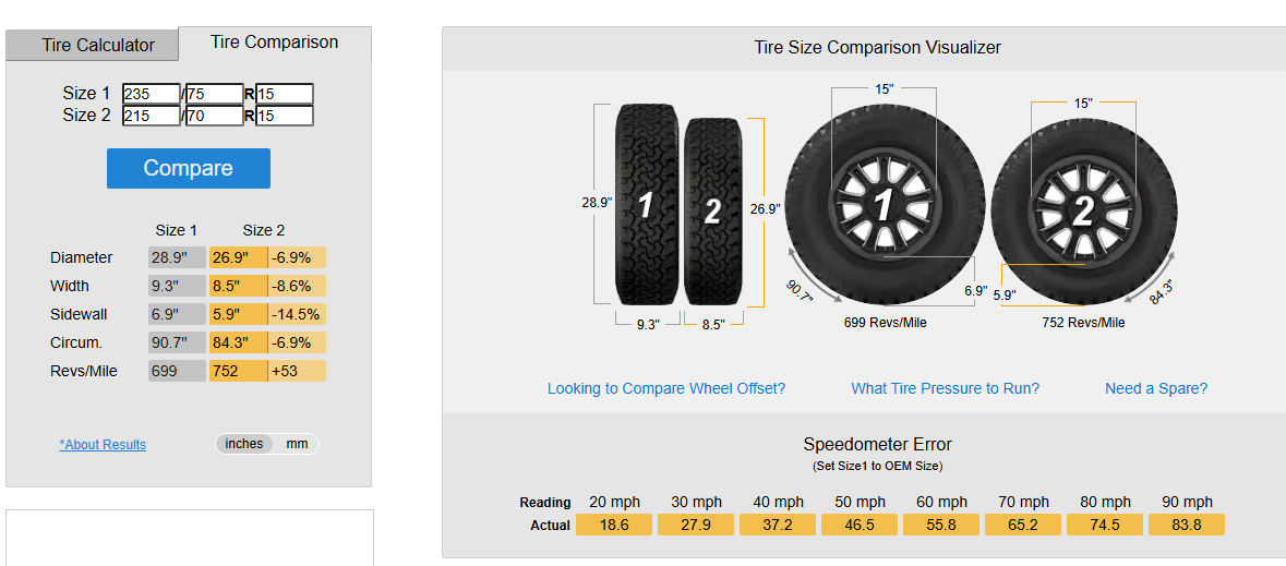

So, I am here because I'm looking to put 235/75 r15's on my 1st generation 2wd Ranger... How did you make out?
I had 30x9.50R15 on the back of my previous truck. It's the front one in that picture.
235/75R15 is 28.88. So you should be fine.

Actually the fronts in that picture are 215/70R15. (26.9) Now that you specifically ask, IDK what the tallest tire I've ever run on the front of a 2wd was.
The 1st gen is pretty easy to see where taller tires would rub. It's right at lower corners of the front wheel arches. Right where the screws holding the inner fender together are. Front and back are the same distance from wheel center point.

Here's the funky thing. I already bought the 235/75 R15's. Tire Rack has them fitting the '85 Ranger but 4wd. At the time I thought if they fit the 4wd they will fit the 2wd because it's the same body, never thinking about the suspension. I still don't know if Ford lifted the suspension on the 4x4's or not so I thought I would research as to what people have replaced the 14's with. Ugh. I'm still surprised that there isn't any information about this, at least that I have found! Thanks for your help!

I still have the 14's on there so maybe after I find out their diameter I can add to that the difference between them and the 235/75 R15's (28.88) to make a better guess. I'm not sure.

JoshT, Thank you for your reply. I'm not sure how this is going to play out just yet. I'm not sure how involved I want this to become simply because I bought tires that are potentially too large. If returning the 235/75 R15's and going with 215/70R15's erases this challenge then that's the way I'm leaning. Raising the body isn't necessarily an issue but I don't want to start messing with the back leaf springs too.
If you are returning those and getting something smaller that still fills the wheel wells fairly well, the 26 to 27" diameter would be a good range for a 2wd first gen. Unfortunately it is totaled and I don;t have many pictures from when it was still in tact, but this is my 1984 2wd long bed on stock height (minus 20ish years of sag) suspension.

Those are about a 26.5" diameter tire. Unfortunately, an equivalent doesn't really exist in the 15", you'll have to go up to a 27" or down to a 26" diameter.
