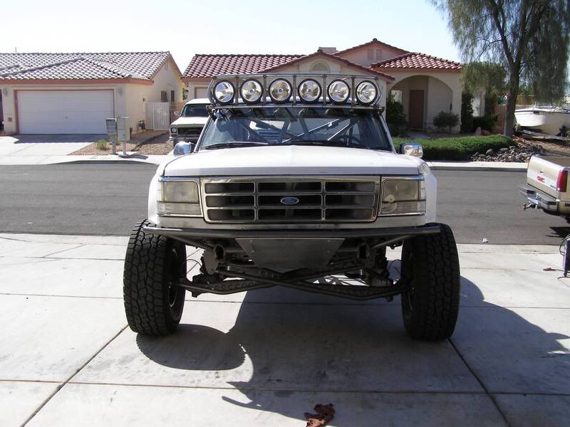

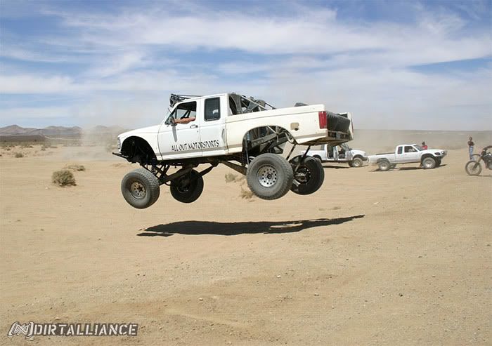

Dude, your looking WAY too far into it.... Any GOOD fab guy could build a set of beams and radius arms to run under a ranger without any issue. I'd have no problem building a set in my own garage that I'd throw under a V8 ranger and push them across the desert as fast as it was able to without fearing them falling apart.
It doesn't take a team of engineers and hundreds of thousands of dollars worth of machinery to make a set of beams... :annoyed:
Garage fab -
OK, I dont want to drop or lift the ''TRUCK'' i want to go 8 inches wider total. So if you with all your knowledge know were to find a set tell me, and i will go with them to save you the stress !
I still stand by what I said (the mentality part), it's just applying to what I assume is intended to be a prerunner not a street machine. I'd also like to point out that prior to my last post you never stated your intents for the truck. Most people asking about Cobra brakes are going the lowered street truck route. Those people are going to be beating on the suspension on the street, and that's where it is most likely to fail. Sounds like your plans are to beat on it off road, if it's going to fail that's where it's most likely to happen.
Could you possibly use a set of full size beams instead of Ranger beams?

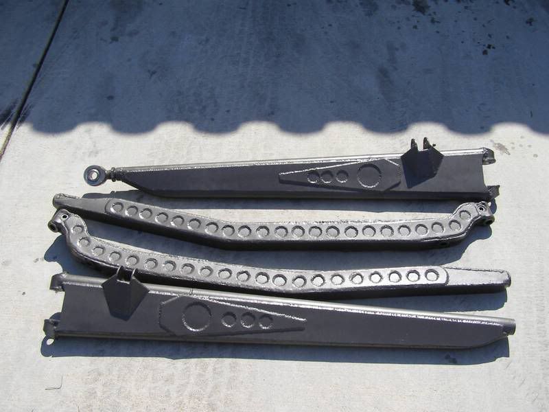

Knowing your intents I'm not as against building your own. If you are going to do it go full custom like the ones posted above. Sounded like you wanted to stretch stock beams, and I wouldn't trust the stock beams to hold up after cutting and welding. If you do decide to build you own custom beams you could use almost and spindle you wanted to.
Trust me you aren't the cause of my stress. It just escapes here on occasion.
That's not exactly a set of modified stock beams. Those appear to be completely custom.
