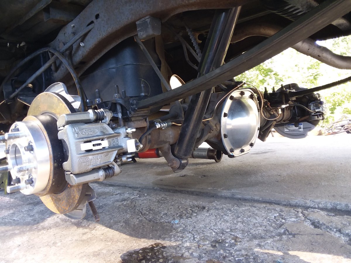

Ive got mustang rear brakes on my rwd ranger. But they are just gt, smaller ones with mustang 17" wheels plenty of room. Not sure if 16's are big enough for the cobras but 17's should definately fit
  • 98 cobra upgrade /93 ranger 2/wd

@smccatv You probably want to run spacers with most (all) Mustang rims, so the bearing cap doesn't interfere with the rim center/the offset is correct - you can see @Rangeritus is. (Ranger rims are 0-12mm offset, Mustangs are 30-40mm).
Yes had to add the spacers so the mustang wheel centercaps cleared the spindles
