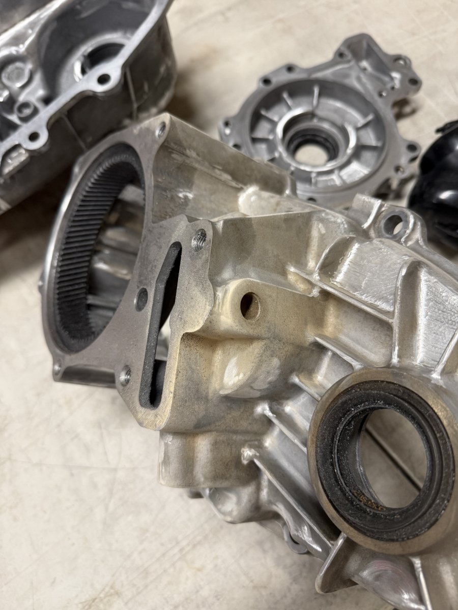

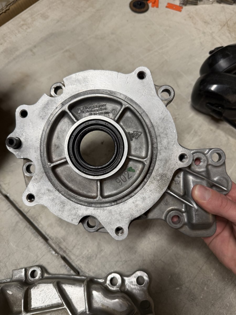

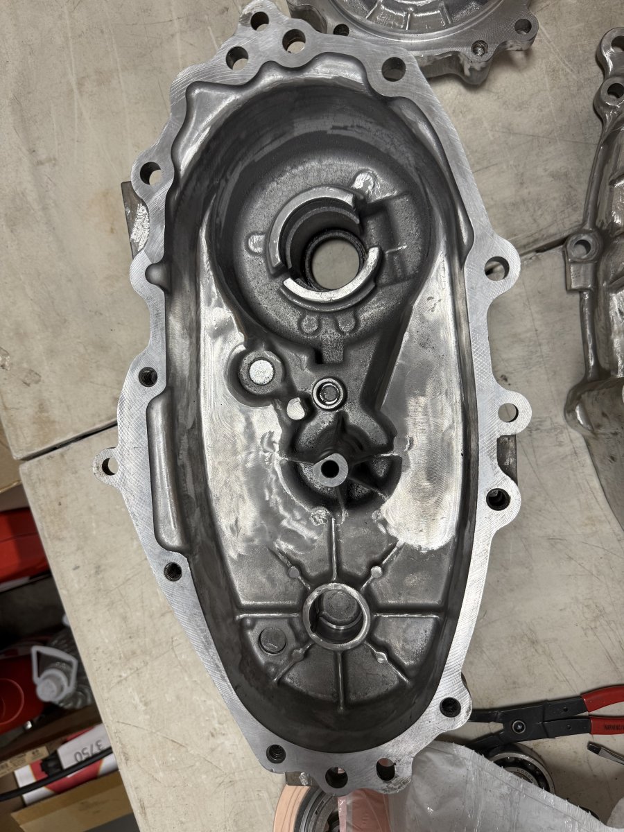

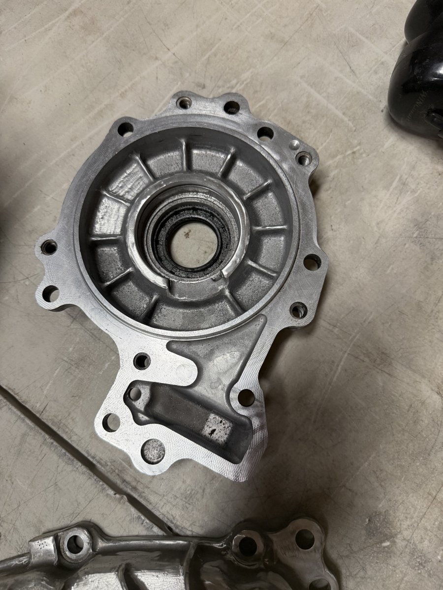

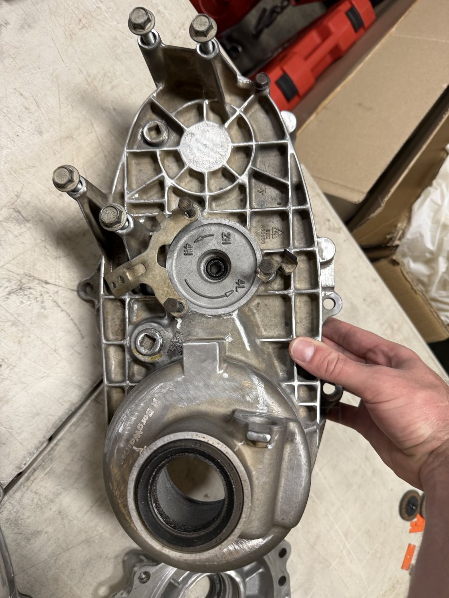

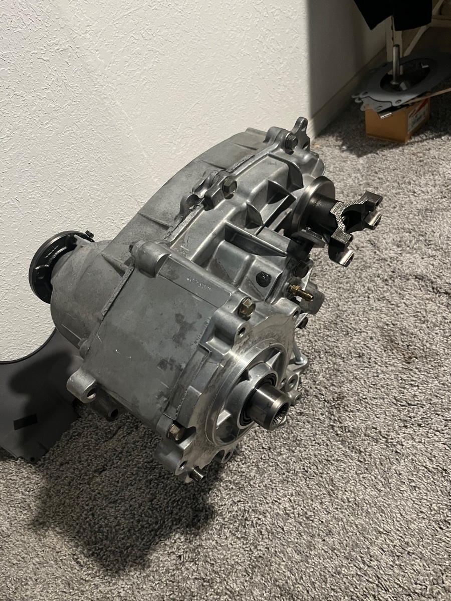

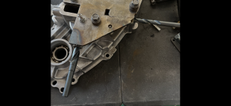

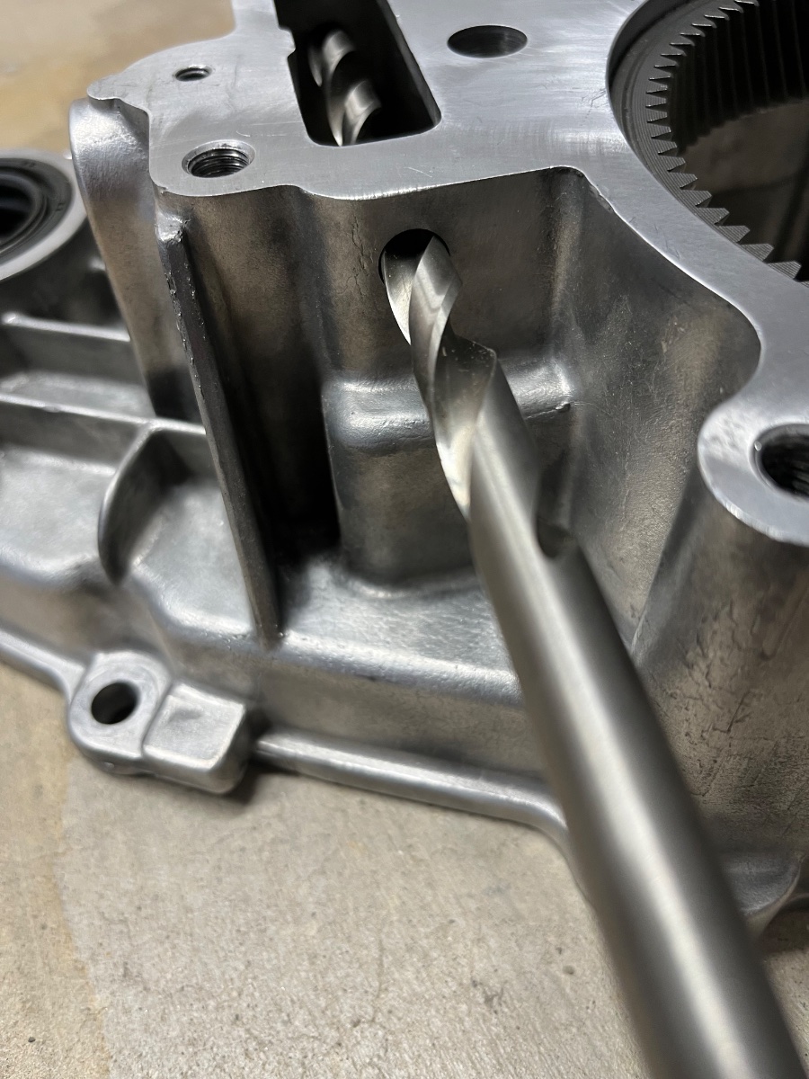

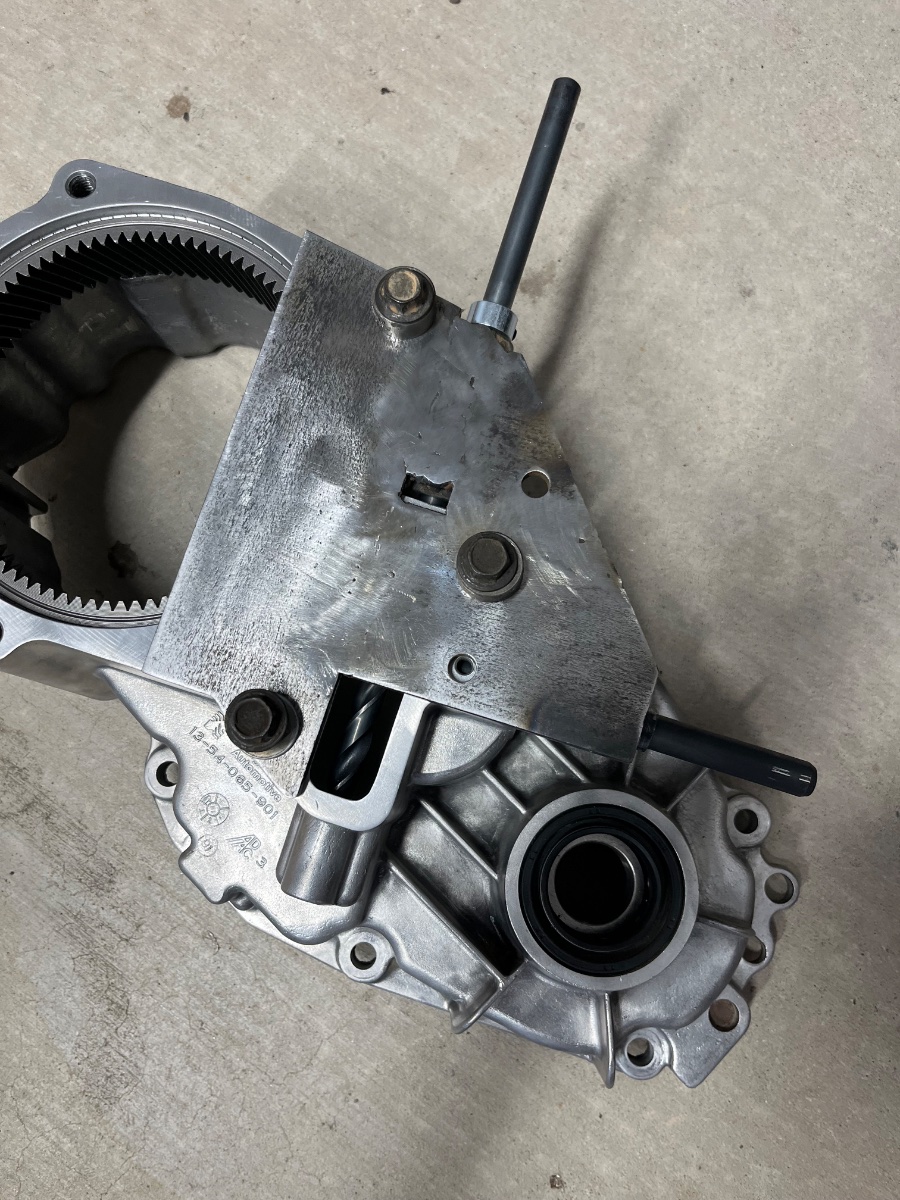

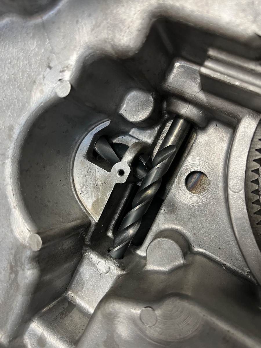

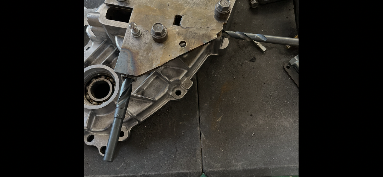

here's a few more pictures.

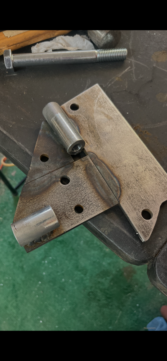

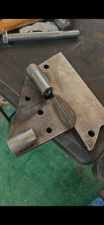

I made a jig from a manual case. The detent hole is drilled from the outside and I seal it with a 7/16 expansion plug and some sealer. All the manual parts from a 1350 are used except the shift shaft because it is shorter than the 1354m shaft. The 1350 shift shaft could be used but the outside of the case would need to be machined/ground down.

I'd be tempted to buy something like that for my own use...
Though a smart man would probably consider offering a drilling service. Just have people mail you their front case.
I think there are differences in the thickness of the 1354 case where the shift shaft goes or of the 1350 shifter. Mine looked like it would've worked, if I hadn't miss drilled the detent hole.

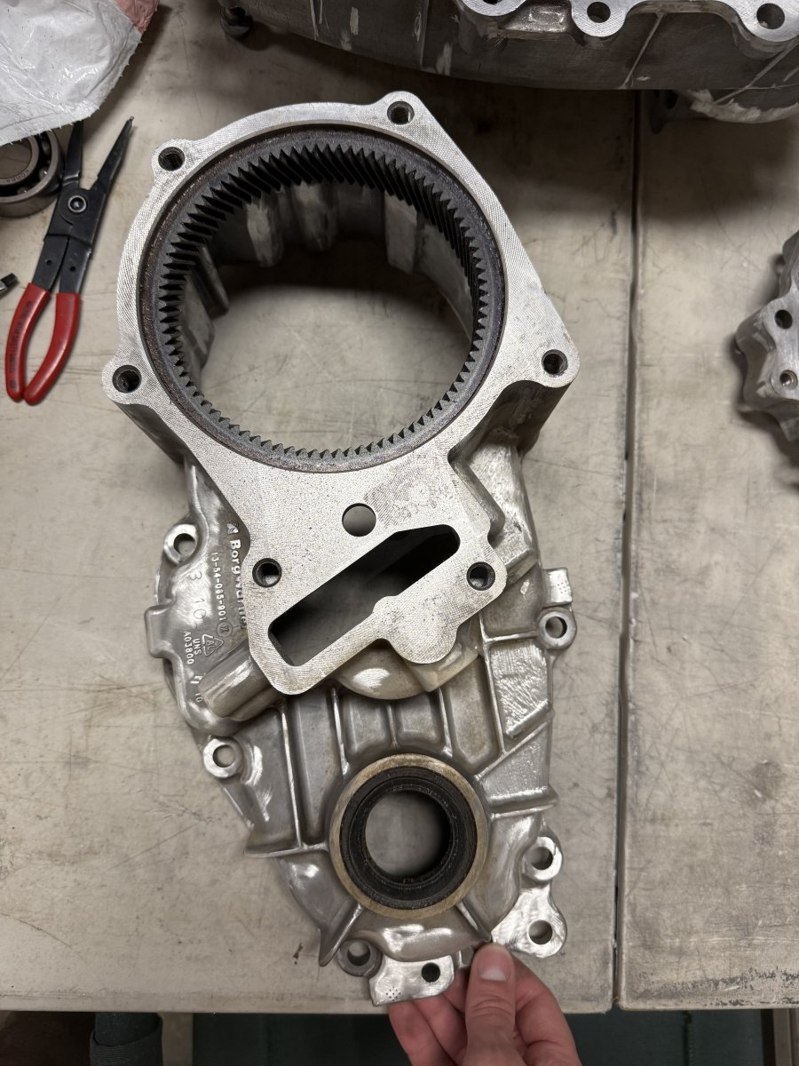

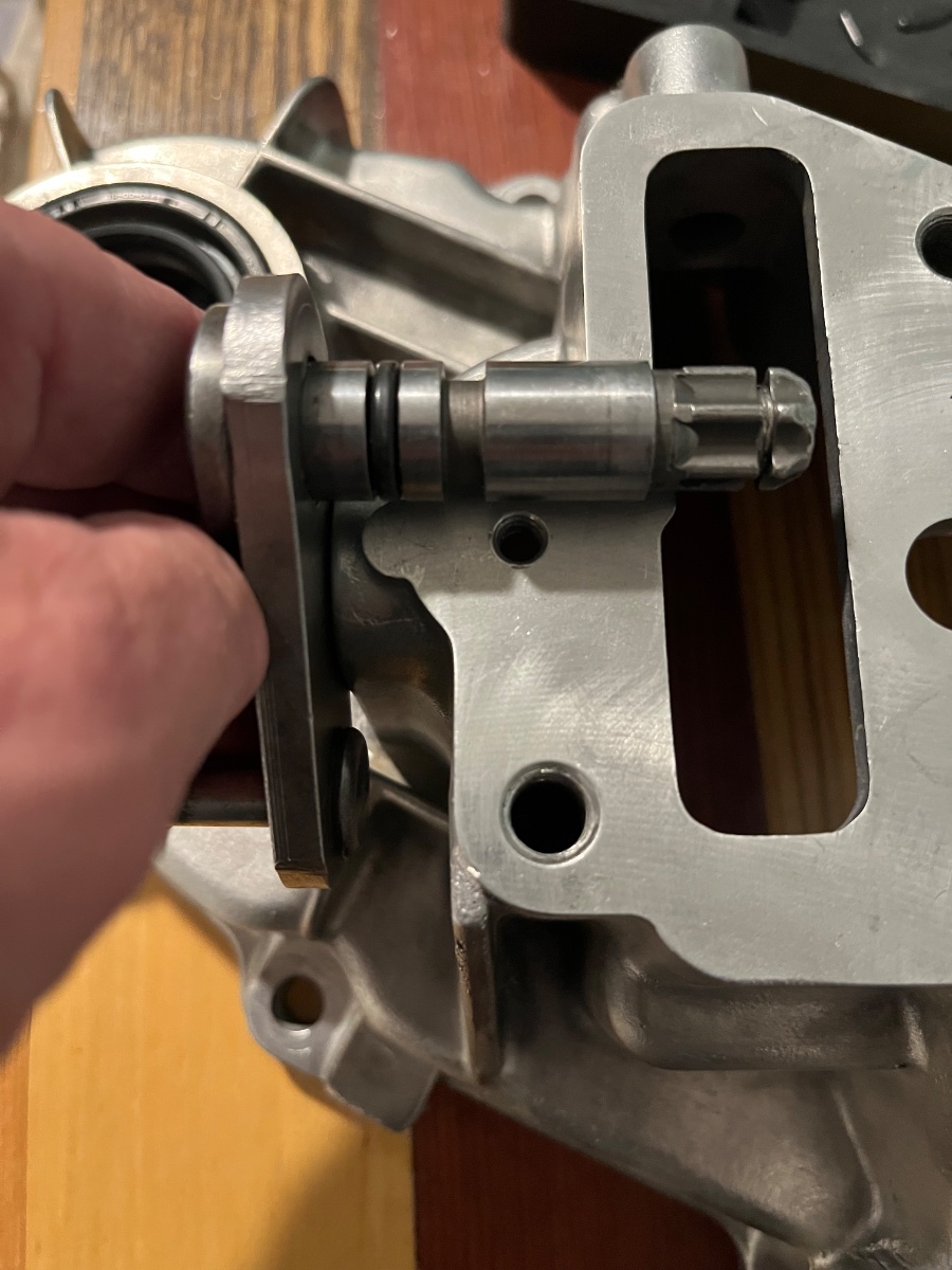

I would offer to drill them if the 1354m shift shaft was available. Maybe when I come up with a solution for that. I don’t think it’s a good idea to grind down the outside to make the 1350 shaft work. Pic of 1350 shaft on 1354. Too much material would need to be removed to get the locating screw into the guide of shaft in my opinion.
