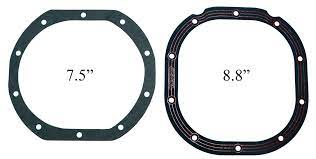

3.08's with an overdrive transmission wouldn't work here, I hope you live in a flat area. Plastic rear end covers, intake manifolds, valve covers, etc. weigh less than steel or aluminum, that's why they use them. Less weight has the same effect as adding power but also increases gas mileage. And they don't rust or corrode. It's easy to tell a 7.5 from an 8.8: 7.5 rear covers are flat top and bottom with curved sides and an 8.8 looks like a square with the corners rounded off.

3.08's with an overdrive transmission wouldn't work here, I hope you live in a flat area. Plastic rear end covers, intake manifolds, valve covers, etc. weigh less than steel or aluminum, that's why they use them. Less weight has the same effect as adding power but also increases gas mileage. And they don't rust or corrode. It's easy to tell a 7.5 from an 8.8: 7.5 rear covers are flat top and bottom with curved sides and an 8.8 looks like a square with the corners rounded off.View attachment 55501
