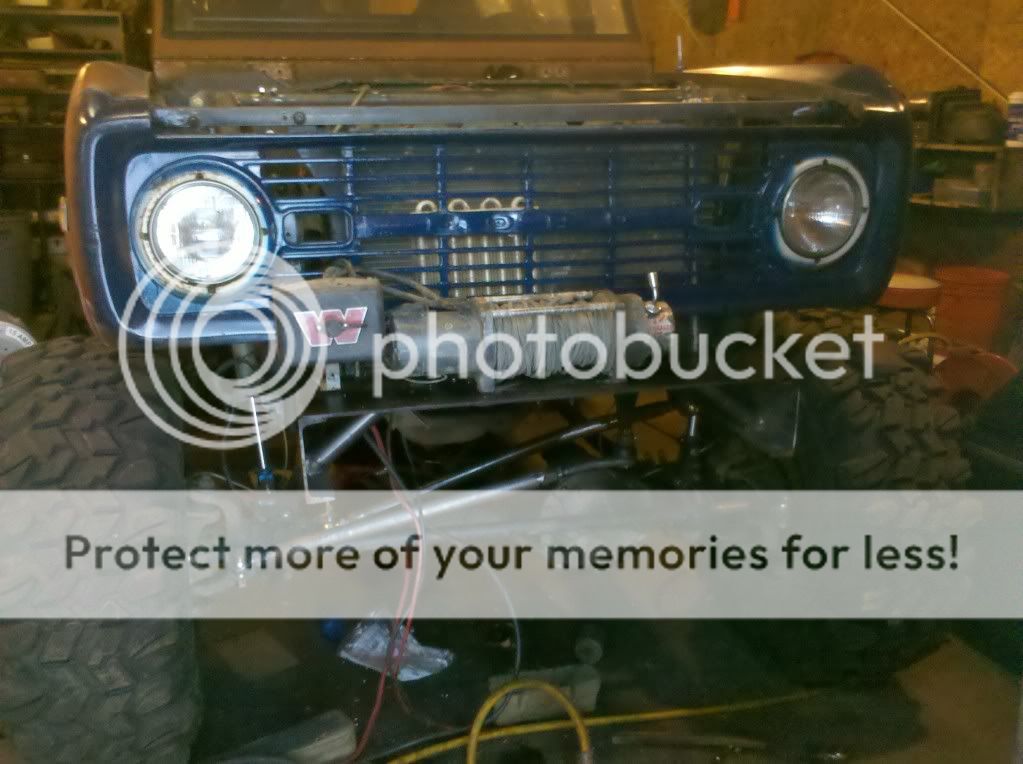

Starting on the bumper.

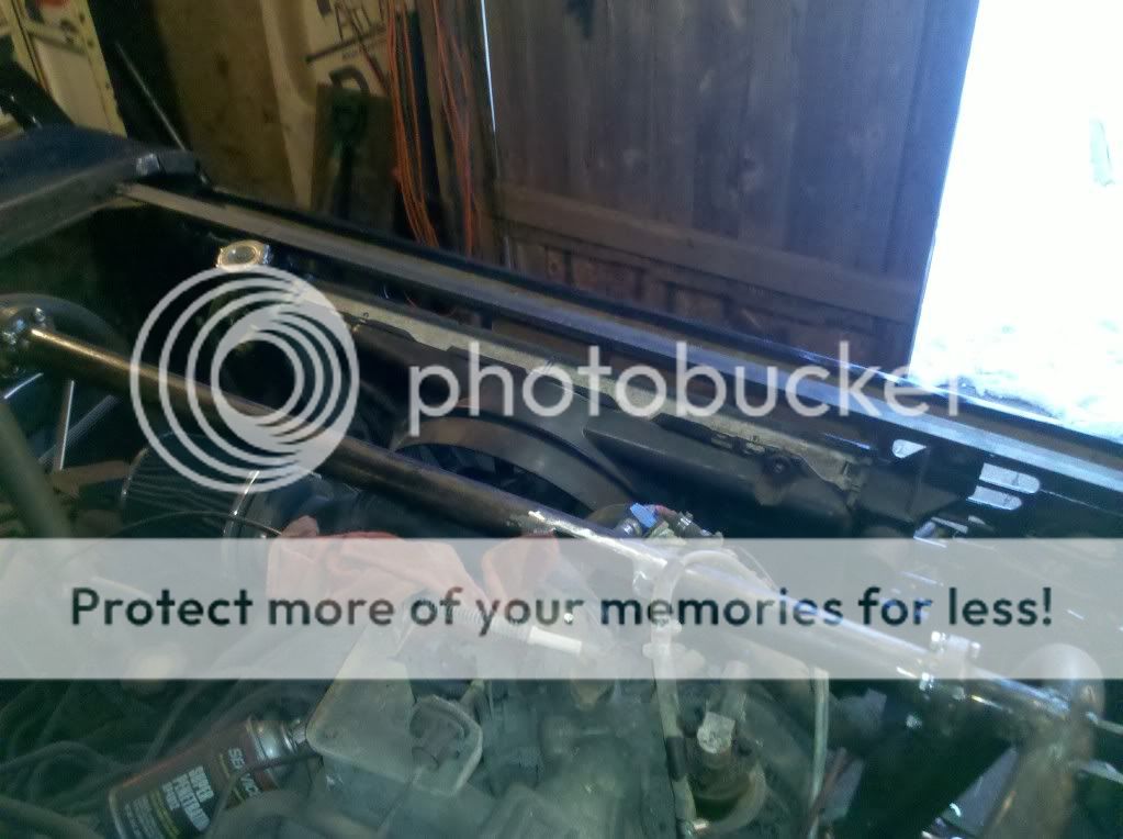

Got my power steering cooler, trans cooler, cooling fan and radiator mounted today. Need to run all the hoses and wire the fan and that should be squared away.
Also mounted the winch, need to pickup some more steel to finish the bumper.

looks like u gonna need to lengthen the drag link too

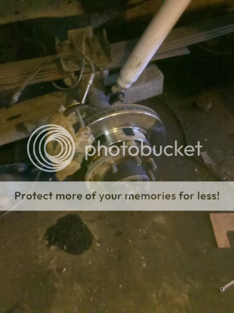

After two years of running drums on the 14B I finally stepped up to the discs. I already had the calipers from a old project. So it was just the rotors and brackets. Rotors were $20 each and ruff stuff brackets.

And worked some more on the front bumper thing..

bumper is looking good buddy!
