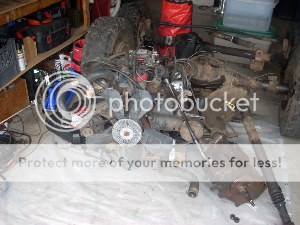

Should be pulling the motor out of my parts truck tomorrow, maybe the axles too. I found a car scrapper that will pick up from your house which will save me some time. I should be finish painting the entire interior monday.
Pulled everything out of my parts truck

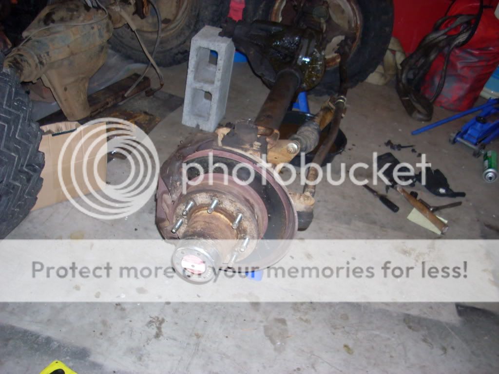

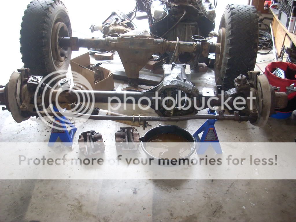

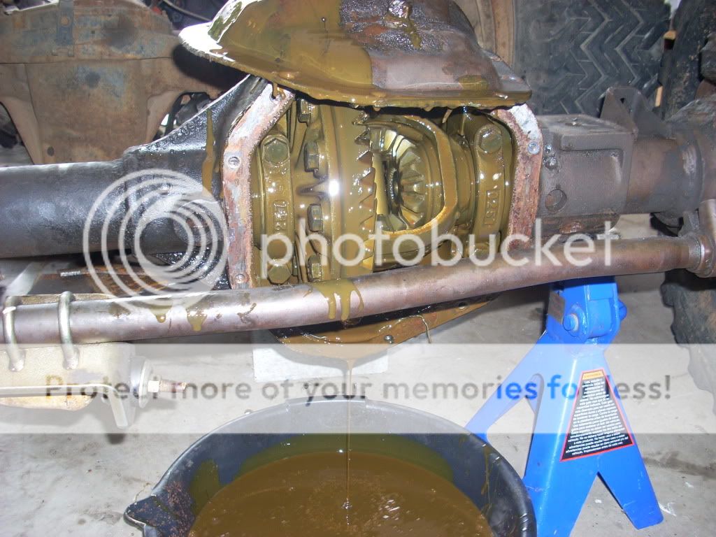

I pressure washed the 60 today and started disassembling it.

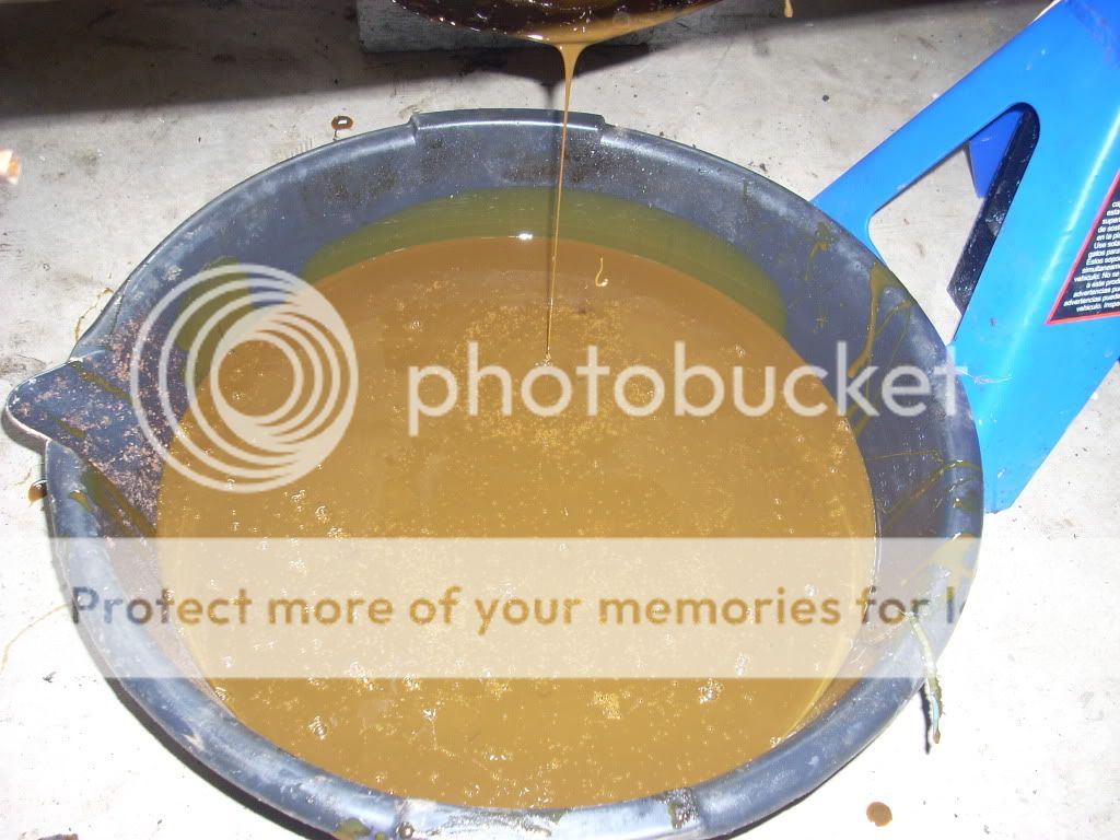

I don't think the fluid has ever been changed in this...

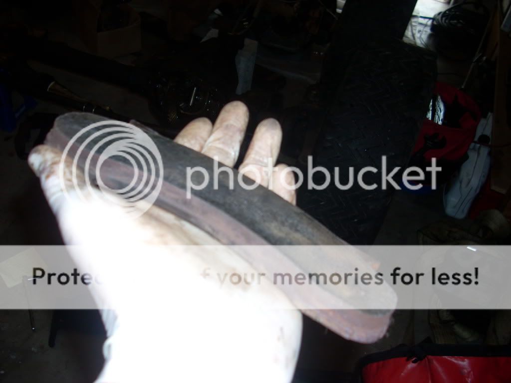

Brake pads look new

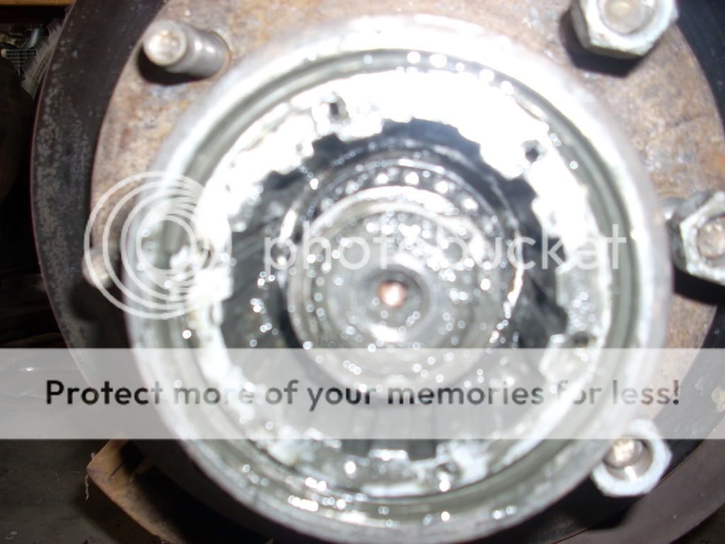

How do you get the big snapring out of here? There aren't any holes for the ends of the pliers to grab it with...
1 ton, caged ranger

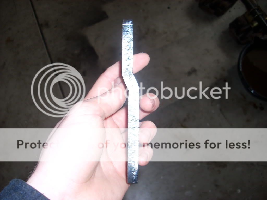

Also I got my offset shackles from ruffstuff
1 ton, caged ranger
that snap ring should come out with needlenose/flathead, but they can be a bear
just use a flat blade screwdriver....get it behind it and pry it out...thats what I did with mine anyways.
Ah, ok I was prying on it a bit but didn't want to break it. Ill get that thing out next time I work on it
I use a 90 deg pick and a small screw driver. Some are easy, some not so much

And that oil is nasty! haha
Make sure to keep those hubs. One of the best set are those. And they have the ability to be bored to 35 spline
