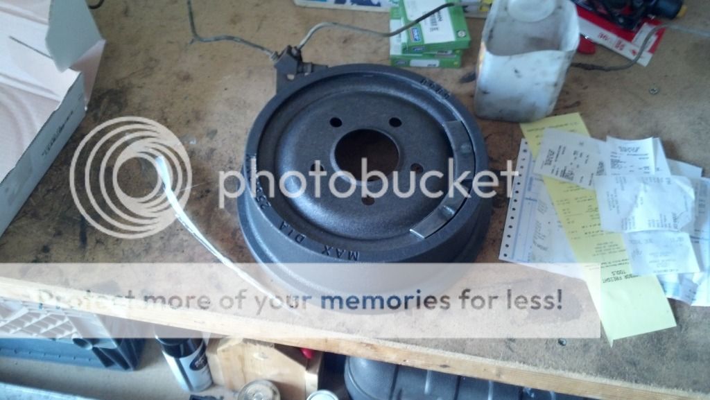

New brake drums, thursday I will be ordering a LSD rebuild, wheel bearings and an easy out....

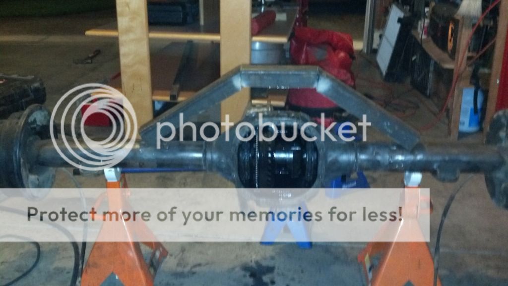

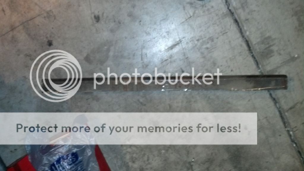

So I decided to build a truss for the 8.8. I started by ripping a 2x4x1/4 in half
1 ton, caged ranger
Then pie cut it and bent it
1 ton, caged ranger

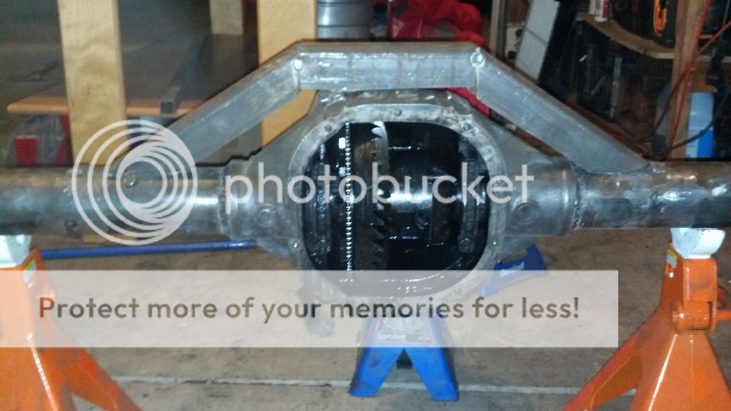

Then I trimmed down the ends to make it fit.
1 ton, caged ranger
I am going to trim the ends a bit more to get it to fit tight. Also I am going to plate all of it in, in between the truss and the axle if that makes sense. It will make a good base to build a traction bar and will be good if I decide to jump it :thefinger:
Also I welded another pass on the axle tubes.
Question, when I weld the truss to the center section I need to preheat it correct?
yes theoretically you should, but did you pre-heat the housing before you welded in your axle tubes? same difference. Some guys will tell you to pre-heat, others will say go ahead and pull trigger.
Also, make sure you peen your stop/start points.
I didn't preheat when I welded the axle tubes, but after the first weld at level 6 it was pretty hot lol. I will when I weld the truss, to be honest I'm not too worried about it
pre-heating is really only necessary if you do not have a welder that gets "hot" enough....
with a 220v welder you should be able too....
