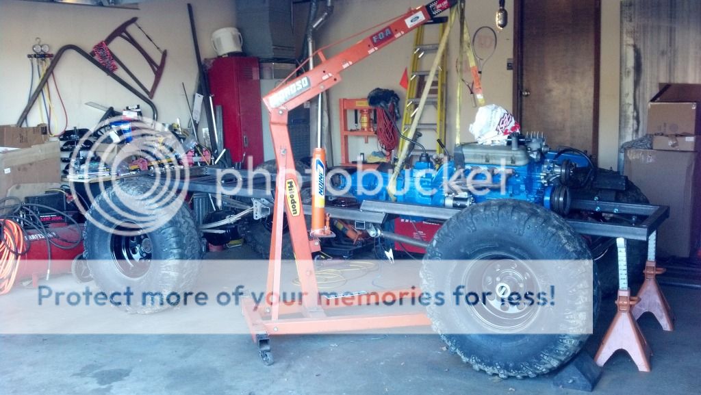

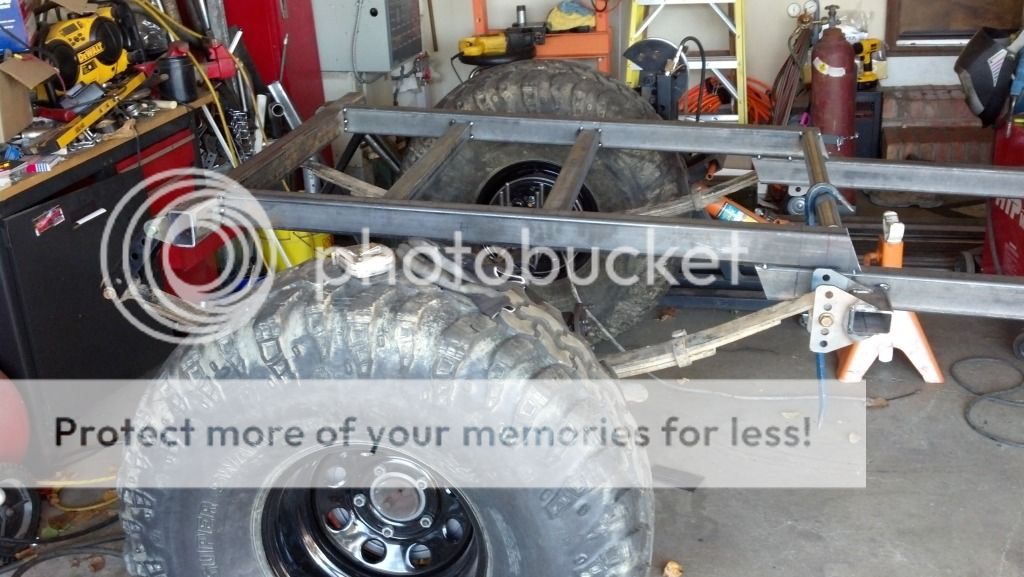

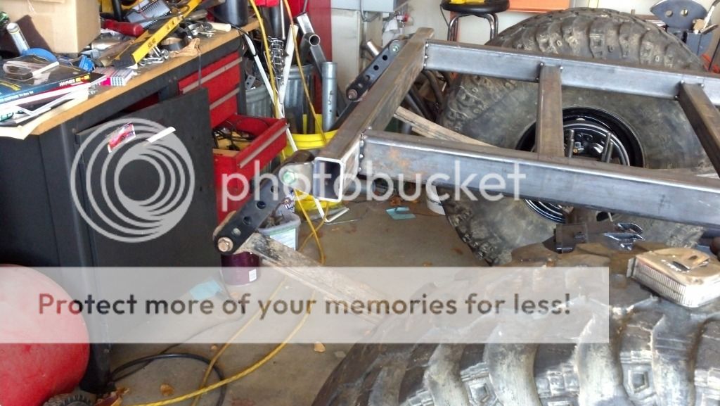

Now it looks better. Also moved the front spring mount forward and up.
I'd Inboard the springs while you are at it. Looking good so far.

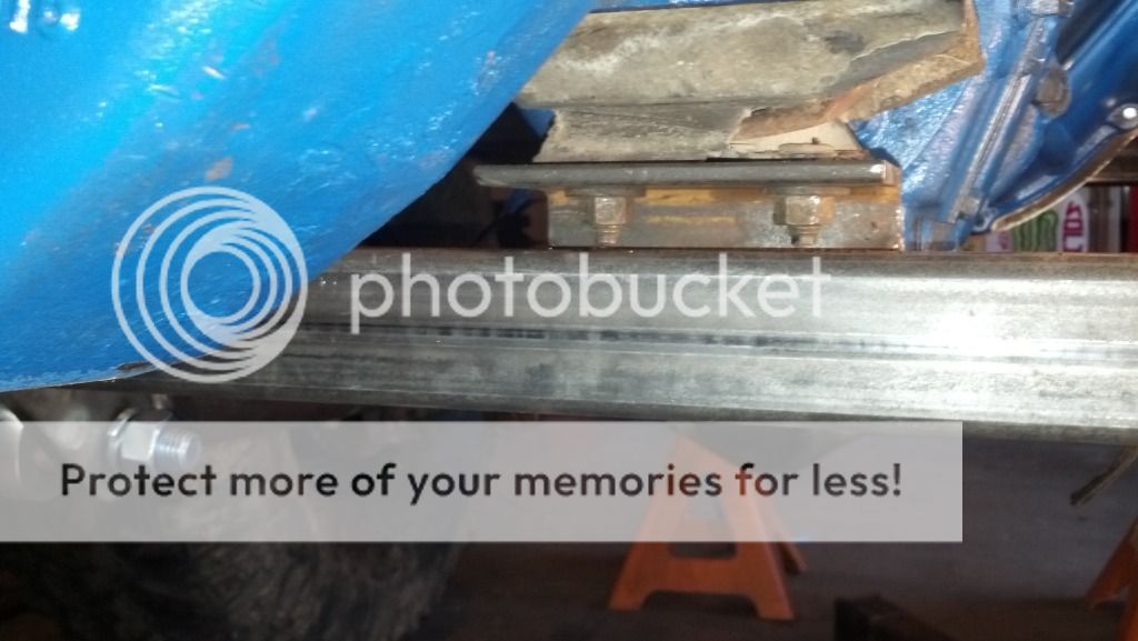

Used a stock trans mount but the rest will be fabricated. Will probably make a cross member under the oil pan to attach the motor mounts to.
Could you have mounted the sliders in the front?
probally could but people say front shackles are no.good. personally in my samurai ive never noticed a difference. same in my91 f350.
did you get the sliders as the weld together kit? im looking for a set to sas a yota soon but cant find the un welded kit
I don't know, I've seen it done.
No they came welded. If you want them send me a PM.

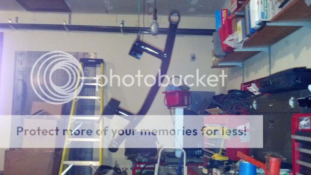

you will be bending tube before ya know it....

I will after the radiator and winch location are figured out.
I've got some ideas for the tube. Can't wait!

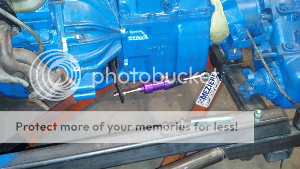

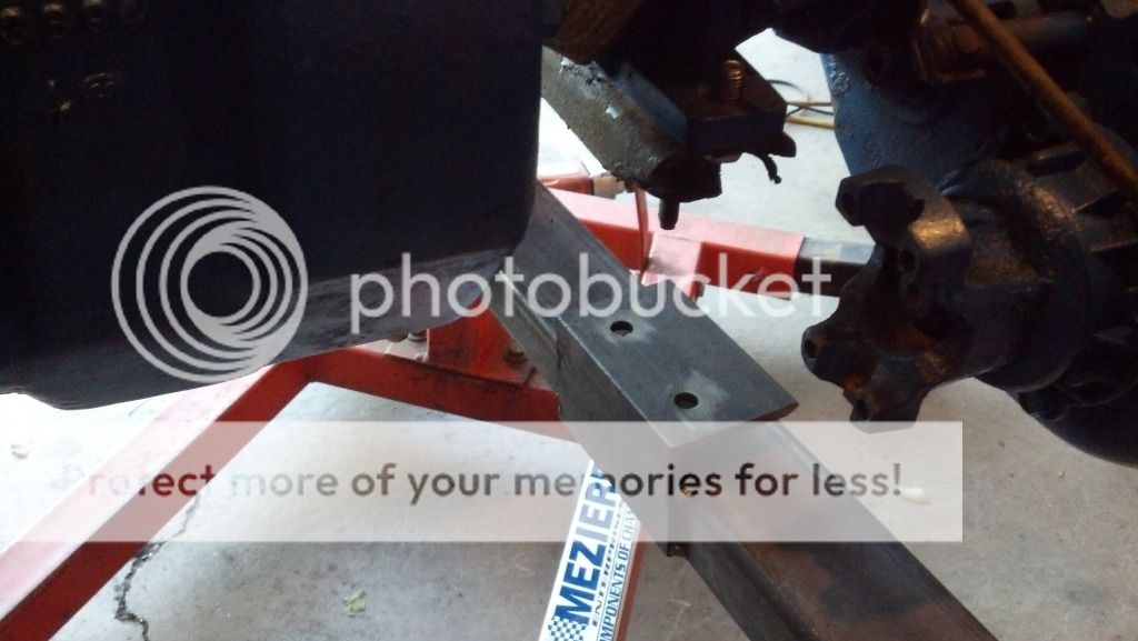

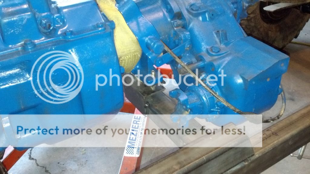

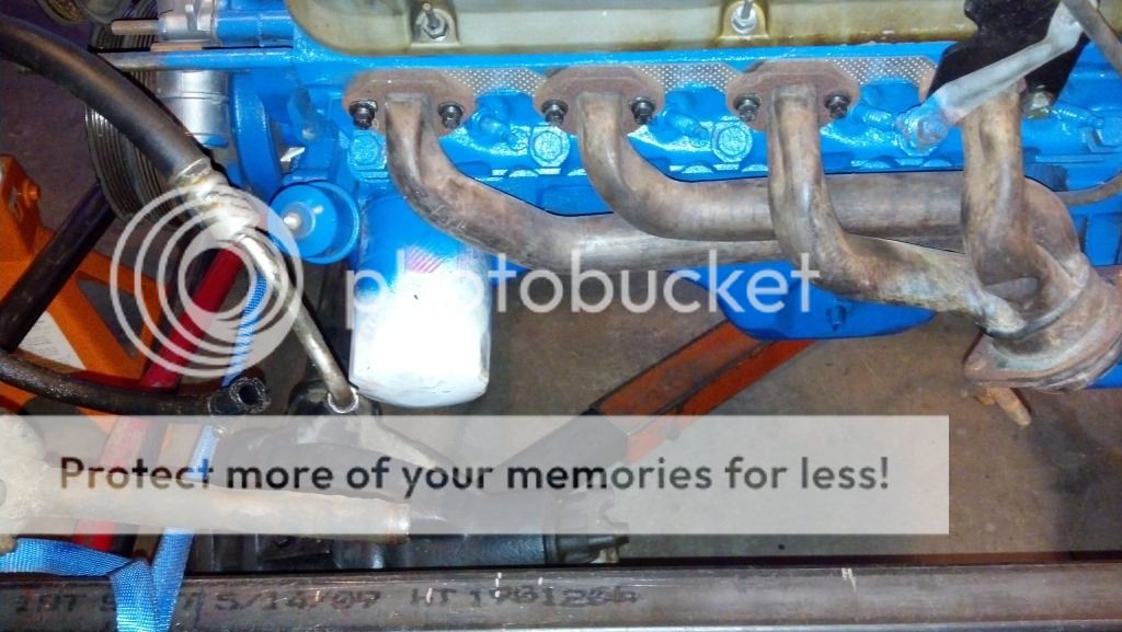

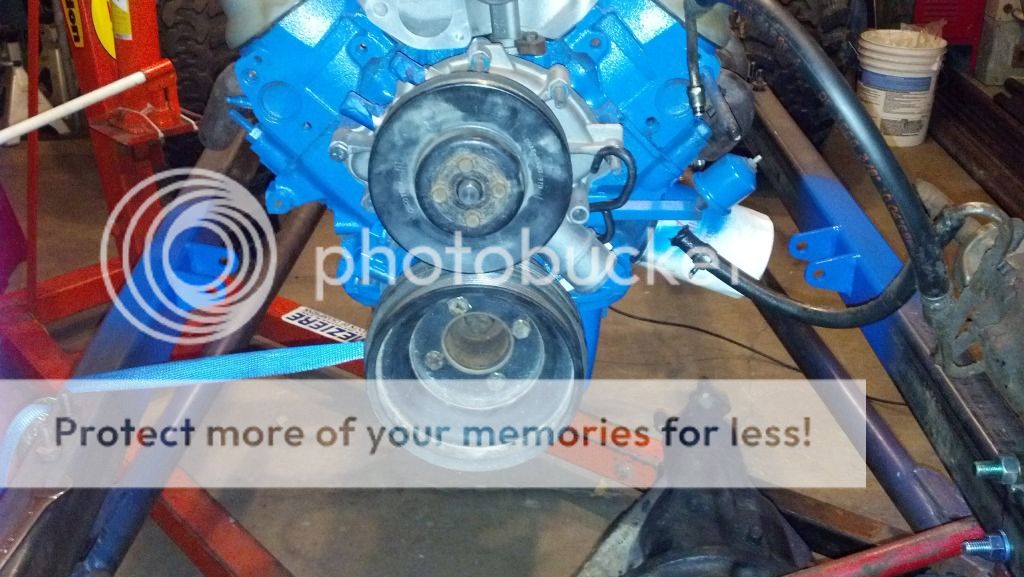

Got the engine mount cross member done. Probably not pulling the motor back out so I had to go ahead and put some paint on it.
Looks like the slave, driveshaft and exhaust are going to be close.
