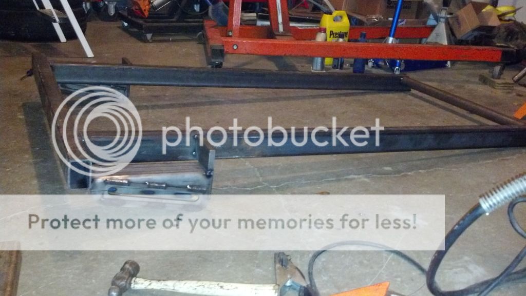

Going to build a simple leaf spring radius arm buggy with a 44 and 8.8. Copying a lot off my ranger but with a np435 205 and 5.0 with propane.
Got started tacking some pieces together.

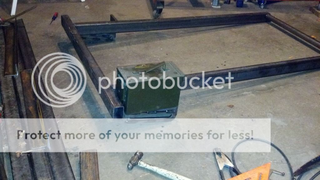

Would those be sliders for your leaf springs., instead of shackles?
yup...

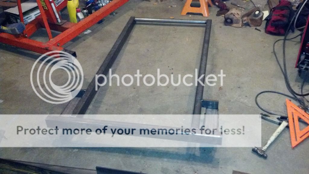

Frame is getting longer. I'm taking a guess at some of this so I hope it comes out right.
Yeah kind of taking a chance because I don't know anybody who has them. But they are from Liquid Iron Industries.http://www.liquidironindustries.com/product.php?productid=17611
I love the concept of them. The only problem I see with them on an off-road vehicle is they dont flex. With a shackle, you have 2 bushings to allow the spring to rotate instead of twisting, when the axle articulates. With the semi-rigidness of them, you are forcing the spring to twist a little more.
That being said, I still have plans to make a set for my Ex when I get around to redoing the suspension.
They better work because it's gonna be a bitch to switch to shackles after it's all done.
