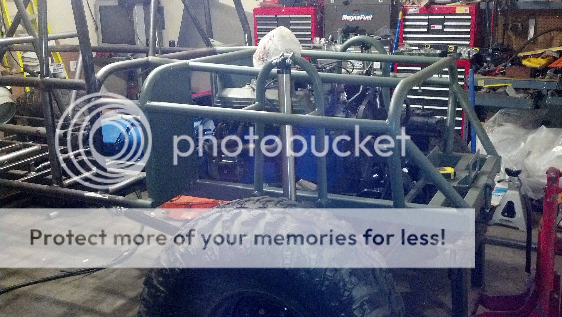

This is with 185psi(when fully extended) in the air shocks and 7 inches of up travel. Gonna leave it there for now because the weight of the winch and radiator should take it down some more. I only want 4-5 of up travel.
Are you putting the radiator up front? If so I'd consider moving it to the rear
Yeah it's going in the front. I wanted to put it in the back but putting it in the front was a whole lot easier. If it had full hydro steering I probably would of shortened the frame and put the radiator in the back.

Think I got the ride height I want now after I lower the front about 1-1/2". Also added another crossmember that should help hold everything in place.

I would think ground clearance would be an issue with SUA. It's much easier to go SOA and build a track bar with a shackle or slip style.
Yeah gonna loose a little clearance but less wheel hop and axle rap so it might be worth it.

Yeah it's about as low as a lot of stock shock mounts or lower control arm mounts.
