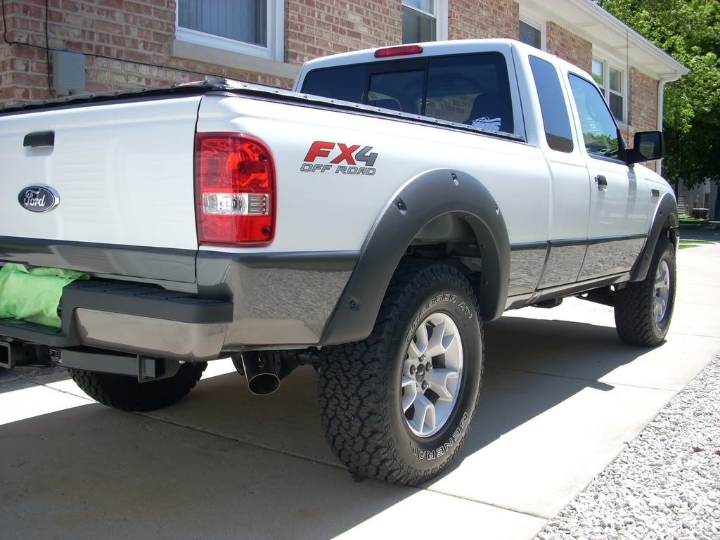

08 FX4 Updated Pics. New Tires, Torsion Keys, 2' Blocks
on my 08 fx4 i tighted the torsion keys to lift the truck 1 in for now because i want to got to a 3 in lift in a couple of months thats nice to here that the ride isn't any different. the 1 in lift levels it out some what but nice just can't wait to put the lift on, but i want longer shackles instead of blocks, same ride quality and not so bouchy if you put longer shackles not blocks.
.........I also removed the nerf/side bars, I think it gives the truck a cleaner look.

Very clean truck too i have always liked white rangers lifted.
Thanks! I've really been enjoying the truck, it's allot of fun to drive.
Aren't the 2" blocks stock?
My 00 came with 2" blocks. I cranked about 2" out of the torsion bars and ditched the blocks for extended shackles. She sits a little bit lower in the back but it definatly has a bad ass stance to it.
The ride quality is TONS better with out those damn blocks.

That link to your torsion keys is dead. So exactly how much "lift" did you get out of the front? Your truck rocks, by the way. Oxford white + two-tone paint = a firm tool.
Sorry to bump an old thread...but stock 08+ blocks are 1.5". '07 and older 2wd Edge/Sports got 2" blocks from the factory, and '07 and older 4x4's got 2.5" blocks.
