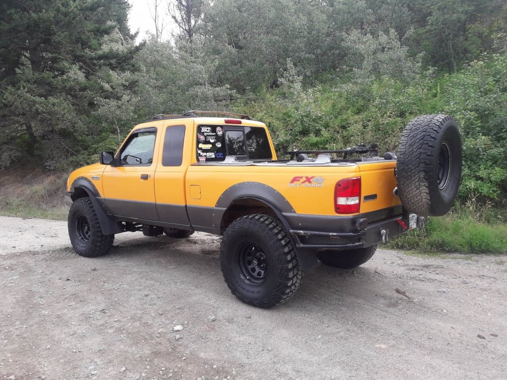

That strong box looks good. Wish I had one.
Very true. Wind makes it unpleasant.
Thanks. I'm excited to see how well it holds up.

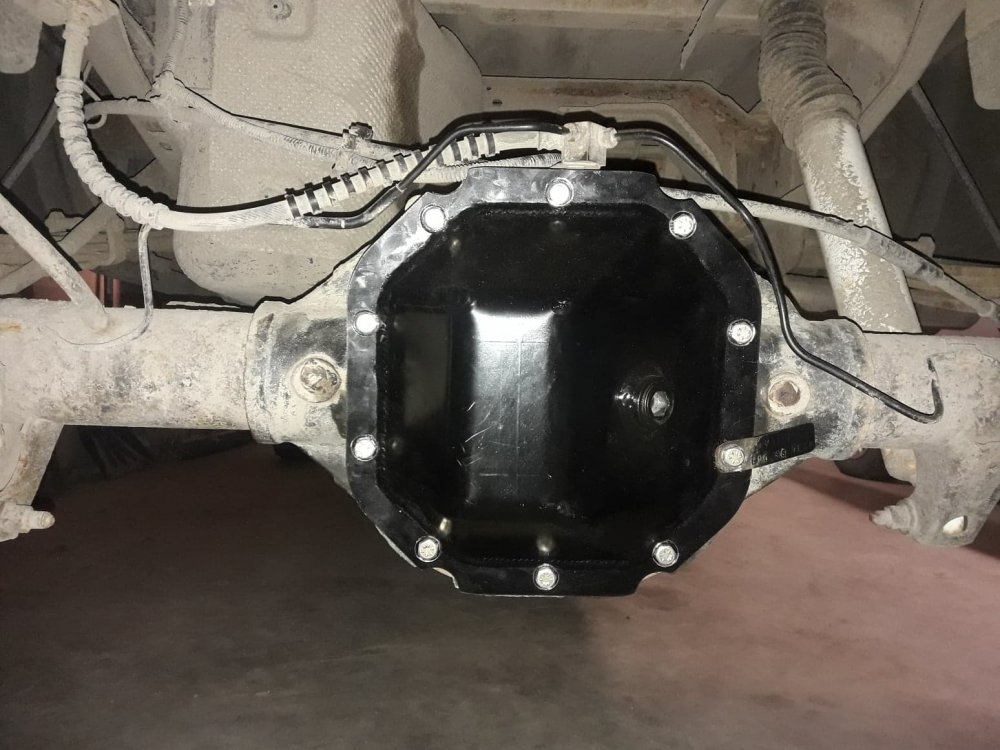

Rear end is all buttoned up. 5.13s, Mini Spool, and Ruff Stuff Diff Cover. Loving the spool so far (y)

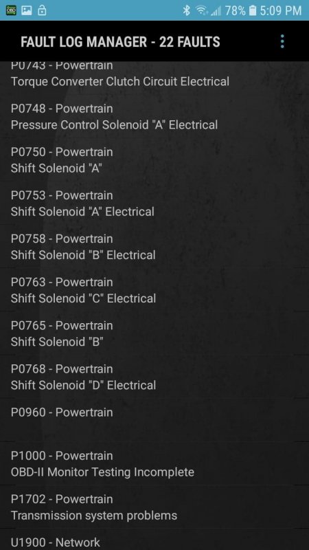

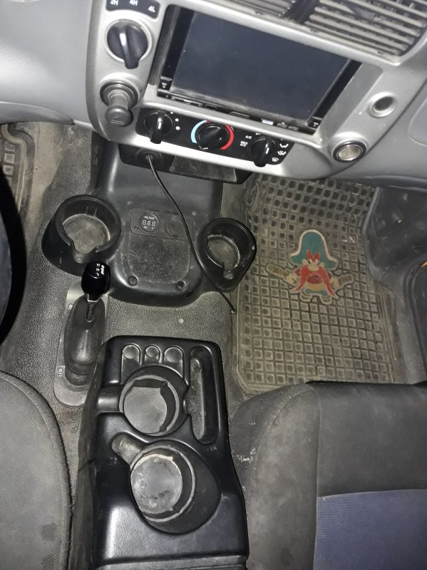

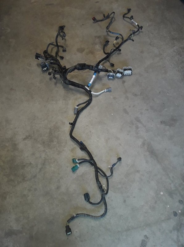

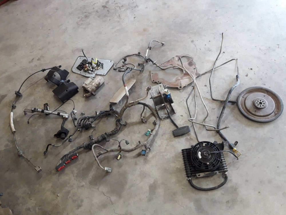

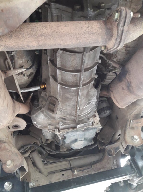

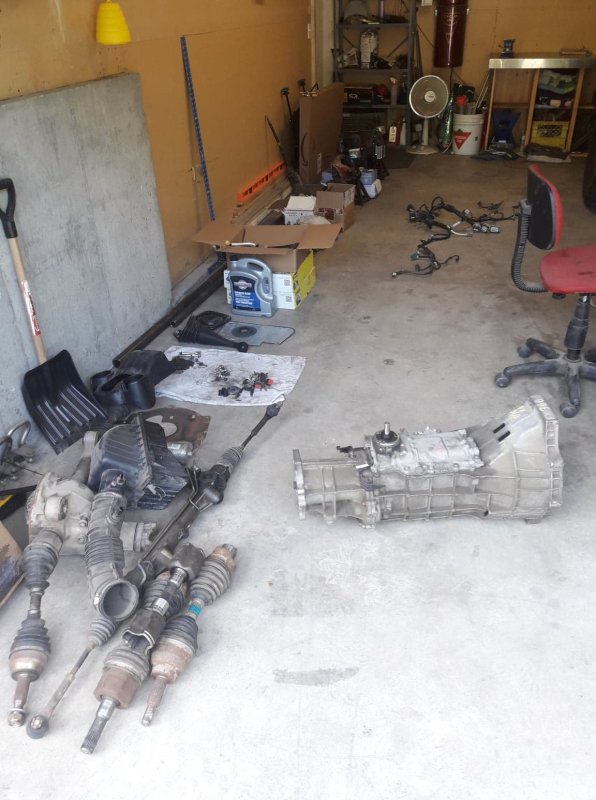

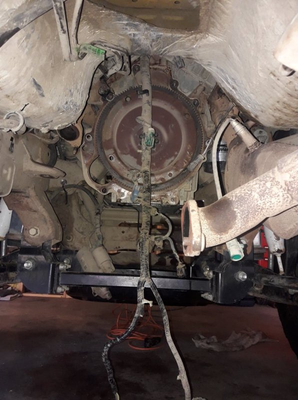

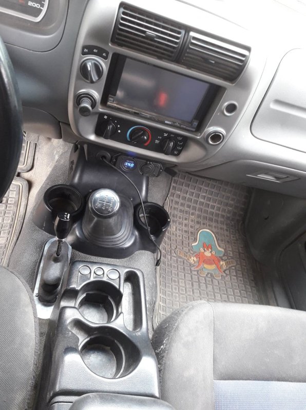

Manual trans swap is done! Well as far as I can go with it anyways. 6 days start to finish. Truck runs and drives as a manual. Just have to bring it to ford with another pcm to reprogram it. Currently has a rev limiter at 3000 rpm and the speedometer is all out of whack. Says im going waaay faster than i am, and because of that i hit the speed limiter at around 80 km/hr. Truck thinks im doing 155 lol. Its also throwing over twenty codes which was expected. Fords programming will fix all of that though. Anyways heres some pics

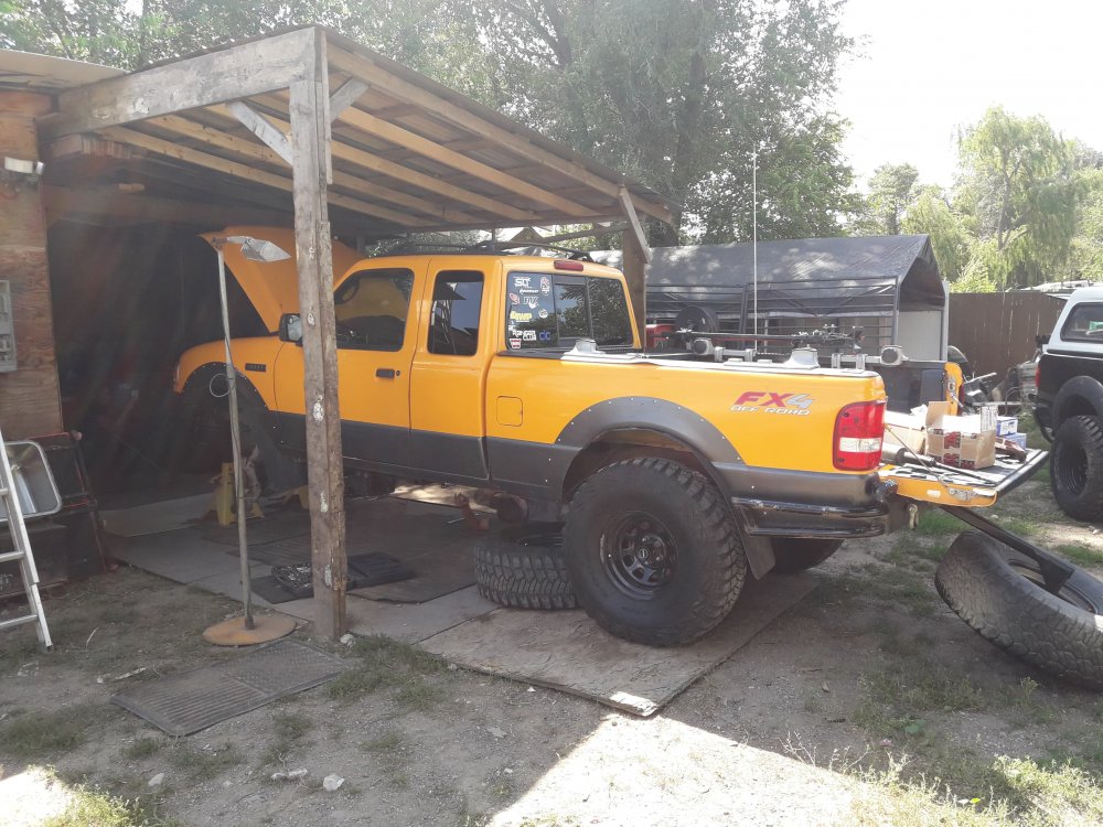

So the PCM is all programmed and truck is working great. You'd never know it was an automatic before. I took it up some easy trails to test things out. So far so good. the doubler works amazing. So must torque I almost couldn't stall it if I tried.

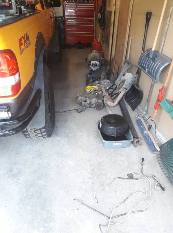

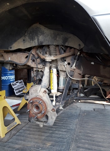

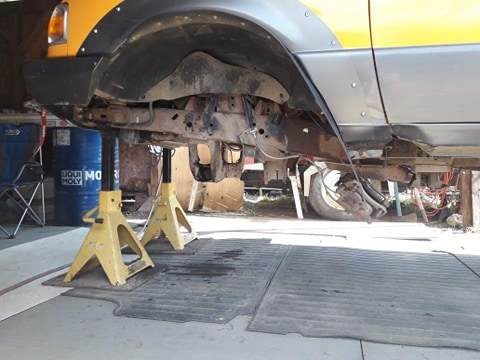

Now its on to the SAS. Got it started yesterday. Just pulled out all the IFS stuff. Now i'm just getting the Superlift prepped for sale. Next up will be cutting out crossmemebers and other frame brackets.

WOW! What an adventure!
Why did you go back to torsion bar?
Going back to torsion bars was temporary. I knew I needed to do a solid axle swap so I started selling parts to save up. The coilovers went first. Besides they never really gave me the ride quality I was looking for. I think they are over rated. My truck drove just as good on torsion bars with the superlift and skyjacker leaf springs.
