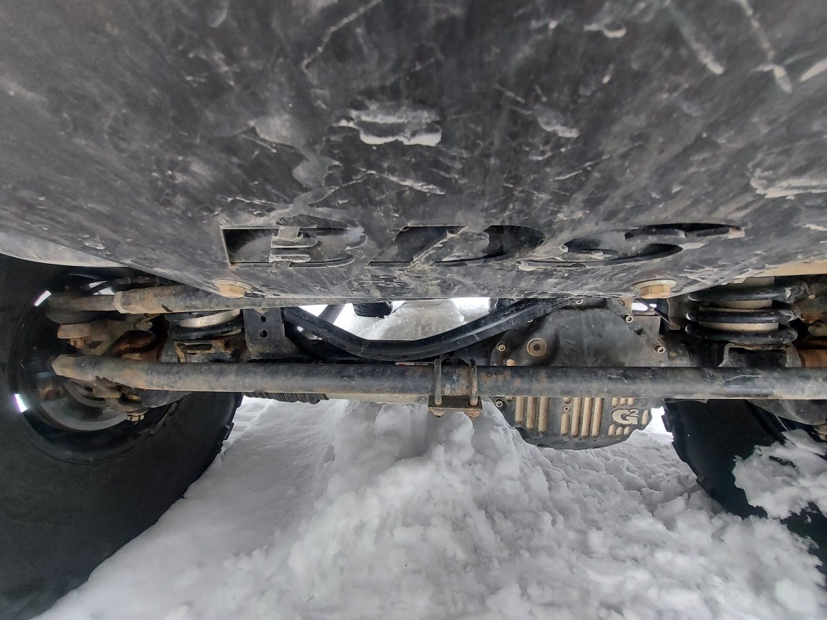

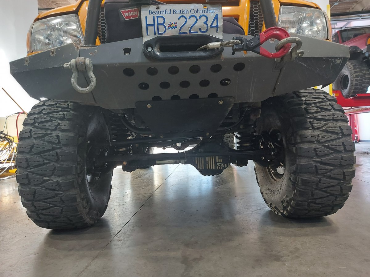

Got my front skid plate built today. Very simple. Should do the trick.

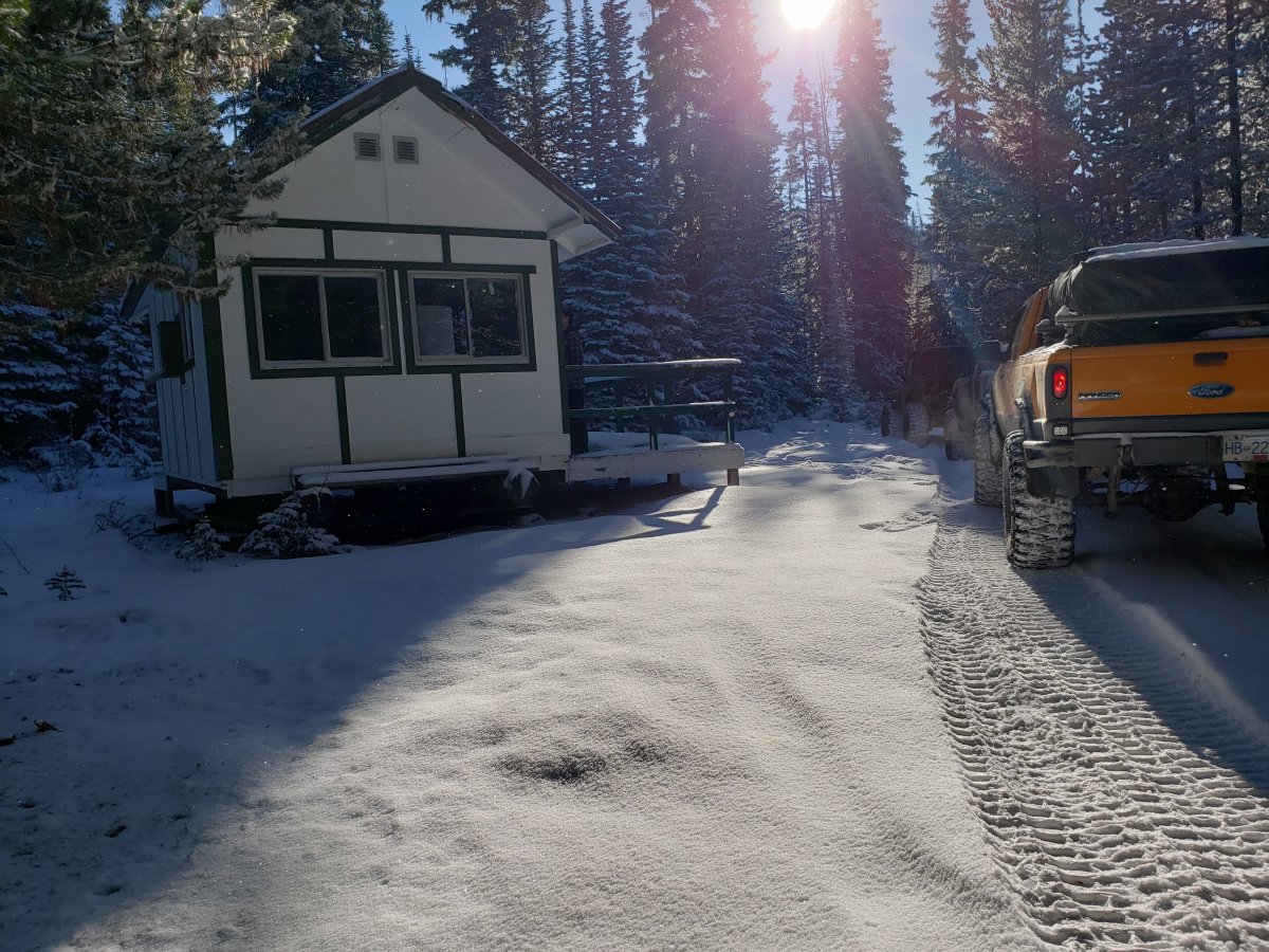

Got out to play in the snow a bit. We made it pretty far up then had to hike the rest of the way to the mountain peak. Stayed the night in a nice cabin at the bottom. Was a great time.

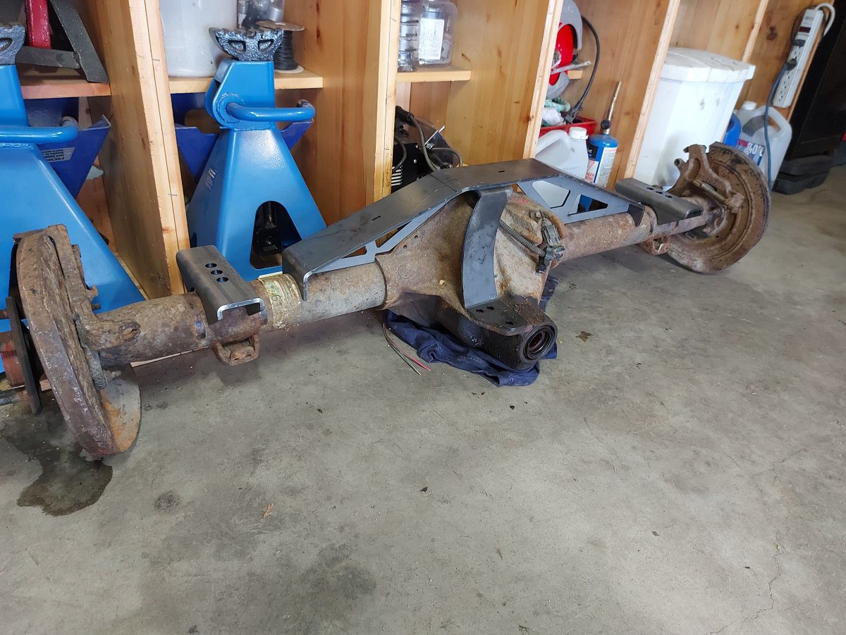

Started building an Explorer rear diff. Im not doing a full build just wanted the more available axle shafts and disc brakes. Im doing a truss, anti-wrap bar, and using stock axle shafts. Ill just swap in my spool and gears from the old axle when im ready.

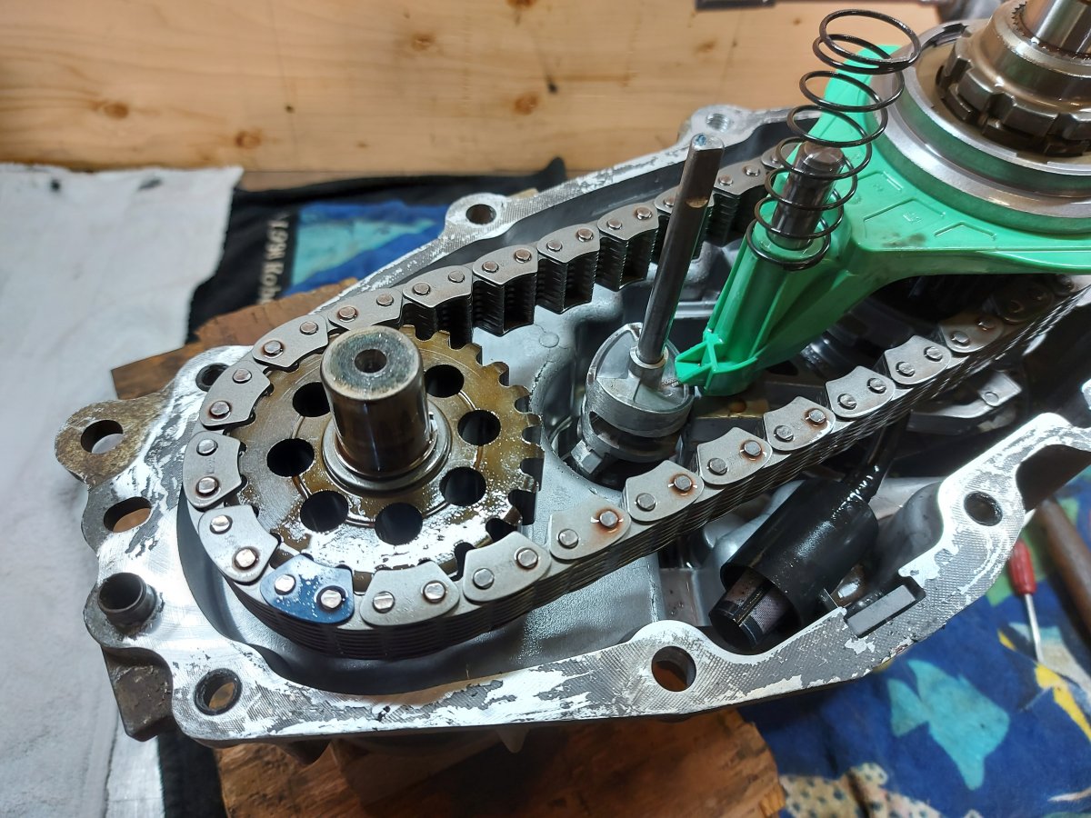

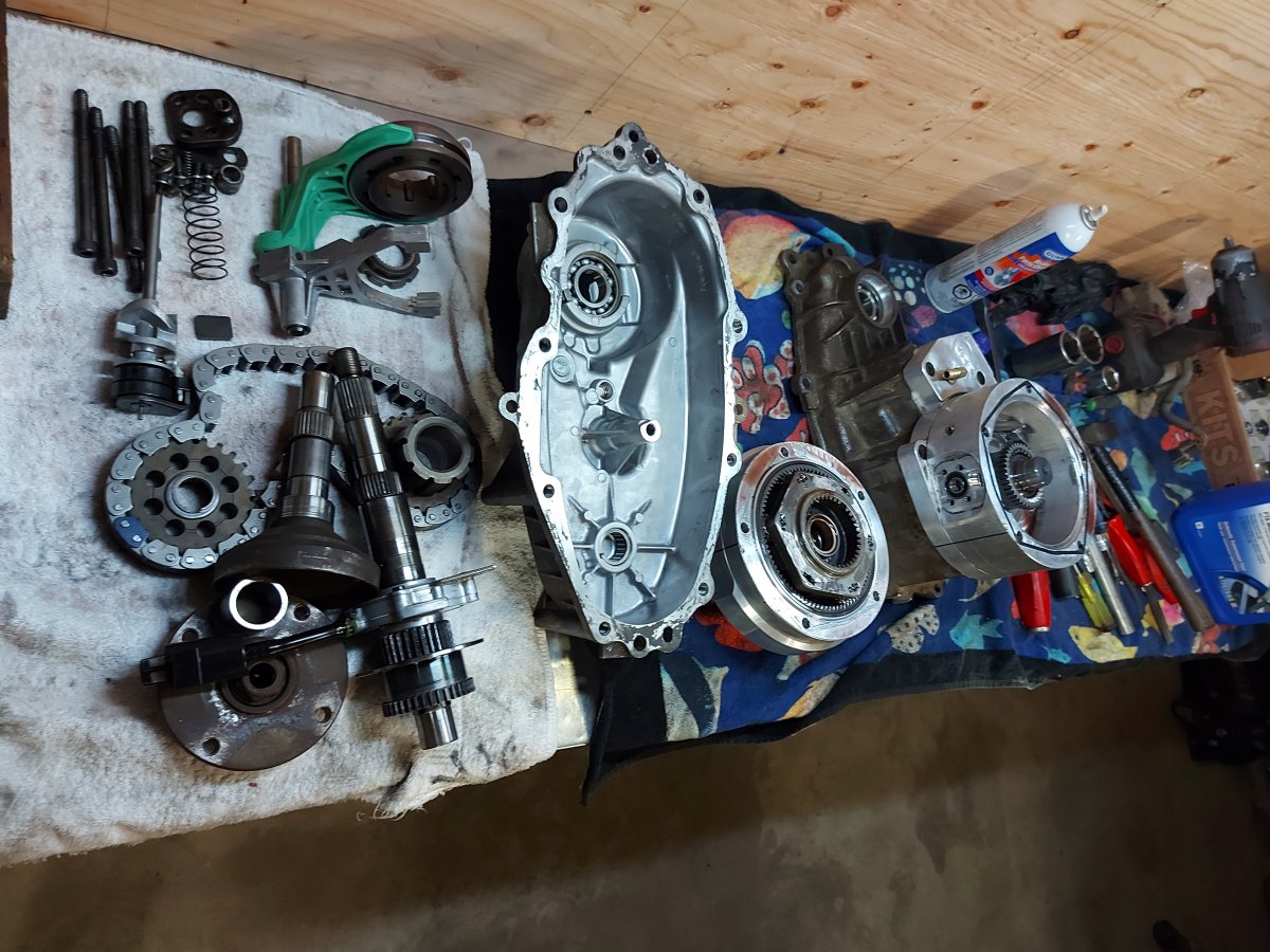

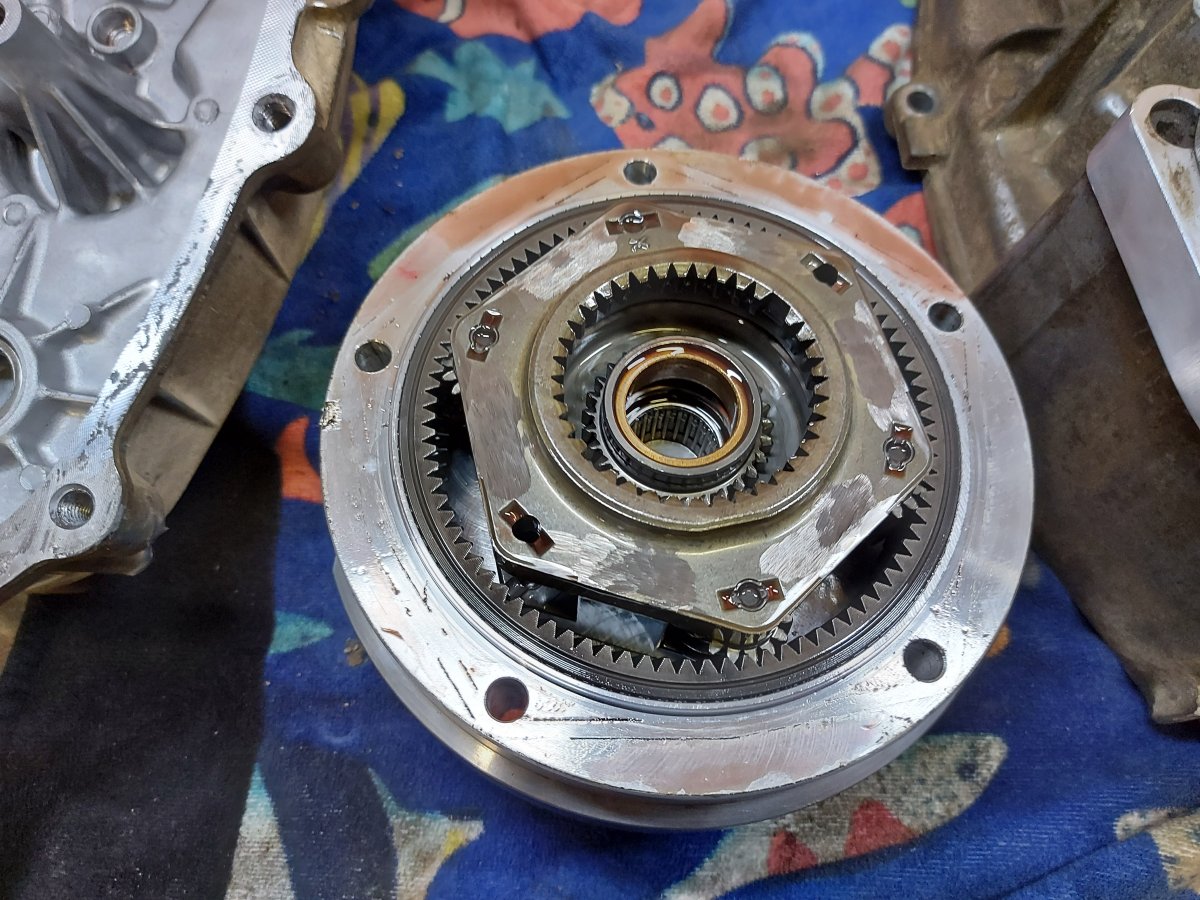

T case was leaking from a couple spots so decided it was time for a rebuild. New bearings and seals going in. Surprisingly everything looks good in there. Should have it back in very soon.

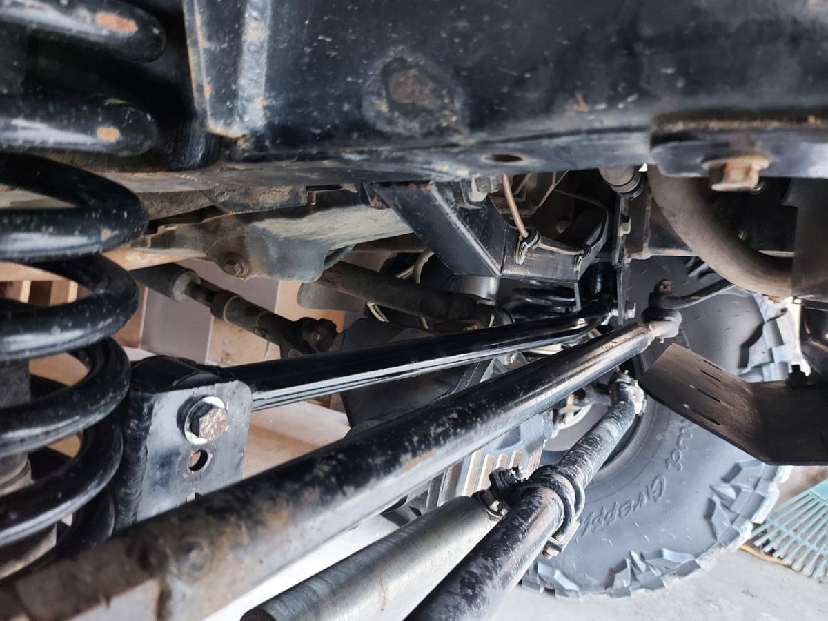

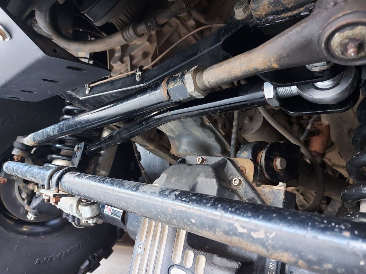

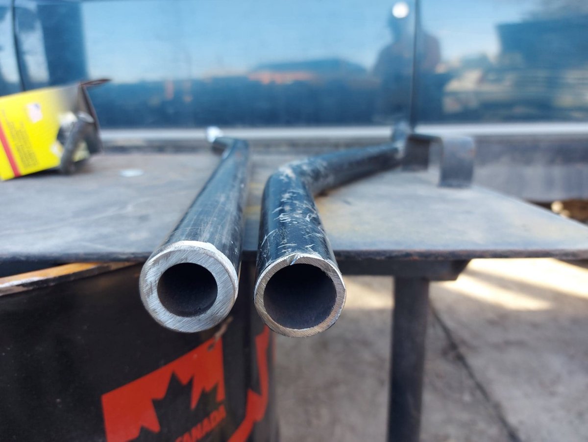

I finished my new track bar yesterday. 1.25" x .250" wall DOM tapped for a new 7/8" heim and slightly bent to clear the diff cover. Turned out pretty good.
The old one was 1.25" x .188" wall and had a 3/4" heim.
Heading out wheeling this morning. We will see how it goes.

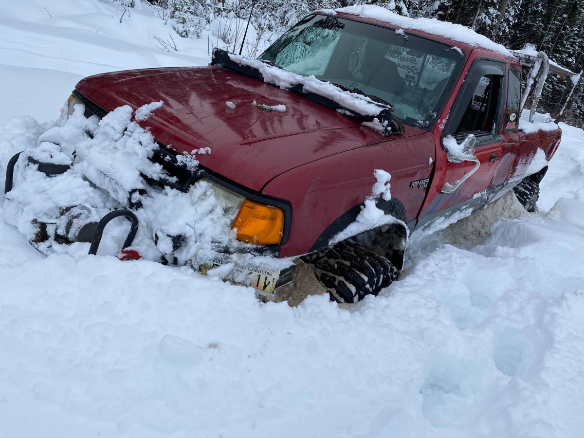

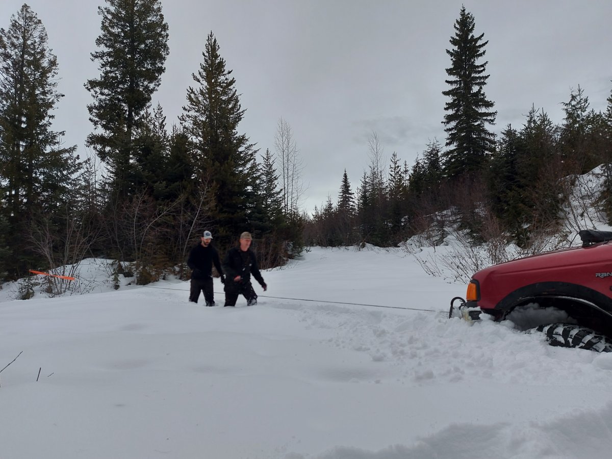

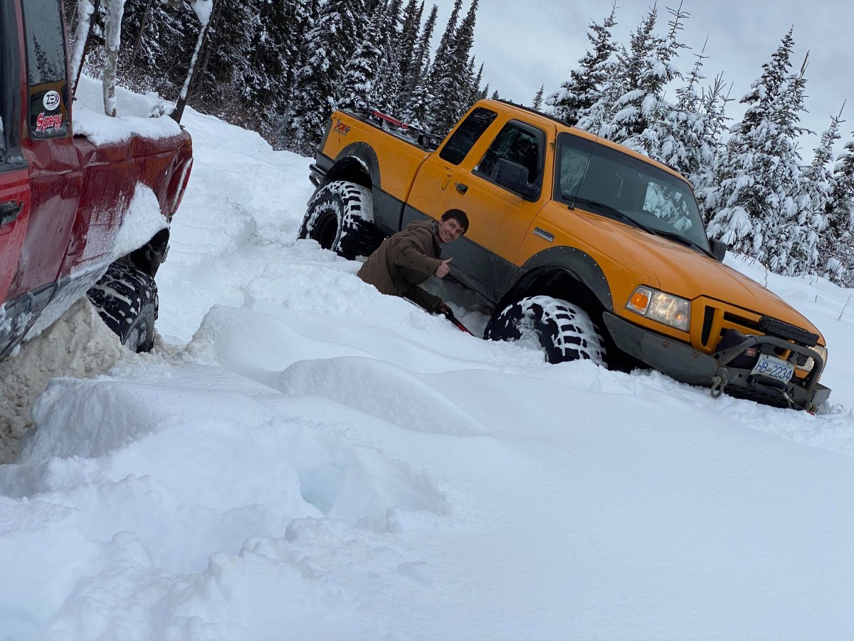

Had an eventful day out and the track bar held up nicely. We got stuck for several hours in the deep stuff. Digging and winching into the night. But it was all worth it. Truck still drove home at the end of the day so that's a plus.
Busted a valve stem off my wheel, busted my passenger side mirror (again) and blew my power steering pump or pressure line. Probably due to heat. Haven't dug into it yet. Wheel and mirror will be fixed by the end of this week but I have to figure out something else for the steering. Might have to give in and go hydro assist with a cooler.. we'll see.
