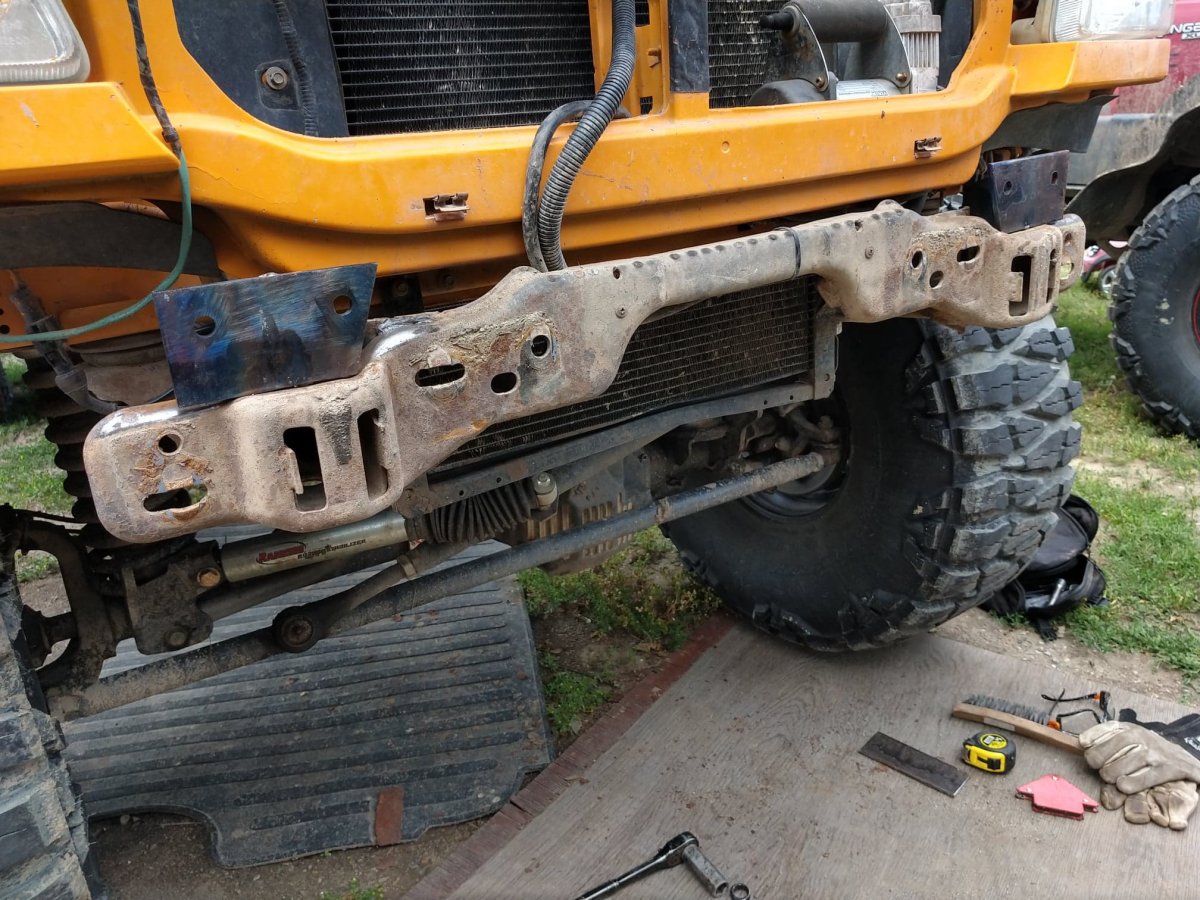

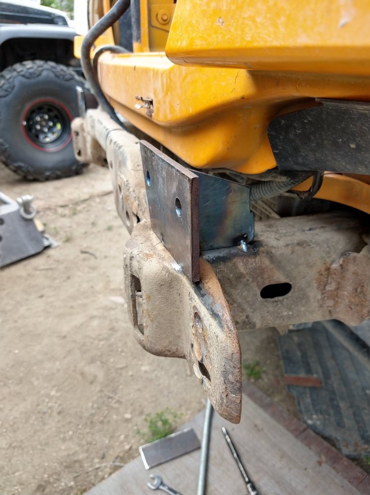

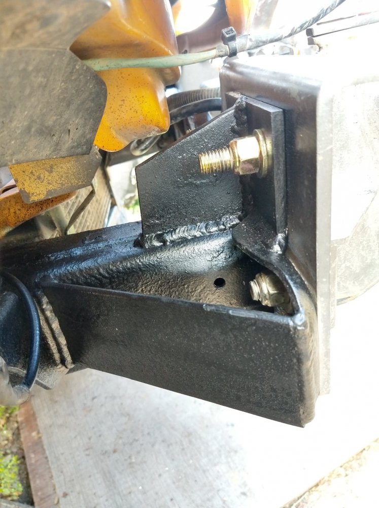

I took the wings off temporarily while I reinforce the front crossmember. I don't like how much it flexes when I'm winching. They'll be back on tomorrow.
I do like the plate wings better though. They are a bit flimsy but easier to trim for tire clearance.

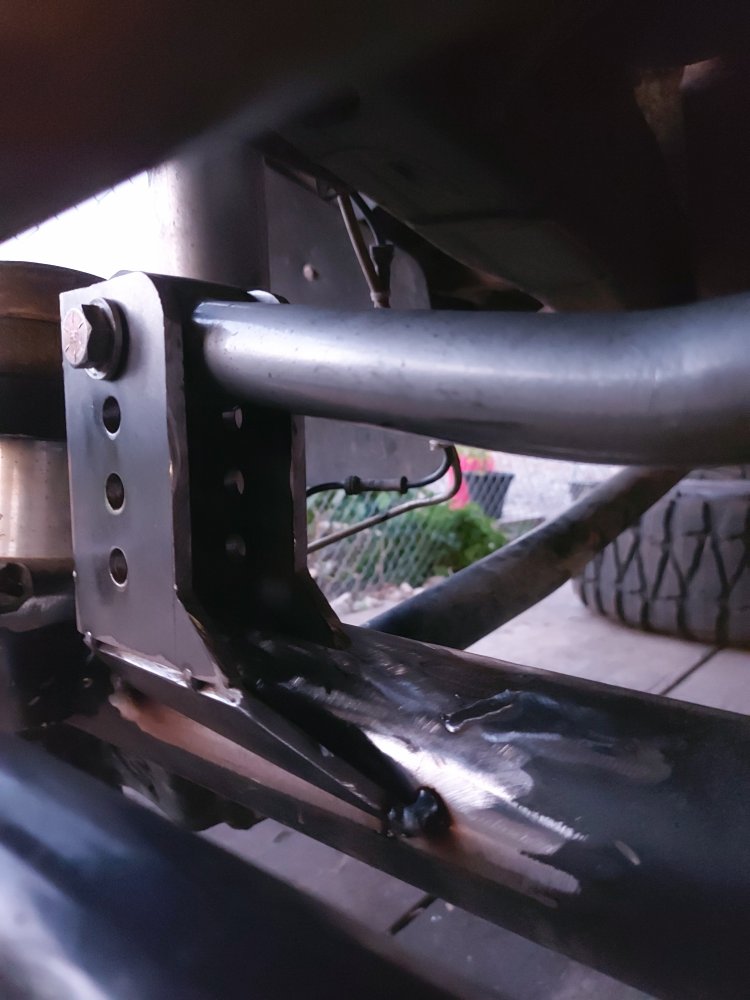

Finished beefing up the mounts for the bumper. No more watching it flex and worrying about it ripping off the frame.

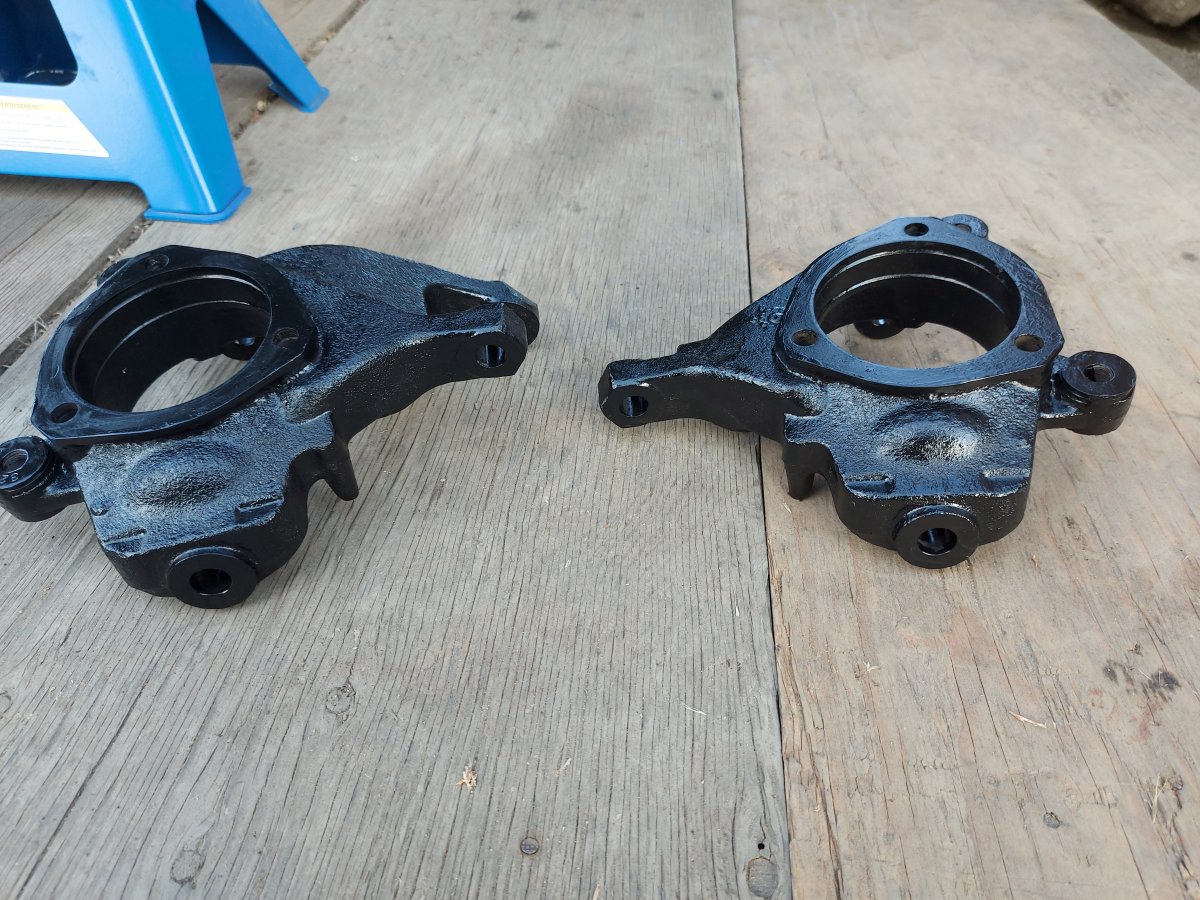

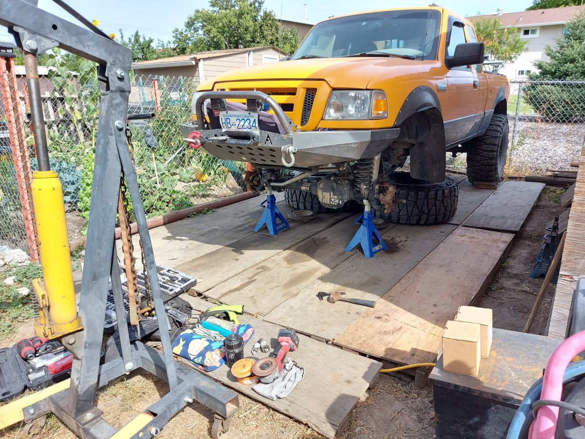

WJ Knuckle Swap is well under way. Just waiting on some tube adapters to build a new drag link and tie rod. Then need to fab new track bar mounts.

More progress with the steering. Turns out most people that do this knuckle swap switch to 17" wheels. When I started mocking things up, everything hit. The tie rod ends and calipers rubbed bad. So I had to shave the calipers a bit and get straight non-offset tie rod ends. Now of course my tie rod hits my diff cover. So I will need to put a couple small bends in it to clear.
I did get my knuckles welded and painted, cut my drag link to length and built my track bar mounts. Still waiting on my steering tube adapters to come in the mail and need some more 1/4" steel to finish the track bar mounts.
Now my drag link is basically flat at ride height. Should be way better once its on the road.

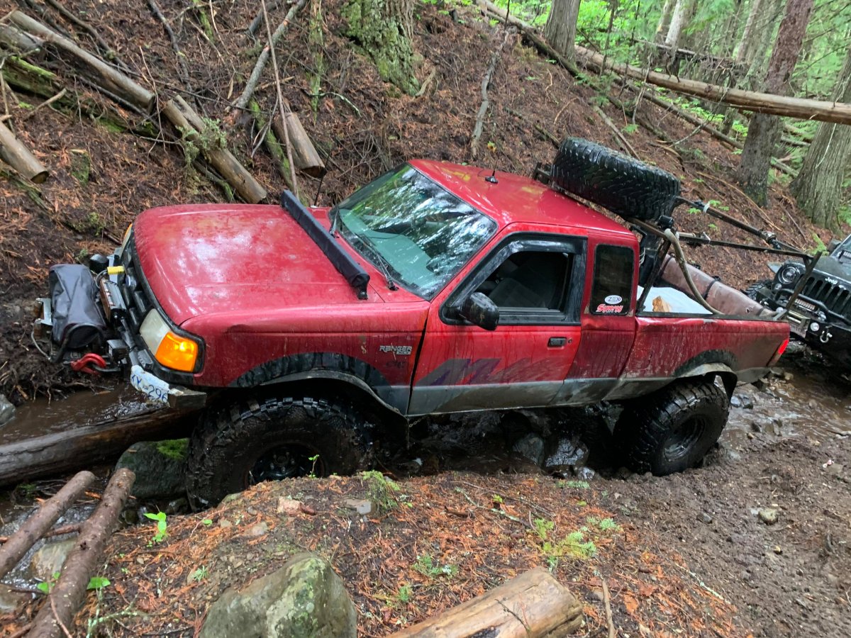

Crossover steering is all done. T-case skid plate is on. Did some wheeling. Dented both box sides and broke both my tail lights..lol
Also buddy in his Jeep broke an axle shaft. Was an eventful day.

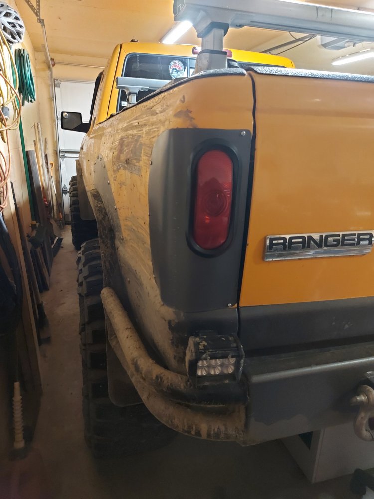

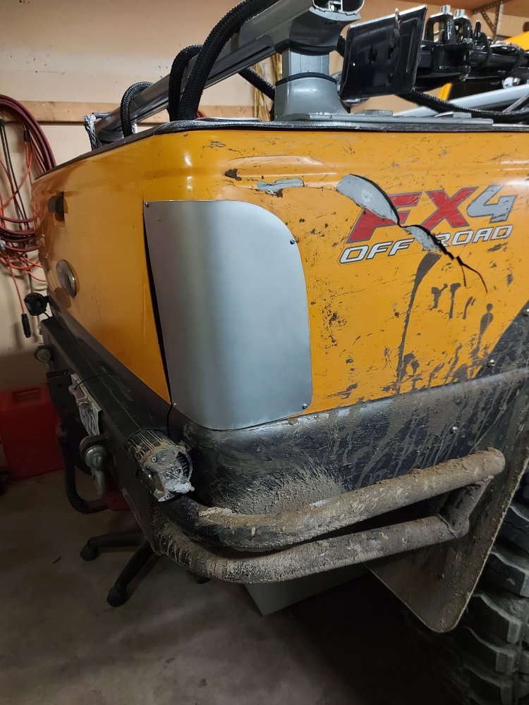

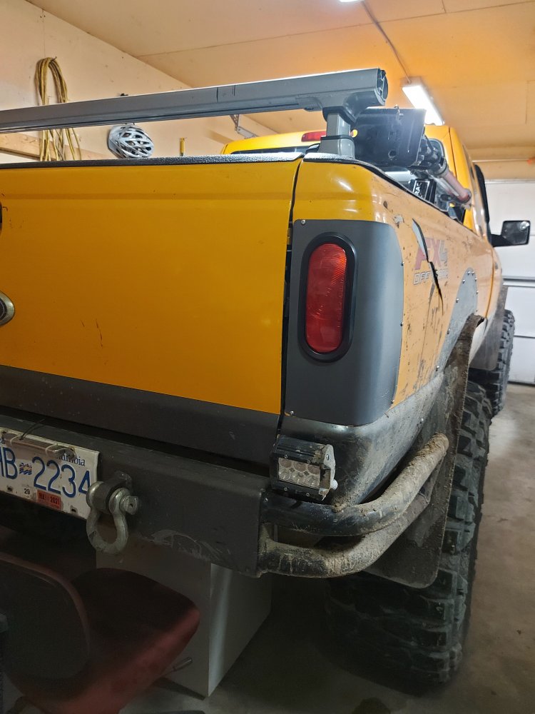

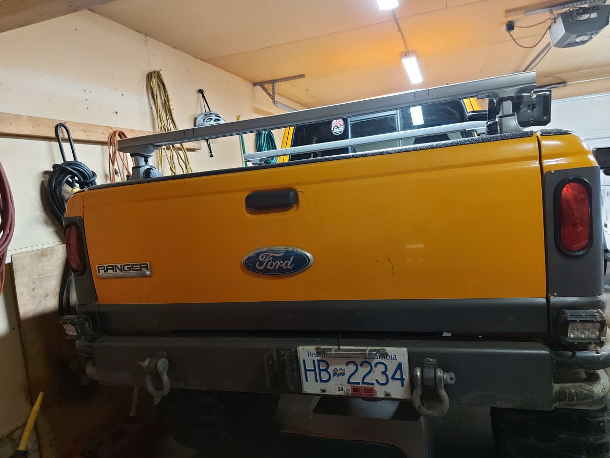

I had to get my truck legal so I whipped these up last night. Aluminum flashing from work and some trailer lights from princess auto. Should do the trick. I left room underneath for future reverse lights.

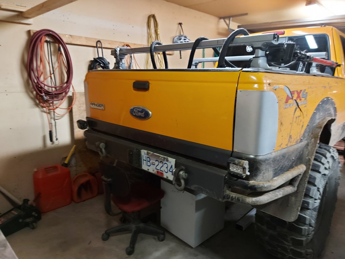

Got my reverse lights in and mounted a new light bar up front. Should be nice for the dark winter months.
I also built a front skid plate for under my rad. Should be able to get it welded this weekend. Ill post some pics when its on.
