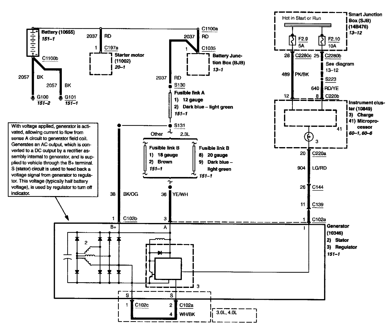

Anyone happen to know offhand what the theory of operation of the charge fault light is on the 3.0? Mine's clearly not charging but no indicator light. Wife took the truck today, complained of the dash going nuts and the radio going on and off... Checked and the battery was down to 11 volts.
Put a little charge in it and it started and ran but voltage steadily dropping. Good b+ at alternator. Mainly wondering why the computer isn't complaining, I'm thinking that must be a clue to what's going on.
There are some fuses and fusible links in the charging system. Here's the diagram for a 2005.
'05 3.0 not charging but no charge light?
Thanks, that'll be super helpful!
