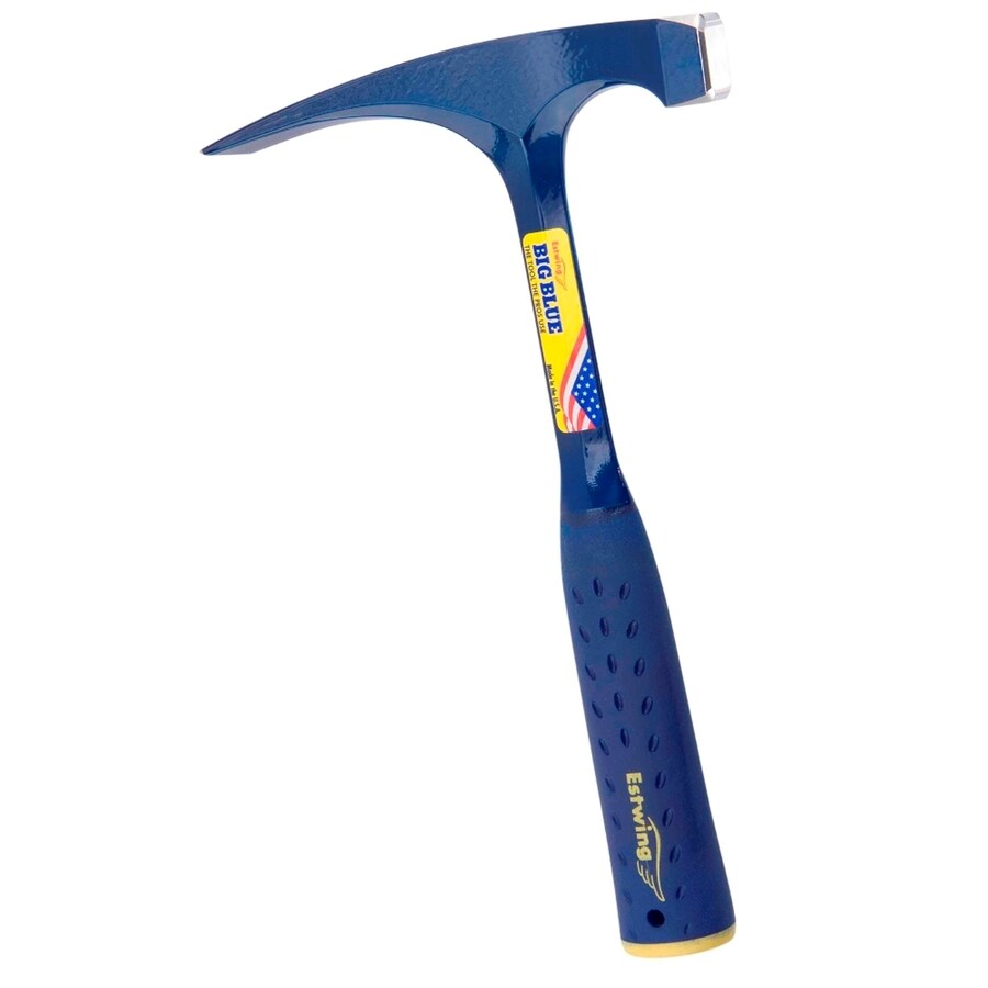

02 ford ranger 4.0l exhaust manifold removal
its faster....:dunno:
:icon_thumby: wear protection.
