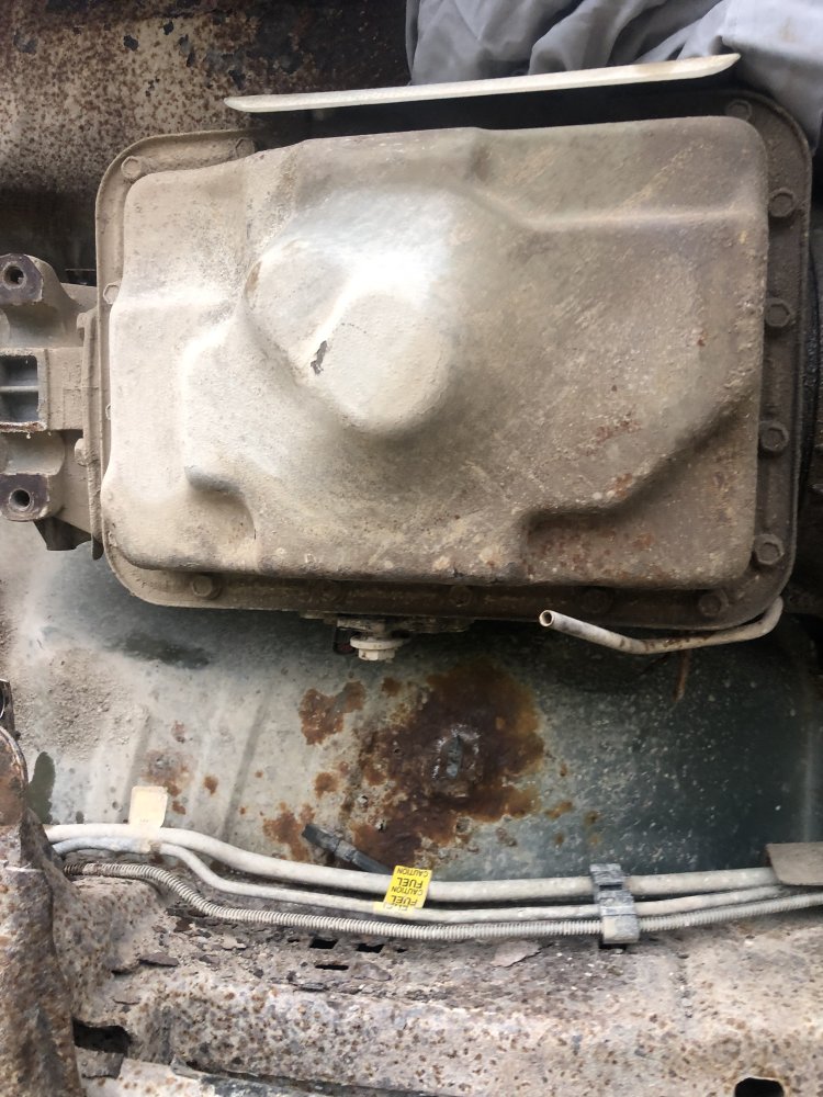

Well I started pulling the transmission out of the donor Ranger. And upon further review it looks like it’s a 4R55E 18 bolts on the pan, instead of the 16 on the 5R55 on which I need to go into
my 04’ 🙁

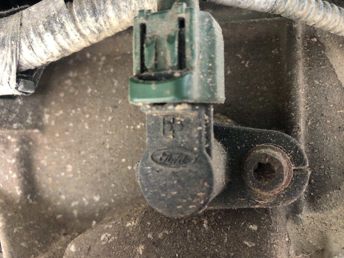

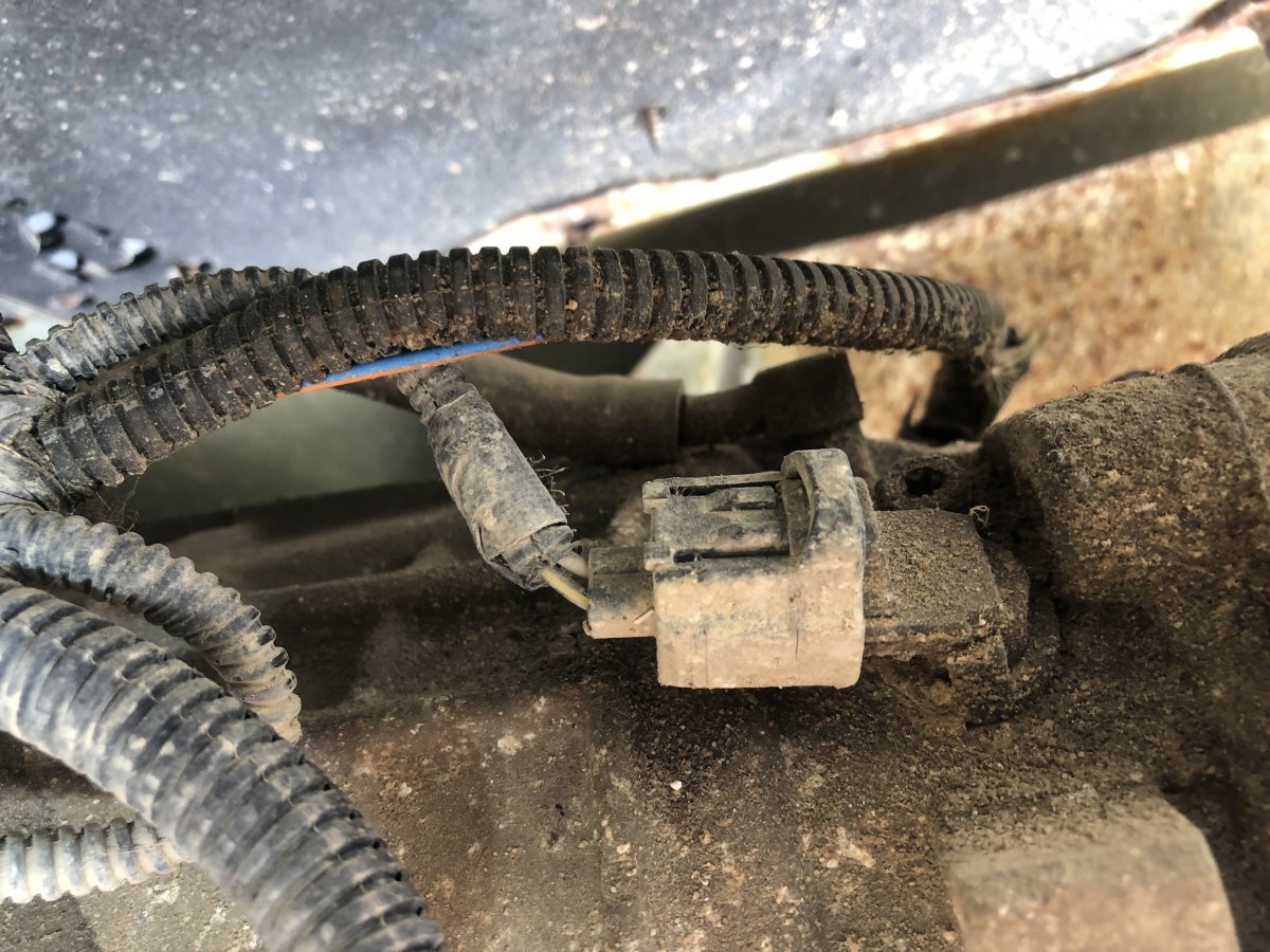

Okay I took some pictures of it still in the truck. From what I see and location. I pretty sure these are the sensors your talking about?
So it should work then?
Thanks for your help 😊

Yes, that's a 2001 or newer automatic
