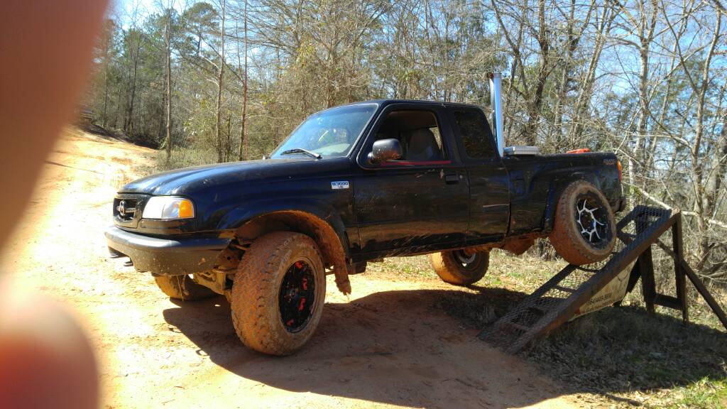

Hey Everyone, I've been the happy owner of a 2001 Mazda B3000 Dual Sport extended cab(edge model) named Rex. About a year ago I converted Rex over to 4wd with manual t-case and locking hubs. After going wheeling a several times it plain as day that IFS sucks! So I started planning a few months ago and so far Rex has a 14Bolt rear with disc brakes, Chevy 64" rear springs and am in the middle of rebuild a 06 F250 D60 and will add 6 inches of lift and go to 35s. I am planning to swap over a Chevy small block in the future either a 5.3 or 6.0 but the point is I would like to be able to use this rig to tow other rigs eventually and here are my unanswered questions:

Thats a sharp looking truck you've got there. Decent flex in back for what it is too.
