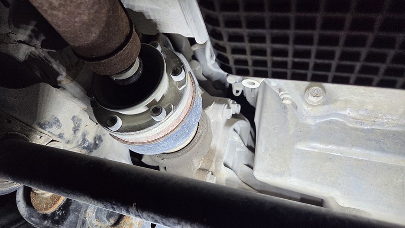

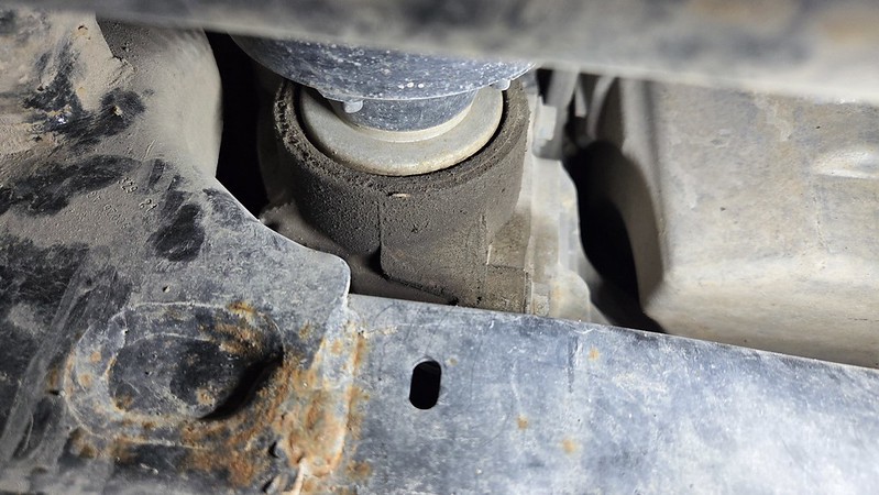

This is what my local dealer rates as a 2/5 pinion seal leak:

Asked my brother about it, he got out before Broncos and Rangers started having issues and had never done one.
Asked my BIL who still works at a dealer, he asked around and they do it like a normal pinion seal where you mark the nut. He offered to help some Saturday with a lift... which would be really nice.
