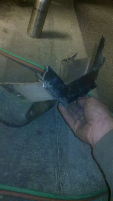

I had cut and reinforced the K Member earlier as you can see in this picture but I only had about 2 inches of up travel when both tires would stuff (speed bumps or high speed whoops, not that Im racing)

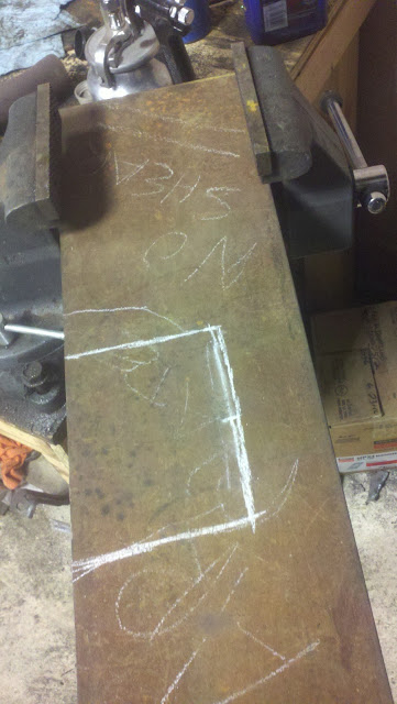

I remember reading a build thread where a guy cut his cross member and welded a .5" plate underneath... .5" is a little overboard so I was going to go with 5/16th but the metal place didnt have any but they did have 1/4" AR plate (Abrasion Resistant.) Its basically heat treated, I dont know if it was AR500 or less but non the less it worked great:
Chopped:
AR plate (labeled "NO SHEAR" because they would break their die if they did so) The lines are for clearancing the oil pan:

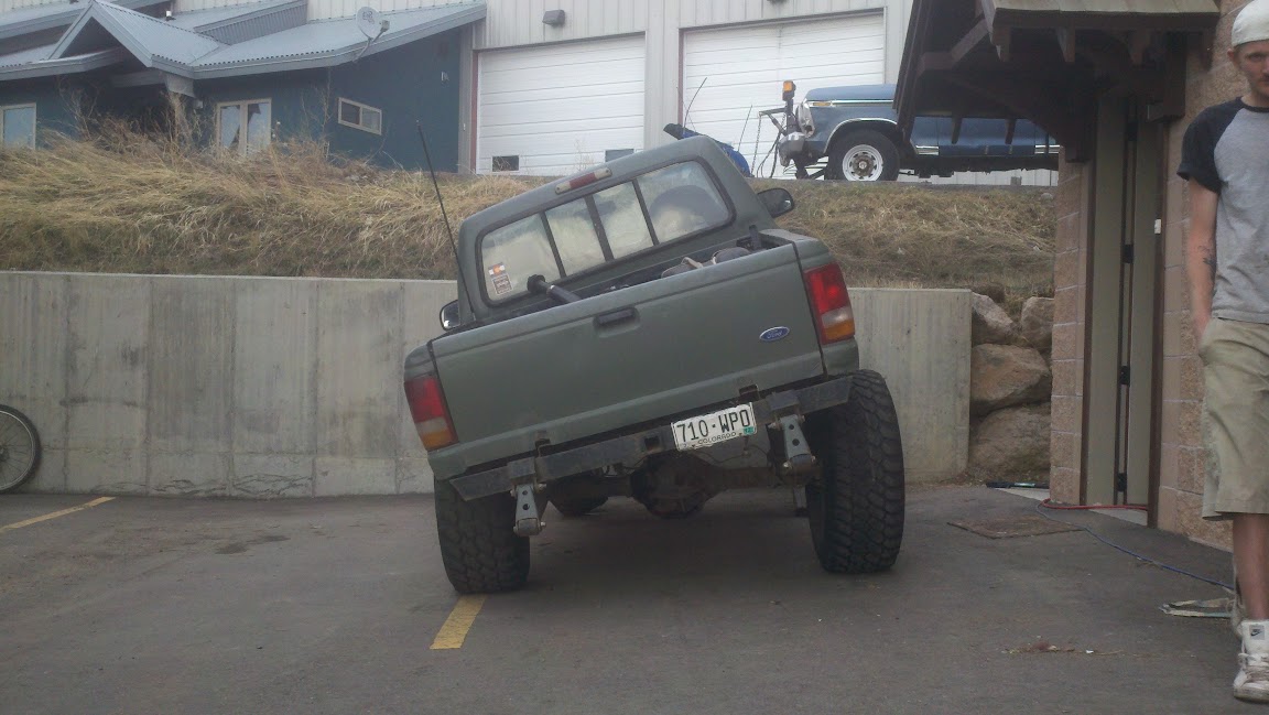

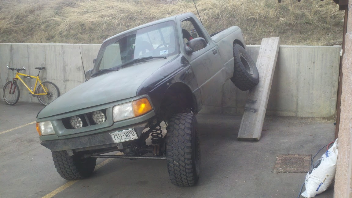

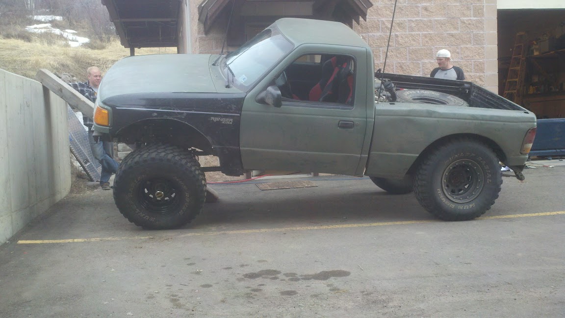

After that I made sure everything was tight and fully welded and I took it out to the RTI ramp:
Chopped:
