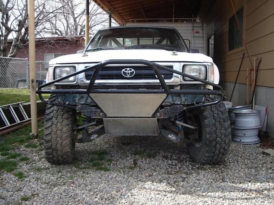

Tonight I made a new tranny cross member and this is what my control arms will be going back to also. I started off with some 5/16ths plate, cut it to my frame width about 3ft, the plate is 12" wide. I then cut up my original tranny member:
The cut center section was too short so I raised it with some angle iron:
I welded the whole thing but my pic must not have saved on my phone, here is a whole plate shot:
I then cut some holes in the back of the plate for tranny bolt access:
Drilled four 1/2" holes in the new crossmember/skid and also through the frame, bolted it up and now I have a true flat belly skid! I have about 20" of clearance under the truck as of now:
My rear drive shaft flange (transfer case side) is pretty close to the cab crossmember now, Ive got about 3/4". The truck also makes a bit more noise in the cab from everything being closer to the cab.
I plan on cutting the plate like this, or something like it to clearance the front drive shaft:
Thats all for now!
