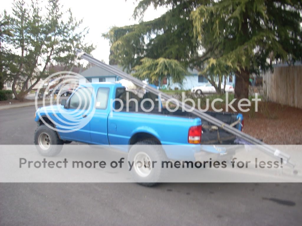

I had a few feet of 1.75 DOM laying around so I bent up the start of my bumper:
But I ran out so I went to the metal shop in town and found out he has 5, 18' sticks of 1.75 DOM so I bought one and also some 2.5" pipe to make coil posts out of. Who needs a long bed?:
