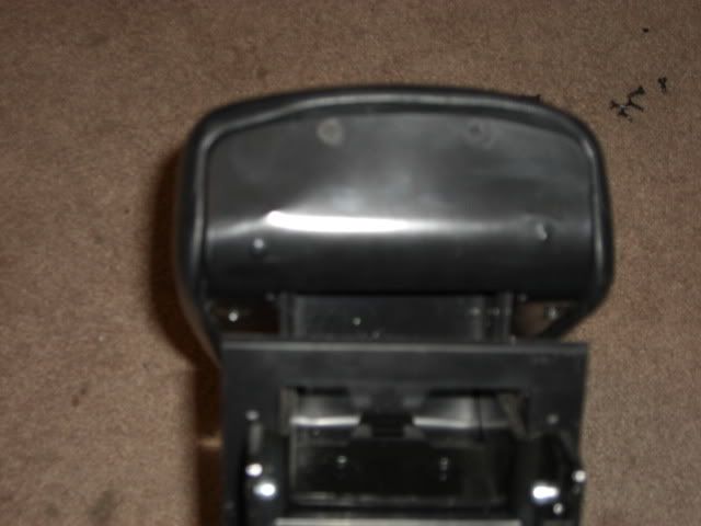

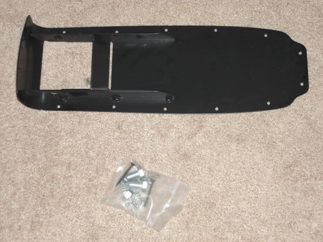

Well I think the armrest in my truck has been broken since about a month after I rolled it off the lot, and has been an annoyance ever since. About a week ago I found out about an after market replacement for the plastic piece that breaks, Rockauto has them for $40 part# arm100.
Armrest repair!!
Broken armrest
Armrest repair!!
Bolts to remove armrest (two on each side)

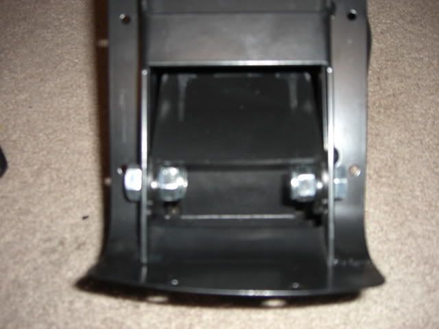

Mounting bracket and pin, Pin gets pushed out and replaced with Provided bolts.
Armrest repair!!
  • Armrest repair!!
Armrest repair!!
Screw top back on with new screws.
Armrest repair!!
Drill and install two new screws in back.
Armrest repair!!
Reinstall and Enjoy!!!!
Armrest repair!!
This took me about 45min in the driveway ,and house(cold outside 10* and snow) And only had a 6 in1 screwdriver 2 leathermans and my drill.
