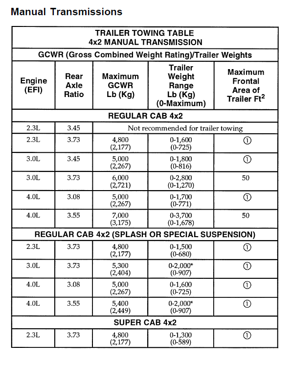

Off the top of your head does anyone know the towing capacity of a 91 ranger with the 2.3 and 5 spd driveline combo? Not sure of gearing in the rear diff but its a base model no frill truck. Im talking no accessories but and alternator... Thanks for reading and any help
This should give you a ball park idea once you figure out what gearing you have. From the 1996 Ford Ranger Manual:
four100d - Thanks. That was what I was talking about. The OP asked towing capacity. To me that means what is Ford stating. While I do run overloaded (according to the GVWR) I realize that it is capable of greater weights. I would never suggest anyone go over the given ratings IF they are not familiar with towing/hauling or with their truck. I know that my little Ranger scales at 3200#. Off the top of my head I don't know what the GVWR is. Even the biggest Rangers are only rated at 3700# towing, and my "big" Ranger is scaling at 4200#.

Per Ford my truck is rated to tow 5560lbs with weight distribution hitch. Not to exceed 600lbs tongue weight. GCWR is 9500lbs. Maximum frontal area of the trailer recommended to be under 50 sqare feet.
