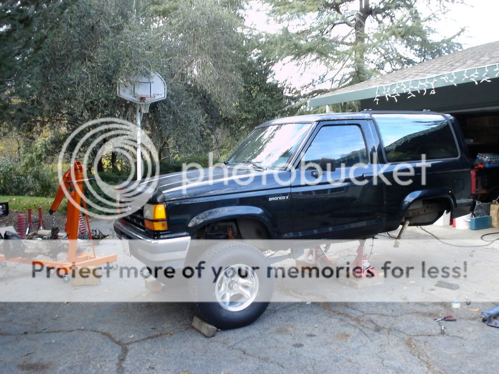

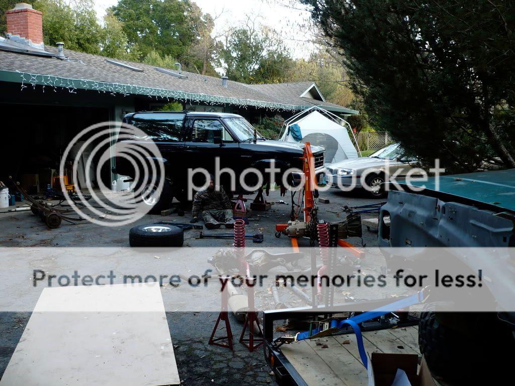

As soon as I got it home I started tearing out the suspension and axles in favor of a Skyjacker 6" lift and a d35/8.8 combo from my parts B2

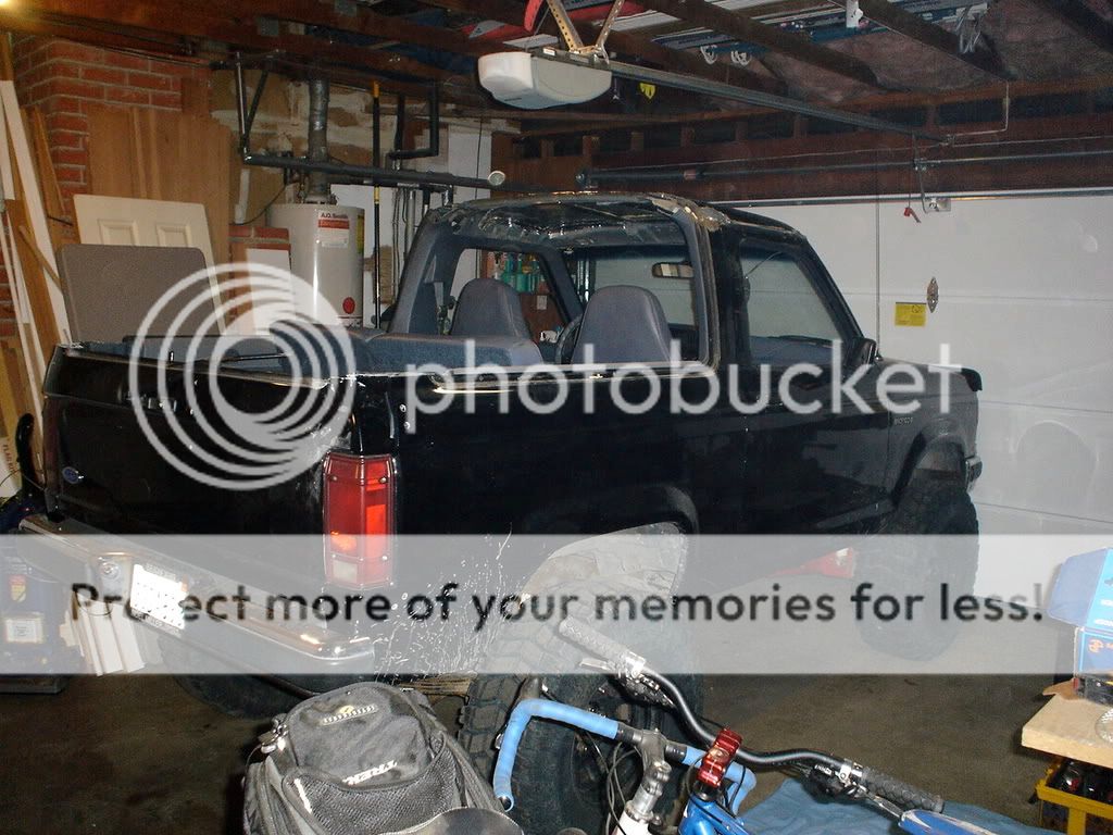

As soon as I got the suspension and axles in, I chopped the top off!
It looks like a B2 blew up in your driveway...:icon_cheers:

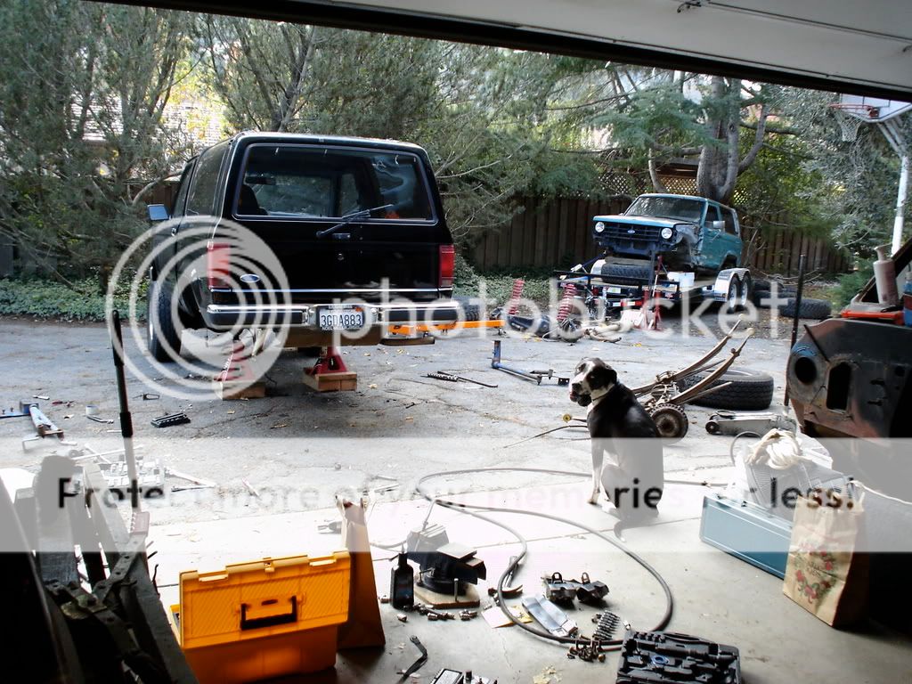

Thats what my parents said when they got back from vacation and saw the carnage! Thats my mom's volvo in the pic, just after they got home.

I like the dog in the one pic, kind of looks like (s)he is thinking "put that damn camera down and throw the ball already!!"

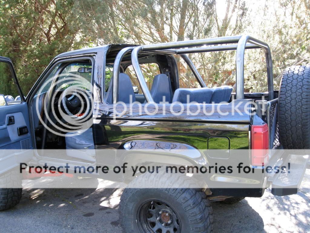

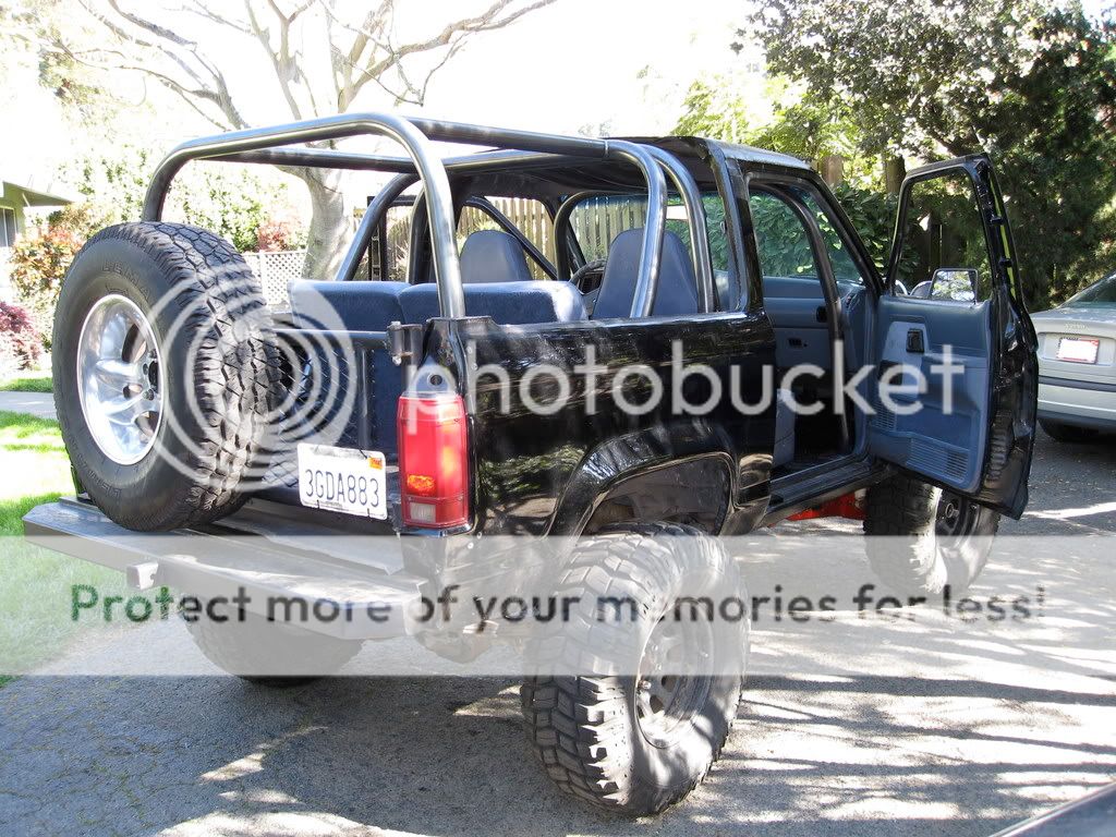

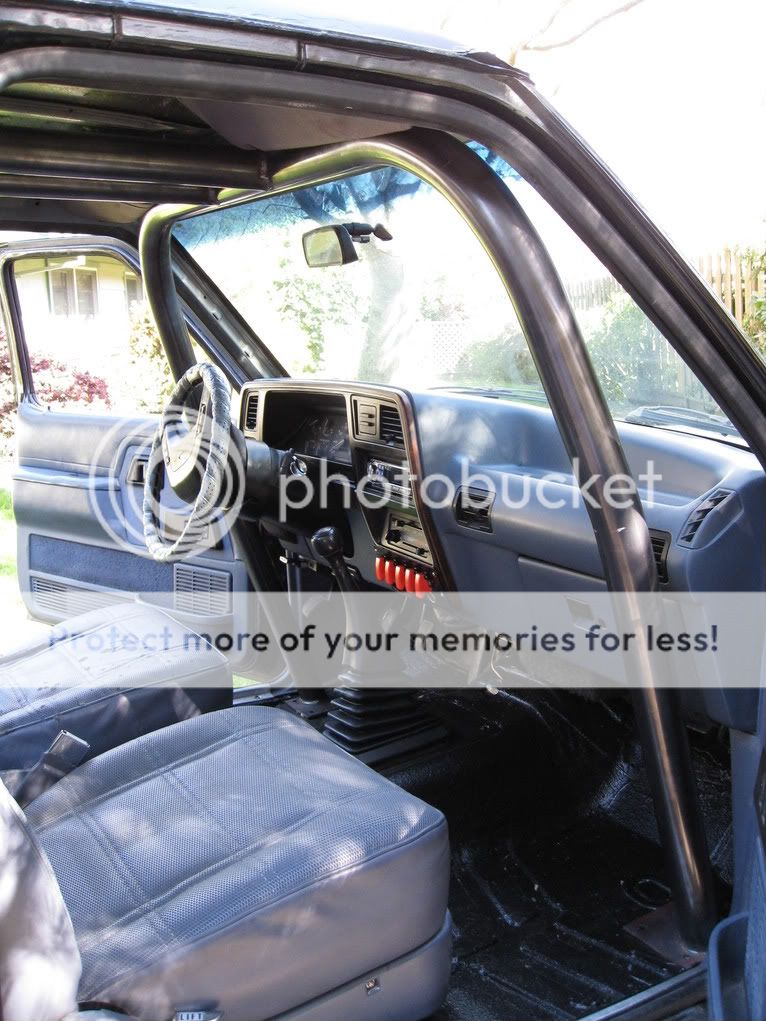

Ok so I finished most of the sheetmetal patching and filled in and reinforced the b pillars where I cut the roof. I also cut off the flanges where the windows were bolted on and welded up seams. Let me know what you guys think!
Next I plan on welding on bed corners from a ranger, and a home built swing-out spare tire rack/tailgate. Once that is on I am going to cage it. Then it should be ready for Hollister Hills! Please let me know what you guys think, ideas and input are always appreciated!
