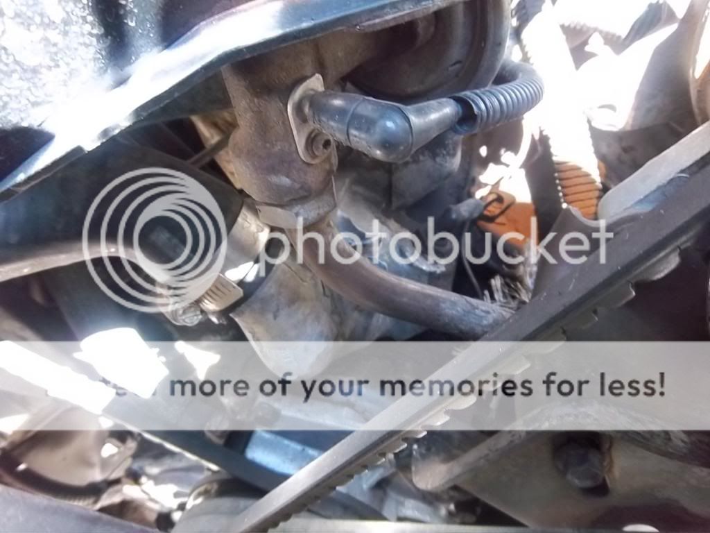

For engines with EGR and a/c it's tight where we are going to work:
I will be removing that too, but that is another story.

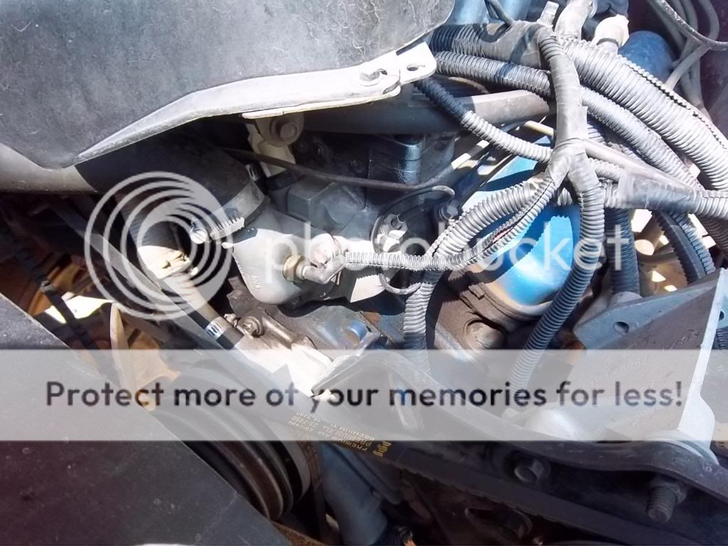

Without either one, there's plenty of room to work:

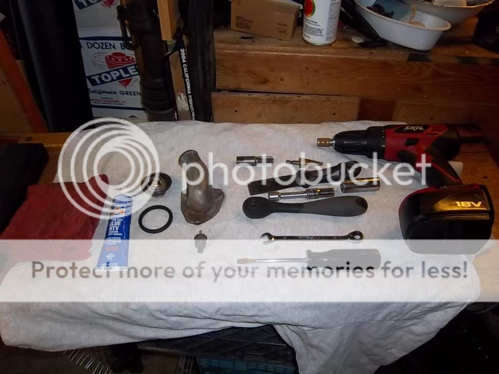

Things that you need to do this job:

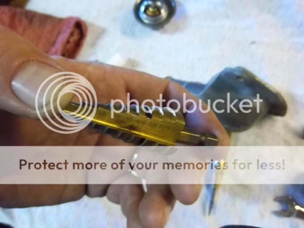

The sending unit has a metric thread. The closest that my thread gauges would come is 1.5. I don't have that tap and I don't have one that matches up, so I measured the outside thread on the sender and got somewhere around 19/32.

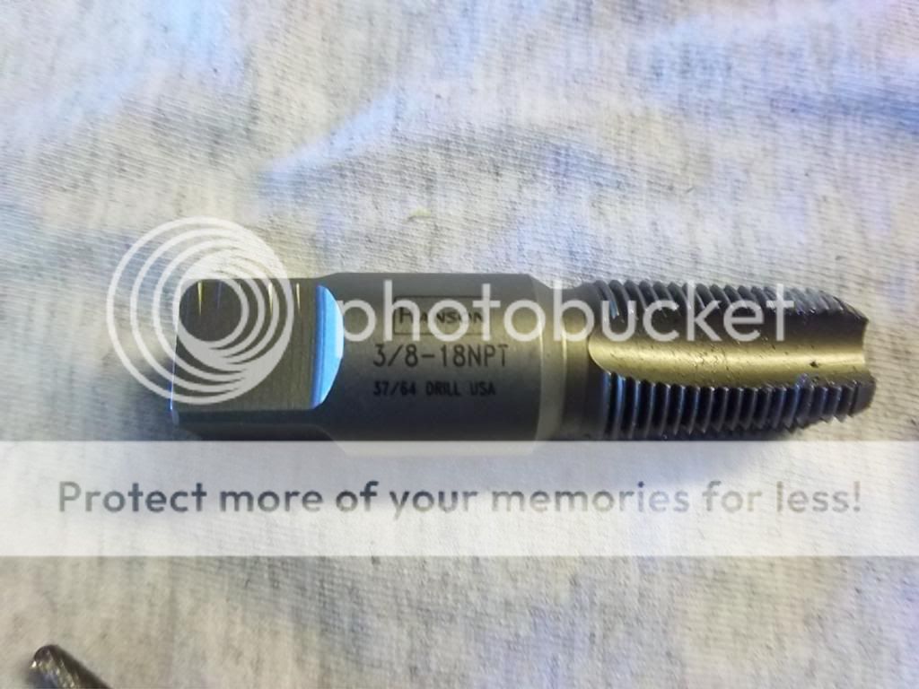

The closest tool I found was this NPT tap:
It is not the exact thread but is close, I have made it work twice now.
Dual temp guage.
It wants a 37/64 drill, ok, so who has that? Simple math to not be too big, round down to 36/64, lowest common denominator goes to 9/16, that I can do.

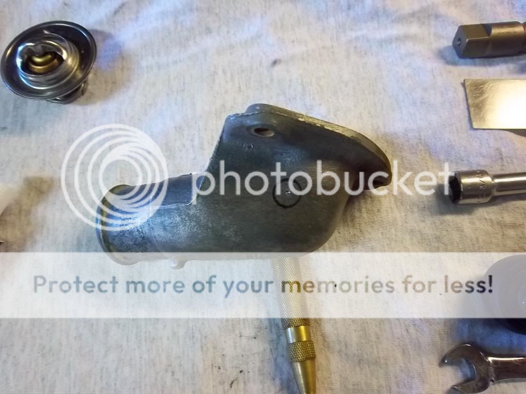

Mark the bit with a sharpie where you want to drill to.
Mark your water inlet where you want to install the stock sending unit for the dash gauge and center punch the spot.
