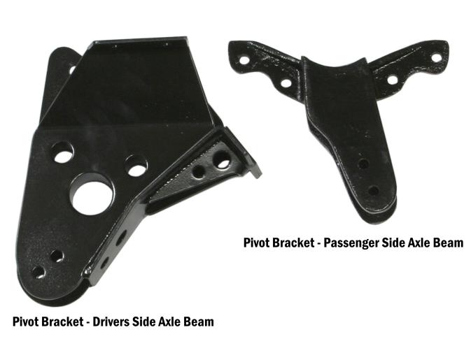

Beware Of Drop Brackets:
This is one of those topics that I think is overlooked and needs mentioning. People will buy a cheap lift kit to save money, or piece together their own lift with used parts. I strongly suggest you stay away from lift kits or suspension brackets that use a drop plate for the passenger beam pivot bracket.
Here’s why:
drop plate
Looking at the back side of this lift, you can see where the pivot bracket for the passenger side beam has been lowered by using a drop plate. If you look to the left, you can see where there is only 2-inches of space between the bracket and the front differential. There is a risk that upward suspension travel could cause the differential to strike the plate and bracket and break the differential housing.
pivot bracket
The photo above shows lift kit brackets that use the drop plate method. The photo below shows heavy duty brackets that includes a complete replacement passenger beam pivot bracket.

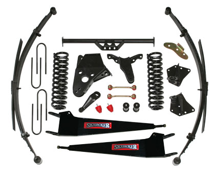

Skyjacker Suspension Lift Kits:
Skyjacker has one of the best systems on the market for 1983 – 1997 Ford Rangers.
Skyjacker kits come with new heavy duty drop brackets, dropped pitman arm, 4-6 inch coils and either rear blocks, add-a-leafs or springs. You can upgrade to the longer radius arms that comes with a new transfer case / transmission crossmember and order new brake lines.
The Skyjacker 2″ lift kit includes front coils and rear add-a-leafs.
The 4″ & 6″ Class I lifts include coils and all drop bracketry. Kits use rear blocks and/or add-a-leafs and Systems use rear leaf springs.
The Class II kits and systems are available for 4″ and 6″ lifts and include a pitman arm, sway bar end link & replacement tubular offset radius arms extended 15″ longer than stock offering up to 30% more wheel articulation and less frame fatigue than using radius drop brackets. Newly designed center hinge brackets are both stylish and more rugged than stock or standard applications.
Kit’s are available from 1.5 to 8-inches
TRS NOTE: We believe these are the best bolt on kits out there for the 1983-1997 Ford Ranger. They have beefy replacement drop brackets and can be had with a nicely constructed set of radius arms that have a new transmission crossmember that bolts between the rear radius arm mounts to brace them.

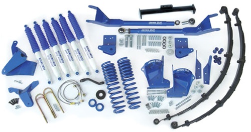

James Duff Suspension Lift Kits
James Duff offers a 3-inch Stage one kit, and a 5-6 inch Stage 3 kit.
The 5-6 inch Stage 3 kit includes:
  • 5-6” Progressive Rate Coil Springs*
  • New Coil Tower Dual Shock mounts
  • Rod Ended Extended Radius Arms
  • HD Tranny Crossmember
  • Extended Stainless Brake lines
  • Drop pitman arm (fits PS only)
  • Axle pivot drop brackets
  • 4 front shocks, 2 rear shocks, 6 shock boots
  • Urethane coil pads, leveling spacer
  • U-bolt kit
  • Complete Replacement Leaf Spring Packs
  • Spring Eye Bushings
Link: https://www.dufftuff.com

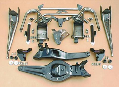

Autofab Model 35 Wheel Travel Kit:
Pricing does not include for options. For 1983 Ranger/BroncoII trucks, 16″ wheel travel, custom coil spring buckets and shock hoop structures. Specialty Pivot brackets duplicating Ford Factory 2-inch lift on Ranger STX trucks. This allows the middle U-joint to operate to achieve 16-inches of wheel travel. Drop pitman arm required. Beams are cut and turned for alignment correction of 4-inch lift. Special Autofab radius arms correct the castor alignment and allow for more droop and wheel travel. A variety of shock configurations available, such as 2-inch shocks (2) per wheel as a proven starting point. System compatible with Autofab equal length tie rod steering system. Shipped by pallet and truck freight additional.
Autofab Ford Ranger Suspension Kit
Link: https://autofab.com/
[TRS RECOMMENDED]

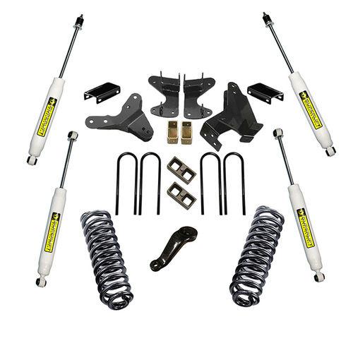

Rough Country Suspension Lift Kits:
Rough Country offers 1.5-inch leveling coils, and a 4-inch suspension lift kit. The 4-inch kit can be purchased with or without replacement rear leaf springs.
TRS Note: This kit uses a drop plate to lower the passenger axle beam pivot bracket. Refer to the ‘Beware Of Drop Brackets” section at the top of this page.
