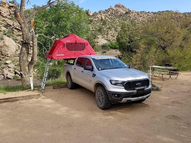

First Use – Overland Expo West
My first opportunity to use the tent was when I went to Overland Expo West (Flagstaff, Arizona) in May.
When I set up the tent, I noticed that the tent body had pulled out of the track that it’s mounted in. While at the Expo, I spoke to a Yakima representative that told me to stick the tent back in the track with a screwdriver. I decided to wait until I returned home to try and fix it.
On the way back home I stopped and camped for the night in Arizona. It was nice being able to setup camp quickly, be up off of the ground, and enjoy the views and the fresh air from the screened windows.

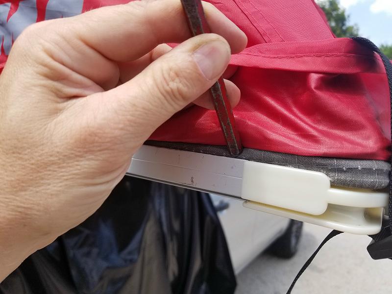

When I returned home, I attempted to repair the tent like the Yakima representative instructed me. The tent had actually pulled out of the track at each corner of the side of the tent that opens.
I decided to use a chisel instead of a screwdriver since it had a wider edge. I ended up using the blunt end to tap the tent body down into the track with a plastic mallet, and then the chisel end to tap it the rest of the way in.
Quite a bit of the tent had came out of the track on one side, and I took my time to make sure I didn’t damage the material.

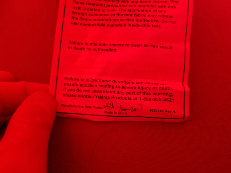

When I arrived back home in Texas, I opened the tent so I could take a photo of the tag inside.
As you can see, the Yakima Skyrise Tent was made in China on November 23rd, 2017.
