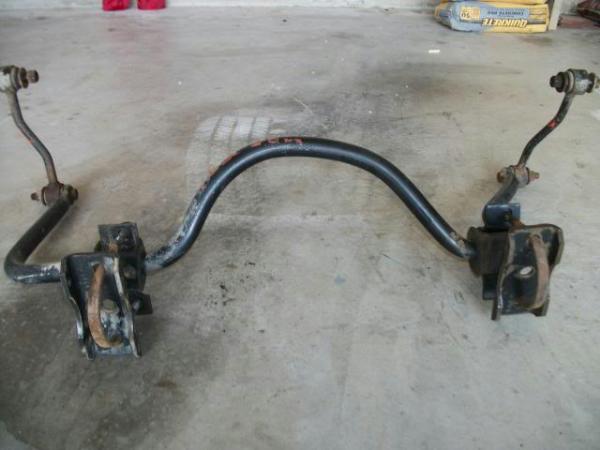

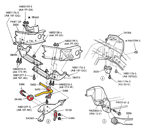

Behind The Front Axle:
This setup mounted the sway bar to the inside of the radius arm and was attached to a crossmember that went between the radius arm brackets.
(Sway bar behind the front axle – inside of radius arm)
This setup was used on various 1st Generation (1983-1988) Ford Rangers. Interestingly, the 1st Generations were found with the axle mounted behind, and in front of the axle. There doesn’t seem to be a clear-cut answer as to why Rangers had different setups.
Rangers that have been found with the sway bar mounted behind the axle are:
- 1983 Ford Ranger 4×4 regular cab
- 1987-1988 Ford Ranger super cabs
More likely exist, this is just the info we have to date.

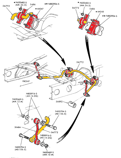

In front of the axle:
This style of setup had a bracket on the front of the axle beams that held a sway bar link. The sway bar was then attached to the bottom of the frame forward of the axle (see photo below)
(Sway bar in front of the front axle)
This setup has been found on:
- 1986 and 1988 Ford Ranger regular cab (1988 is a highrider package)
- 1987 Ford Ranger STX highrider
- All Ford Bronco II’s
It appears that all Rangers made from 1989-1997 had the sway bar mounted to the front of the axle beam. The stock front sway bar for the 1993-1997 Ford Rangers is reported to be 23mm.
