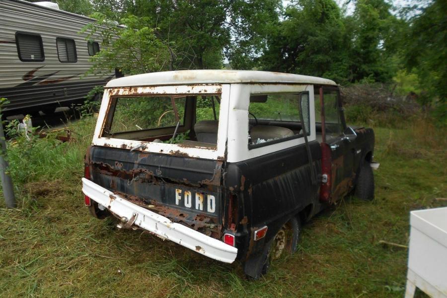

Believe it or not, there are still old 1971-1977 Ford Bronco’s out there. Some are so far gone, that they don’t bring a ridiculous price tag. There are even people out there that collect and save the axles out of them.
Are there still early Ford Bronco's out there?

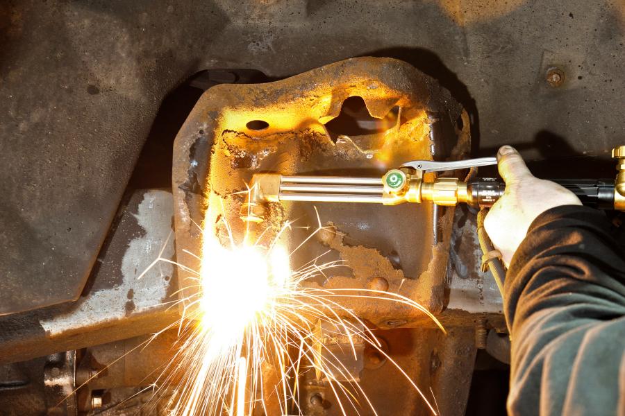

The first thing you’ll need to do is remove the Dana 35, along with it’s mounting brackets, radius arms, and the upper coil spring bucket / shock mounts. If your Ranger hasn’t already been lifted, and still has the original stock brackets, you’ll have to remove the rivets that hold them in place.
If you have a torch, you can burn them off. If you don’t, you can remove them by grinding off the heads of the rivets, and then driving them out with a sledgehammer and punch.
Cutting off the Ford Ranger coil bucket / mount

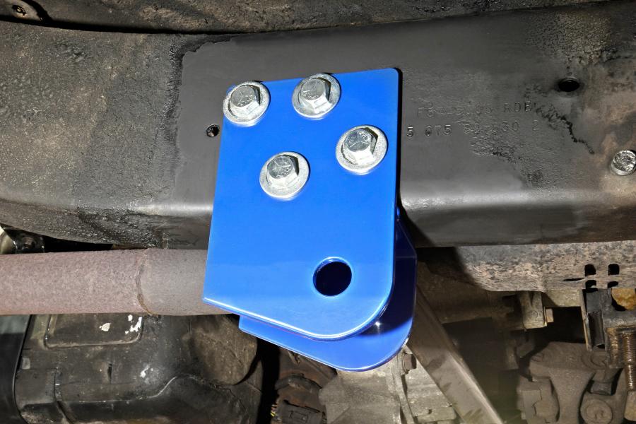

Once the old brackets are removed and the frame is cleaned up, new holes are drilled so the James Duff brackets can be bolted on.
Drilling new holes in the frame
James Duff radius arm frame mount
The James Duff brackets are very stout and made from 1/4-inch steel plate.
James Duff upper coil spring bucket mount
Once the factory buckets are removed, only one rivet hole per side needed to be enlarged for installation. otherwise, the James Duff coil buckets are a direct bolt on.

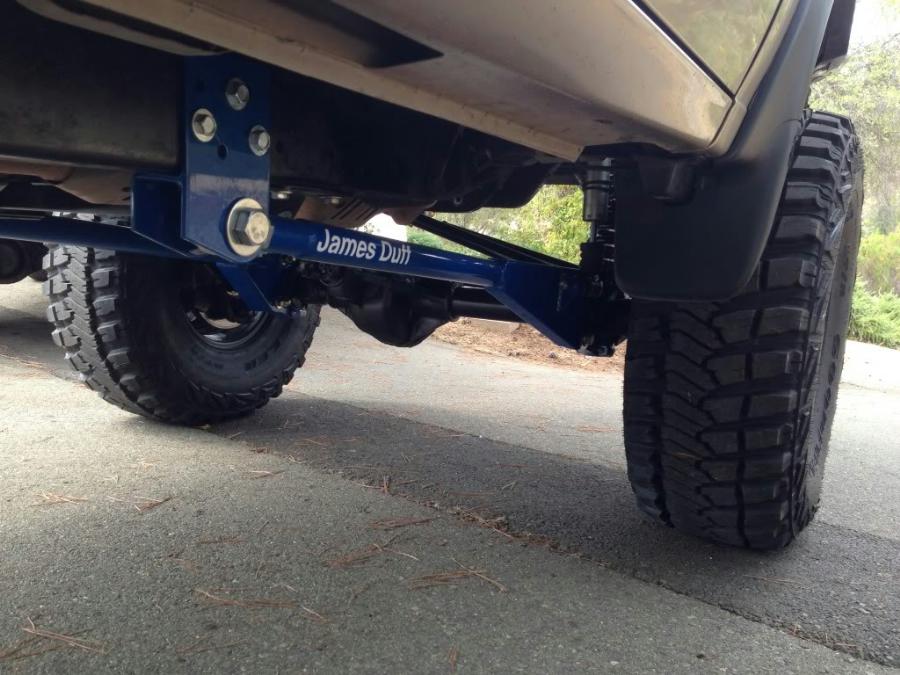

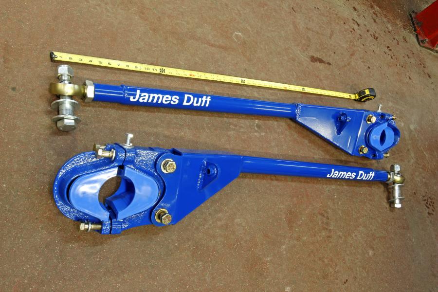

The new longer radius arms will allow the Dana 44 far greater wheel travel than the stock Ford Ranger radius arms.
James Duff Ford Ranger Dana 44 Radius Arms

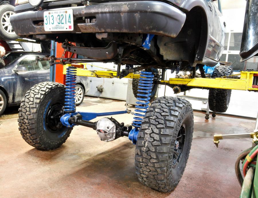

James Duff Ford Ranger Dana 44 Swap Complete
You don’t need a mechanics lift to do this swap, but it can make it easier. If you have any mechanical abilities and can install a suspension lift, you can do this swap in your driveway or garage.

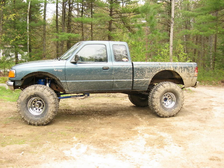

1993-1997 Ford Ranger 4x4 With A James Duff Dana 44
