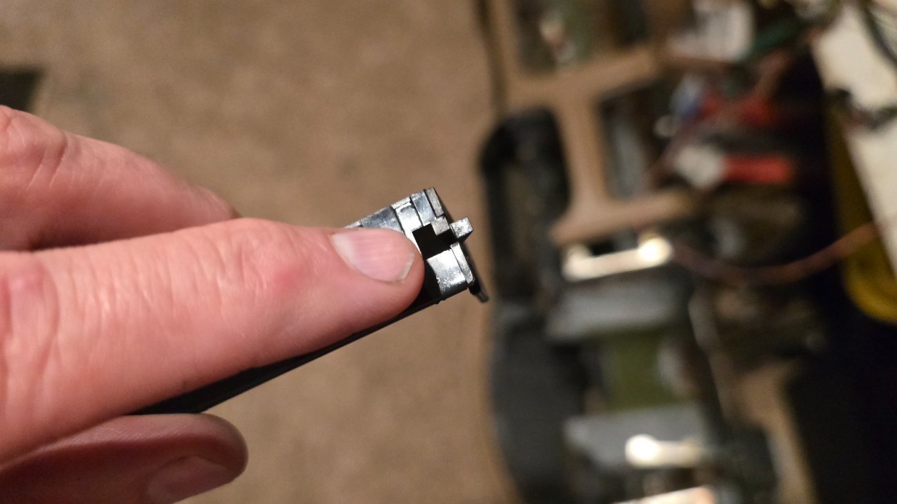

I think ot's easier to detach it from the shifter cable and just bring the inducator assembly out with the gauge cluster. Hang on. I can get some pictures real quick.
I was wrong. 2 little tabs and it unsnaps from the cluster. At least on some models. This is a '96 cluster.
One little springy tab by my thumb nail.

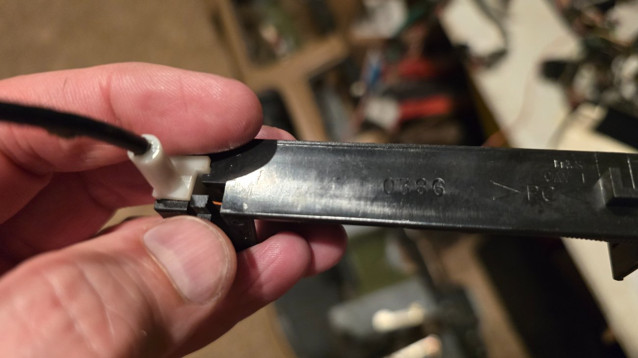

Another on the other end by my fingernail

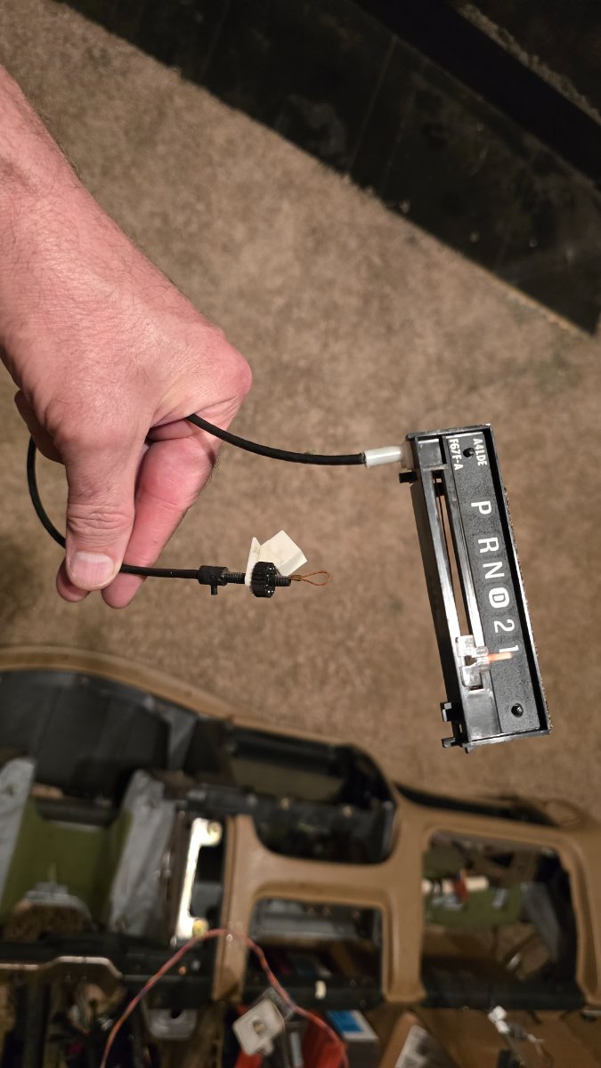

Slides out like this

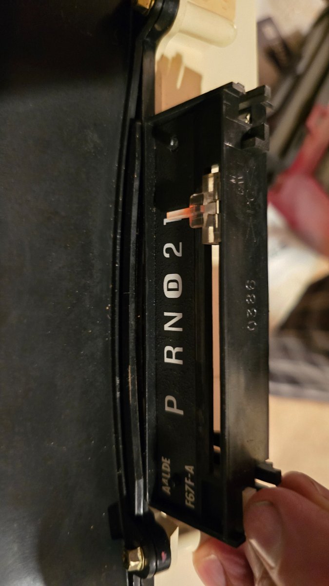

Whole assembly looks like this
Tnx a bunch I got it apart this morning. Cleaned up the lens and other plastic bits to find that the replacement bulbs are too large. I order them from a reliable company that I thought would get me the proper part but... So I've been on line trying to find some leds for the late model 3rd gen Rangers and T5 pops up but they come in different sizes it seems. So what am I look for than an aspirin.
