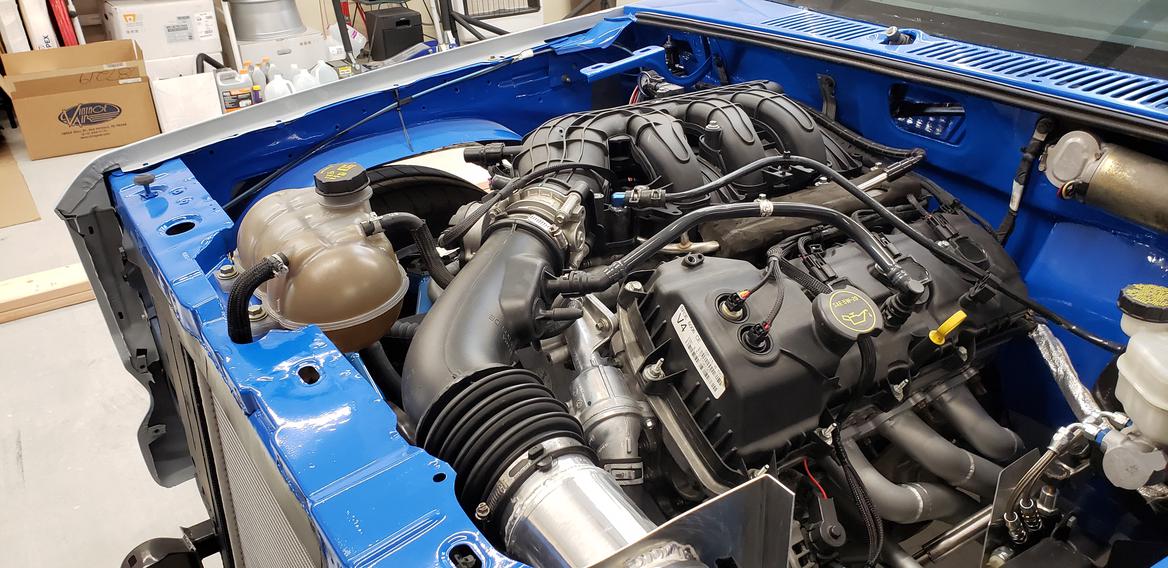

Ford 3.7L Engine Swap
Swapping a Ford 3.7L Engine into a 1983-2011 Ford Ranger
Short answer: It’s doable — many owners have dropped a Ford 3.7L (Cyclone/Duratec 3.7) into older Rangers — but it’s a medium-to-major custom swap. The big hurdles are mechanical fit (mounts, oil pan, firewall/clearance), driveline/transmission compatibility, and the electronics (engine harness + PCM/immobilizer). If you plan carefully and bring the right donor pieces (or buy a swap harness/standalone ECU), you can make it work.

3) Major Obstacles
  1. Engine mounts & clearance: The 3.7’s mount points, oil pan shape, and valve-cover position can interfere with the Ranger firewall, crossmember, and steering. Expect to use custom mounts or adapter plates and possibly clearance work on the firewall.
  2. Transmission & driveline: Decide whether to use the Ranger transmission (with adapters) or the donor’s transmission. Bellhousing pattern, starter position, pilot bearing, and input shaft spline count must all match. You may need driveshaft and crossmember modifications.
  3. Electronics (harness & PCM): Modern 3.7L engines require their PCM and full engine harness. You’ll either need to transplant the donor’s immobilizer modules and keys, or run a standalone ECU. Integrating the harness into the Ranger chassis (power, starter, fuel pump, cluster) is one of the hardest parts.
  4. Exhaust & intake: The manifolds and exhaust routing will likely require custom fabrication. Intake routing and MAF placement must match the donor PCM calibration.
  5. Cooling & accessories: The radiator, hoses, and accessory drives (A/C, P/S, alternator) may not align with the Ranger mounts. You may need to use the donor’s cooling system or custom brackets.
  6. Legal & emissions: Swapping in a newer engine may trigger emissions or inspection requirements depending on your state. Always confirm legality before starting the project.

5) Step-by-Step Plan
  1. Define your goals: Daily driver, off-road toy, or performance build? Decide early whether to keep the Ranger transmission or use the donor’s.
  2. Choose your donor: Pick a donor year that uses a similar PCM generation. Ideally, get the full engine bay harness and PCM together.
  3. Harvest components: Take the engine, harness, PCM, keys, intake, manifolds, alternator, starter, radiator, and accessories. Label every connector.
  4. Mock fit the engine: Test-fit in the Ranger bay. Check for firewall, steering, and hood clearance. Modify only where needed.
  5. Mounts & crossmember: Fabricate or adapt mounts for proper engine position and driveshaft alignment.
  6. Transmission mating: Bolt the engine to the transmission (or use the donor trans). Confirm starter position and driveshaft length.
  7. Wiring & PCM integration:
    • Full transplant: use donor PCM and modules.
    • Patch harness: splice engine harness into Ranger chassis.
    • Standalone ECU: eliminates immobilizer but adds cost.
  8. Fuel system: Upgrade pump and lines to match 3.7L fuel pressure requirements.
  9. Cooling & exhaust: Fit radiator, fans, and fabricate the exhaust.
  10. Sensors & emissions: Ensure all O2 sensors and check-engine light circuits function.
  11. Tuning & programming: Flash or tune the PCM for the correct vehicle and transmission setup.
  12. Final checks: Verify leaks, charging system, cooling, and drivability before first test run.
