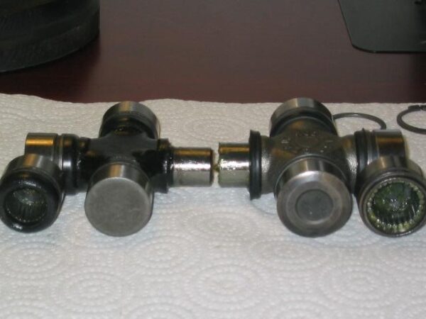

260x u-joint (left) versus a 760x (297x) u-joint (right)
Above: 260x u-joint (left) versus a 760x (297x) u-joint (right)
Below: 760x (297x) u-joint cap (left) versus 260x u-joint cap (right)

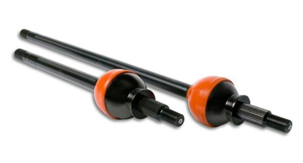

RCV Performance Ultimate CV Axle Shafts
RCV CV Axles – RCV Performance Ultimate CV Axles simply replace your Ford Bronco’s weak Dana 44 U-joint axle shafts with a high-strength constant velocity design. Tests prove Ultimate CV Axles to be twice as strong as OEM axle shafts, and they’re just as tough at a straight angle as they are at extreme angles – where U-joints are weakest. Ultimate CV Axles also eliminate U-joint binding to allow smooth transfer power to the ground. Even if you have big tires and big power there are no worries. Ultimate CV Axles are low maintenance and operate with a smoothness you can feel – whether off road or on the street.

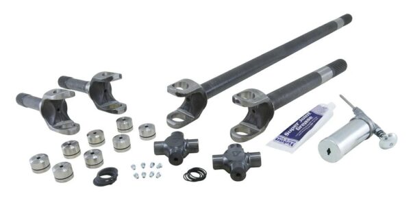

Yukon Axle & Gear Dana 44 Chromoly Axle Kit
Yukon Axle & Gear Chromoly Axle Kits – High quality alloys and the latest in heat-treating technologies provide for a strong axle for off-
road.
Yukon YA W24130 – Their W24130 kit includes inner and outer 4340 Chromoly axles and Spicer U-Joints.
Yukon YA W24132 – Their W24132 kit includes inner and outer 4340 Chromoly axles and Yukon Super Joints.

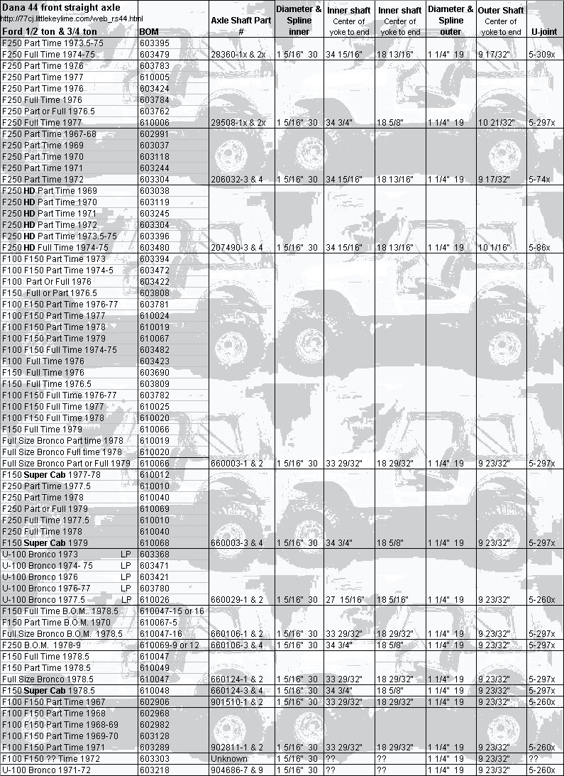

1966-1977 Ford Bronco axle shaft dimension chart
Ford Dana 44 Axle Shaft Lengths
Ford Dana 44 Axle Dimension Chart

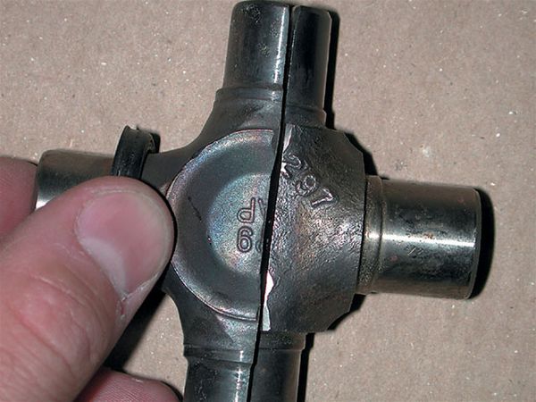

760x vs 297x U-Joints
You will likely see some aftermarket axle shafts for your early Bronco Dana 44 that take a 760x U-joint. The 760x is the stock replacement part number for the old 297x U-joint.
The left half is a 760x u-joint – the right half is the old 297x u-joint
The cross of the 760x is cold-forged, while the 297x is hot-forged. The cold forging makes for a denser product. Under cyclical bench testing, the new 5-760X outlasted its 5-297X predecessor by 10 times. While this doesn’t mean that the new U-joint is 10 times stronger, it does mean it’s 10 times more durable.
