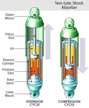

Shock absorbers work on the principle of fluid displacement on both the compression and extension cycle. A typical light truck will have more resistance during its extension cycle then its compression cycle. The compression cycle controls the motion of a vehicle’s unsprung weight, while extension controls the heavier sprung weight.

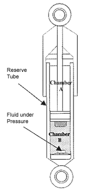

Compression Cycle:
During the compression stroke or downward movement, some fluid flows through the piston from chamber B to chamber A and some through the compression valve into the reserve tube. To control the flow, there are three valving stages each in the piston and in the compression valve.
At the piston, oil flows through the oil ports, and at slow piston speeds, the first stage bleeds come into play and restrict the amount of oil flow. This allows a controlled flow of fluid from chamber B to chamber A.
At faster piston speeds, the increase in fluid pressure below the piston in chamber B causes the discs to open up away from the valve seat.
At high speeds, the limit of the second stage discs phases into the third stage orifice restrictions. Compression control, then, is the force that results from a higher pressure present in chamber B, which acts on the bottom of the piston and the piston rod area.

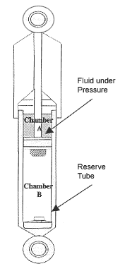

Extension Cycle:
As the piston and rod move upward toward the top of the pressure tube, the volume of chamber A is reduced and thus is at a higher pressure than chamber B. Because of this higher pressure, fluid flows down through the piston’s 3-stage extension valve into chamber B.
However, the piston rod volume has been withdrawn from chamber B greatly increasing its volume. Thus the volume of fluid from chamber A is insufficient to fill chamber B. The pressure in the reserve tube is now greater than that in chamber B, forcing the compression intake valve to unseat. Fluid then flows from the reserve tube into chamber B, keeping the pressure tube full.
Extension control is a force present as a result of the higher pressure in chamber A, acting on the topside of the piston area.

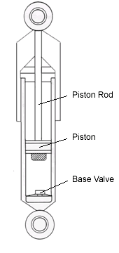

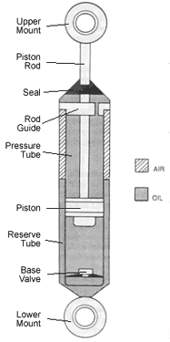

Basic Twin Tube Design:
The twin tube design has an inner tube known as the working or pressure tube and an outer tube known as the reserve tube. The outer tube is used to store excess hydraulic fluid.
There are many types of shock absorber mounts used today. Most of these use rubber bushings between the shock absorber and the frame or suspension to reduce transmitted road noise and suspension vibration. The rubber bushings are flexible to allow movement during suspension travel. The upper mount of the shock absorber connects to the vehicle frame.
Notice that the piston rod passes through a rod guide and a seal at the upper end of the pressure tube. The rod guide keeps the rod in line with the pressure tube and allows the piston to move freely inside. The seal keeps the hydraulic oil inside and contamination out.
The base valve located at the bottom of the pressure tube is called a compression valve. It controls fluid movement during the compression cycle.
Bore size is the diameter of the piston and the inside of the pressure tube. Generally, the larger the unit, the higher the potential control levels because of the larger piston displacement and pressure areas. The larger the piston area, the lower the internal operating pressure and temperatures. This provides higher damping capabilities.
Ride engineers select valving values for a particular vehicle to achieve optimal ride characteristics of balance and stability under a wide variety of driving conditions. Their selection of valve springs and orifices control fluid flow within the unit, which determines the feel and handling of the vehicle.

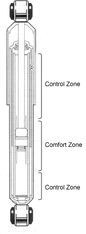

A leap beyond fluid velocity control is an advanced technology that takes into account the position of the valve within the pressure tube. This is called Position Sensitive Damping (PSD).
The key to this innovation is precision tapered grooves in the pressure tube. Every application is individually tuned, tailoring the length, depth, and taper of these grooves to ensure optimal ride comfort and added control. This in essence creates two zones within the pressure tube.
The first zone, the comfort zone, is where normal driving takes place. In this zone the piston travel remains within the limits of the pressure tube’s mid range. The tapered grooves allow hydraulic fluid to pass freely around and through the piston during its midrange travel. This action reduces resistance on the piston, assuring a smooth, comfortable ride.
The second zone, the control zone, is utilized during demanding driving situations. In this zone the piston travels out of the mid range area of the pressure tube and beyond the grooves. The entire fluid flow is directed through the piston valving for more control of the vehicle’s suspension. The result is improved vehicle handling and better control without sacrificing ride comfort.

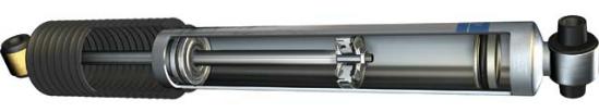

Mono-Tube Design:

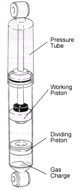

These are high-pressure gas shocks with only one tube, the pressure tube. Inside the pressure tube there are two pistons: a dividing piston and a working piston. The working piston and rod are very similar to the twin tube shock design. The difference in actual application is that a mono-tube shock absorber can be mounted upside down or right side up and will work either way. In addition to its mounting flexibility, mono-tube shocks are a significant component, along with the spring, in supporting vehicle weight.
Another difference you may notice is that the mono-tube shock absorber does not have a base valve. Instead, all of the control during compression and extension takes place at the piston.
The pressure tube of the mono-tube design is larger than a twin tube design to accommodate for dead length. This however makes it difficult to apply this design to passenger cars designed OE with a twin tube design. A free-floating dividing piston travels in the lower end of the pressure tube, separating the gas charge and the oil.
The area below the dividing piston is pressurized to about 360 psi with nitrogen gas. This high gas pressure helps support some of the vehicle’s weight. The oil is located in the area above the dividing piston.
During operation, the dividing piston moves up and down as the piston rod moves in and out of the shock absorber, keeping the pressure tube full all times.

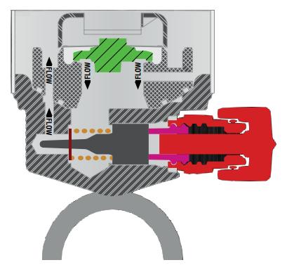

Adjustable Shocks:
Some companies offer adjustable shocks. Rancho is one of those companies that offers an adjustable shock with the RS9000XL. The shock has a 9-position knob that meters oil flow inside the shock controlling compression and rebound. The result is (9) different levels of enhanced performance with each resulting in a noticeable change (setting 1 = soft / setting 9 = max control)
