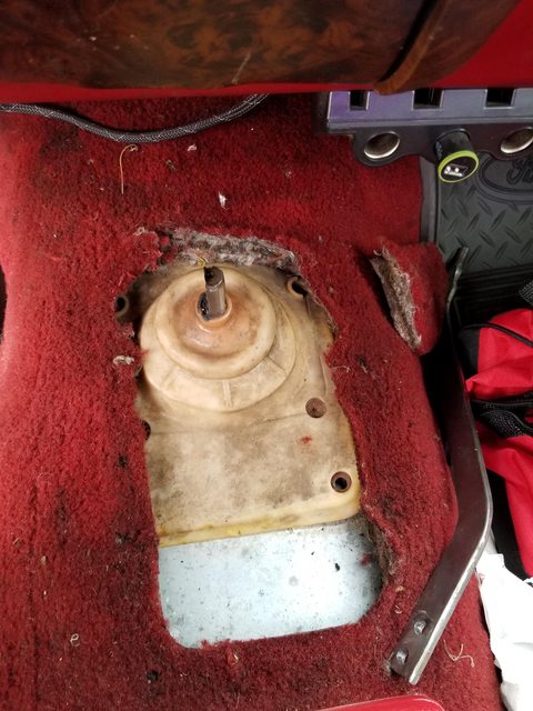

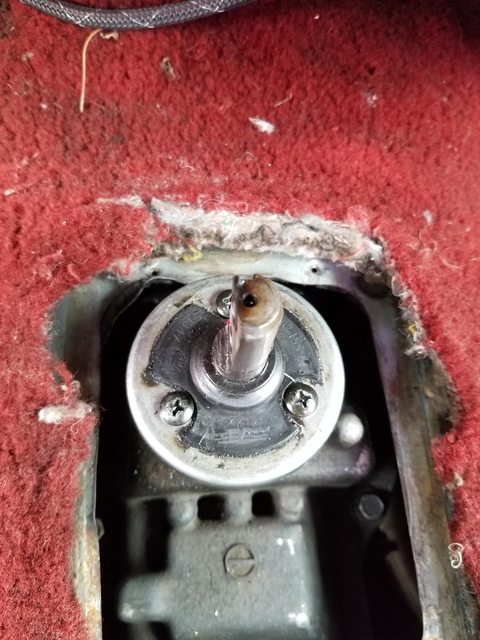

Take the shifter stub out of the transmission and grind the driver side of the stub down about a quarter of an inch. Then grind the passenger side of the stub just enough to make a nice even flat spot.
Then drill two holes in the center of the stub, use lots of lube and work slowly. The stub is harder to drill through the passenger side for some reason. You can tap the holes or use a bolt with a nut. The nut and bolt method works better.
