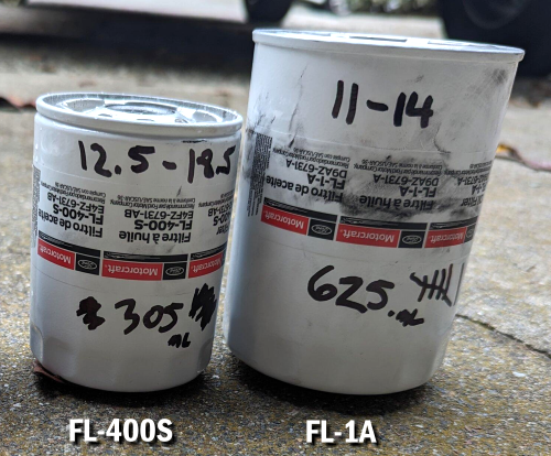

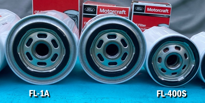

Then one day in the local parts store I noticed that the gasket and mounting screw on my filter appeared to be similar to that of the old Ford FL-1A filter. The FL-1A is both larger in diameter and longer than the standard filter that is on my 2.5L engine, almost 50% by volume.
Motorcraft FL-1A and FL-400S Oil Filters

Motorcraft FL-1A and FL-400S Oil Filter Mountings
