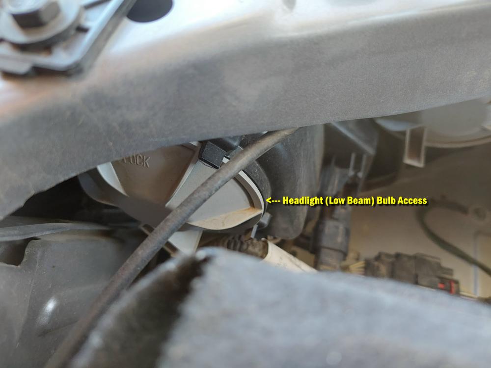

The bulbs sit behind white caps that twist off.
2019-2023 Ford Ranger headlight bulb access
2019-2023 Ford Ranger high beam bulb access
2019-2023 Ford Ranger low beam headlight access
Once the cover is off, the light bulb assembly twists and comes out.
2019-2023 Ford Ranger headlight bulb access cover removed
You can see by the position of the bulb that it twists to the left and then pulls out.
