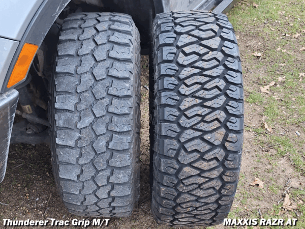

When I first built my 2021 Ford Ranger FX4, I lifted it 3.5 inches with a Skyjacker kit and added 295/70/17 (33.5″ × 11.8″ × 17″) Thunderer Trac Grip M/T tires. They performed extremely well off-road, but highway mileage wore them out quickly; after about a year and a half, I was already shopping for replacements. This time, I wanted a rugged-terrain tire that bridged the gap between an all-terrain and mud-terrain—and would last more than 30,000 miles.

Maxxis RAZR AT review tread comparison vs Thunderer Trac Grip MT

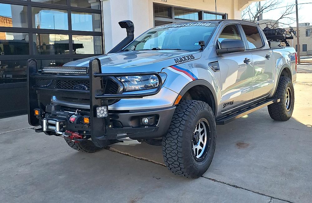

When the tires were mounted on my 17×9 Pro Comp 41 Series Phaser machined-face alloy wheels, they required only 0.25 oz of weight to balance—impressive for a tire this aggressive. On the highway ride home, I was surprised at how smooth and quiet they were. I expected a noticeable improvement over my mud-terrains, but I did not expect them to be this quiet given the tread design.

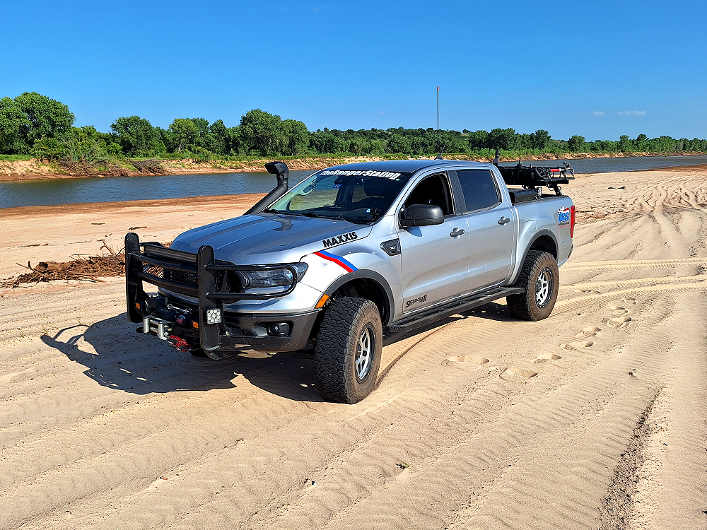

Ford Ranger FX4 with Maxxis RAZR AT tires in deep sand along the Red River
15,000-Mile Maxxis RAZR AT Review
With just over 15,000 miles, the tread has worn from 15/32″ down to between 12/32″ and 11/32″. The wear is smooth and even, and the tires continue to balance perfectly. Living in rural Texas where the speed limit is 75 MPH, these tires have seen more high-speed highway miles than anything else.
Maxxis RAZR AT 15000 mile sidewall wear review photo
Maxxis RAZR AT 15000 mile tread wear review photo
If you follow my adventures, you know these tires have seen harsh trails in Kentucky, Oklahoma, and Colorado—trails rough enough to put gouges in the edge of my wheels. I’ve also run deep sand along the Red River in Oklahoma, and the tires impressed me with how well they stayed on top of the sand. They’ve consistently performed like a dedicated mud-terrain/off-road tire while providing excellent traction in every situation.
