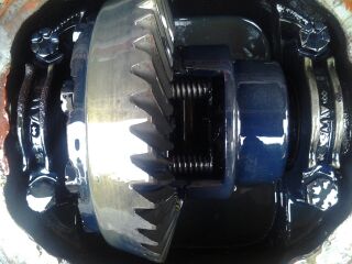

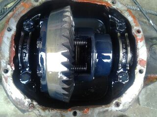

Yeah I did take off the cover and this is what I saw.
I cant remember if I heard anything thou. When I spin one side of the axle both sides always spin.
That looks like an Auburn LSD.
The break down in nomenclature screws someone once again. The seller either doesn't know the difference between a LSD and locker (which happens all the time), or he screwed you.
Yeah looks like a LS carrier...the damn thing is huge!
