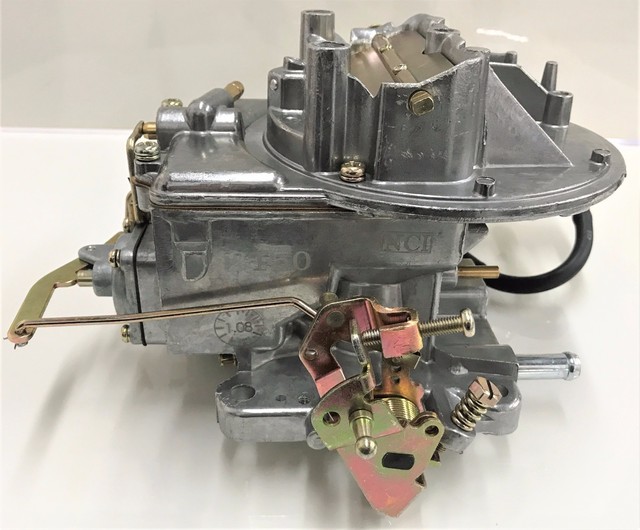

swap one of those on.
its easy.
or 3 of these...
even easier.
or 3 of these...
even easier.
This would be so much easier on the 2.9. The lower intake is already set up nicely to accept a triple carb setup. He'd just have to get some adapter plates made up.

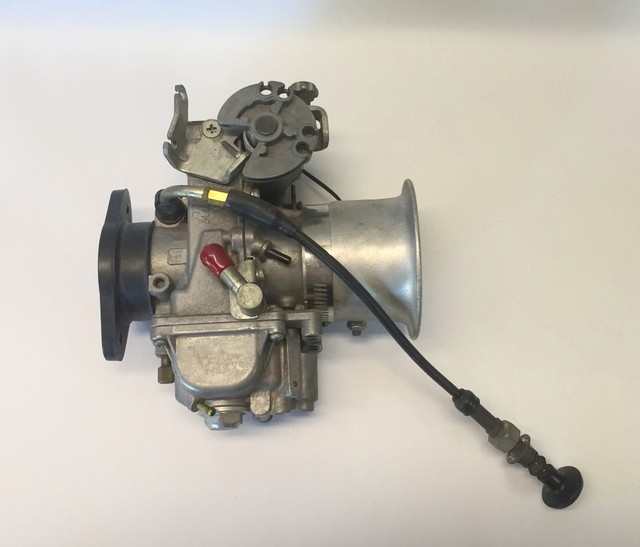

Funny, it almost looks like a four wheeler carburetor.
its easy.
