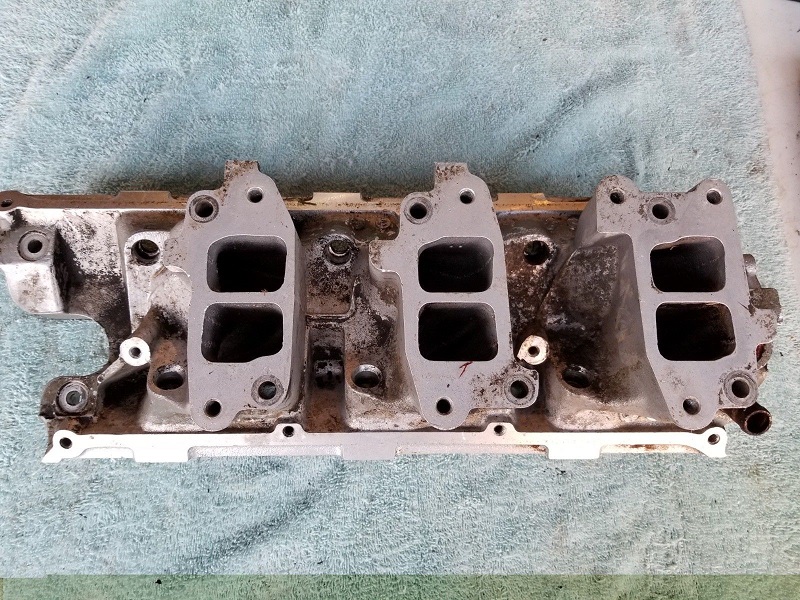

I'm picturing three Weber DGV's in a line, attached to the lower intake.
