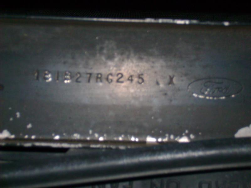

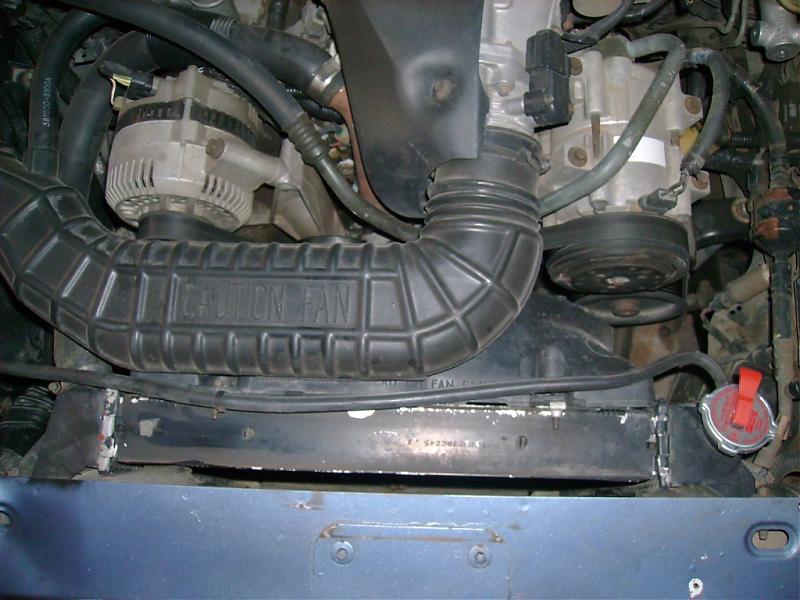

How can I tell which radiator is in there? when I changed the fan clutch I could tell the thing in there is not the stock one because the fan housing does not match the notches in the bottom frame of the radiator.. it's a ford radiator though I just dunno which one! boneyard for sure......
The alum rad from an auto explorer has a 2" thick core... looks like this

As for Chevron for me, I like the techron stuff in their products and have never had any problems with the engine or changing the oil every 5000 miles so as you say it's a matter of what works for everyone I guess.. as for the radiator, here you go....
Hope these help identify it.
Thanks!
Funny... looks like mine... :icon_confused: maybe I need to change the fan housing? OR.... maybe it's clogged? I could swear I felt the temp change through both hoses, but I'll re-check....
