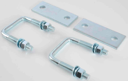

If I remember correctly, it is always good to beef up BOTH front and back at the very same time. I have put leaf spring clamps on the back already. They tend to help the rear sway bar. But if I need more, I will also look into a Bronco II bar. Thanks for all your help, guys.
