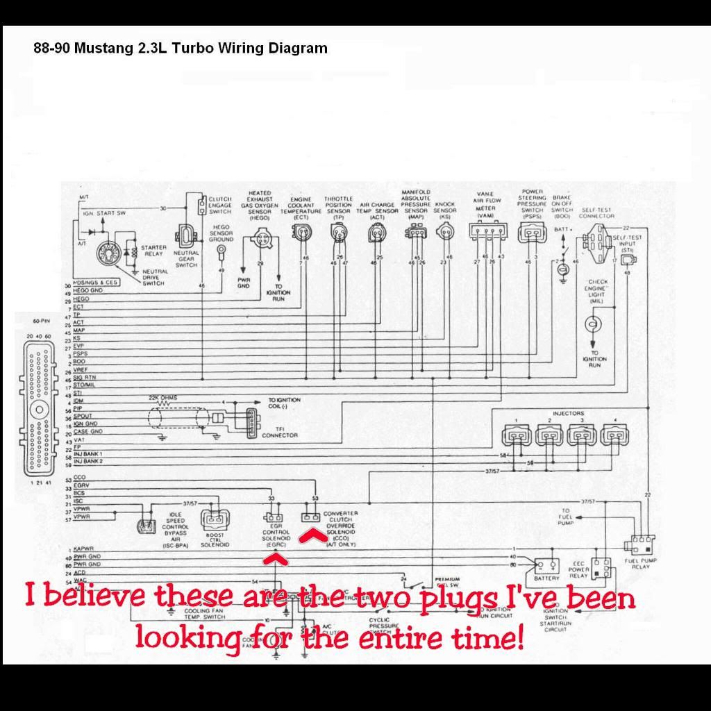

I'm not trying to be a smartass or ANYTHING "Stmitch", but yes, I have the "simplified version" of the wiring diagram for a "standard" T-bird Coupe, the LA3 Ford Documented (wire color coded and ALL) wiring diagram, and last but not least, I have my 97 8pLUG Motors Diagram....

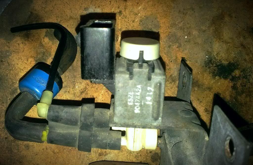

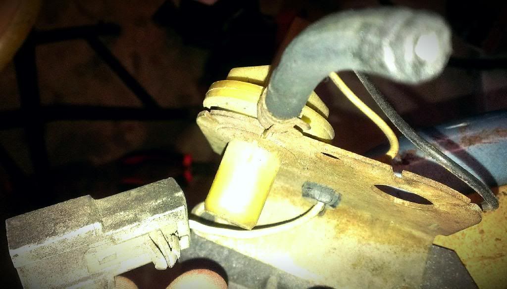

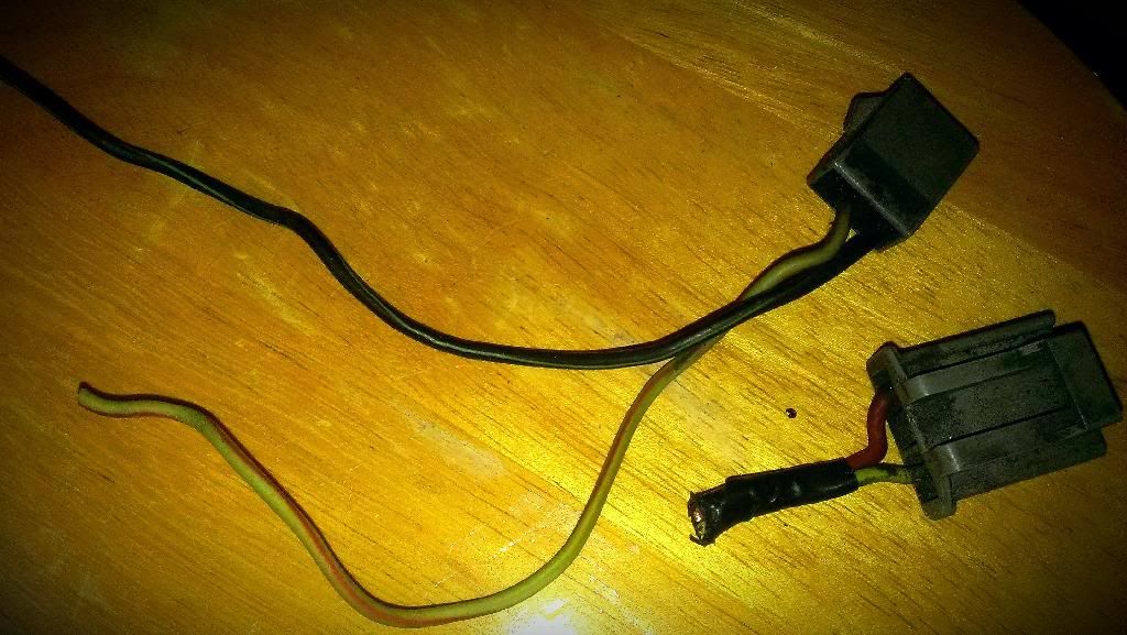

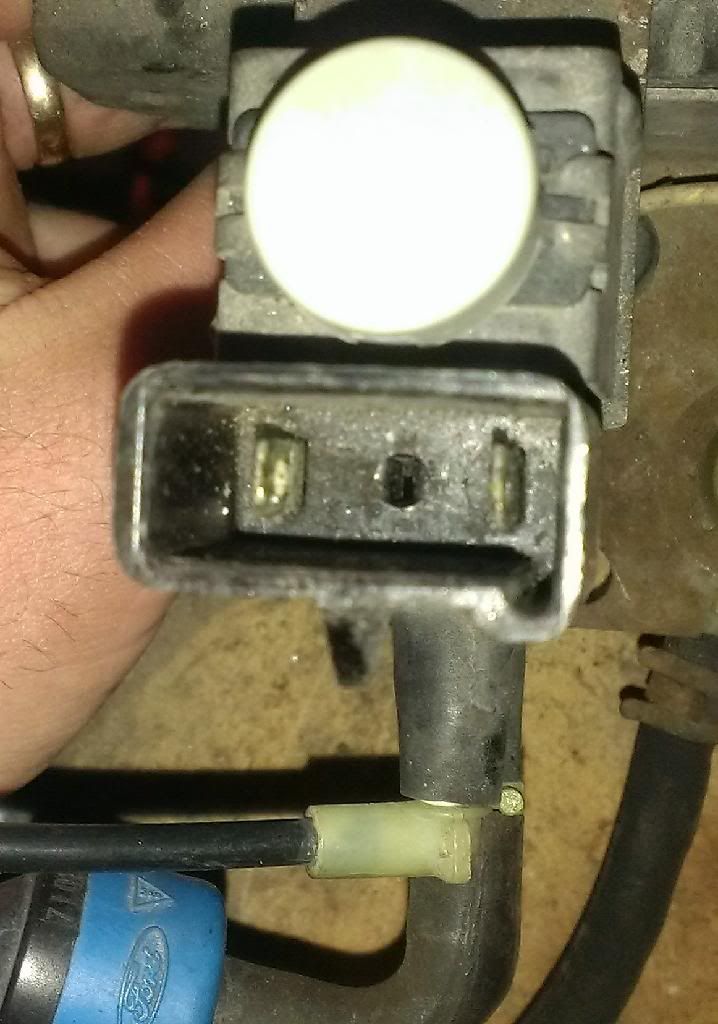

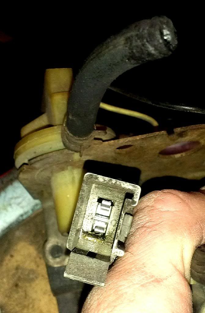

HERE GOES NOTHING ON THE PICTURES OF "THE 2 ELECTRICAL PLUGS" (ONE OF THEM IS GROUNDED TO THE ACTUAL MOUNT FOR THE "WHATEVER" SOLENOIDS???). I'm only posting them again incase anyone didnt see them originally or just have ZERO clue as to what im even talking avout - its ONLY to refreshen the memory. They're nowhere to be found, unless I'm just COMPLETELY looking over it?! It SHOULD be in THESE DIAGRAMS, as the harness, VAM, injectors and EVERYTHING are from a 87-88 T-Bird Turbo Coupe (the one with the STOCK 200HP!) I FINALLY got me a motor to rebuid, and though its not an 87-88, shes been built like one! All the way to the ITI Turbo and 35LB "Brown Top" Injectors. The motor was ORIGINALLY built for either a '83 SVO/T-Bird! AFTER THE "REFRESHING YOUR MINDS? FOLLOWED BY THE diagrams!

ENTIRE "FORD 87-88 TURBO COUPE LA3" - with color pinouts!

It's hard to tell colors properly from photos, but it looks to me that the one plug on the right in the first pic has a yel/red and a black/wh. That seems to correspond to the knock sensor in your second diagram. The other plug is a little less clear as a stripe might not be showing. It kind of looks like there is a one way vacuum valve connected in there somehow, that is the blue piece with a hose on both ends. the plug looks like one red and one yellow wire, which would indicate egr solenoid according to your diagram. All this info I gathered by looking at the info that you provided. Perhaps you could look a little closer at your own info for answers. You might also be looking for confirmation for your own observations, and in that case it would sound better if you say that up front.

First... let me show you the "thing(s)" I was talking about, the wire colors and so forth. Be sure to look closely at wire colors and the way it is "setup", per say....
This looks to be a Purple or Black wire, with either a green, yellow or white stripe on it. Along with another wire, that looks to be either a faded white wire with a red stripe, or possibly yellow with a pink... Hell, ONLY GOD KNOWS!!! (and me - hehe!)
Plug number two on this BS OBVIOUSLY has a PURE RED and PURE YELLOW wire... shouldn't be too hard to find! So I did....

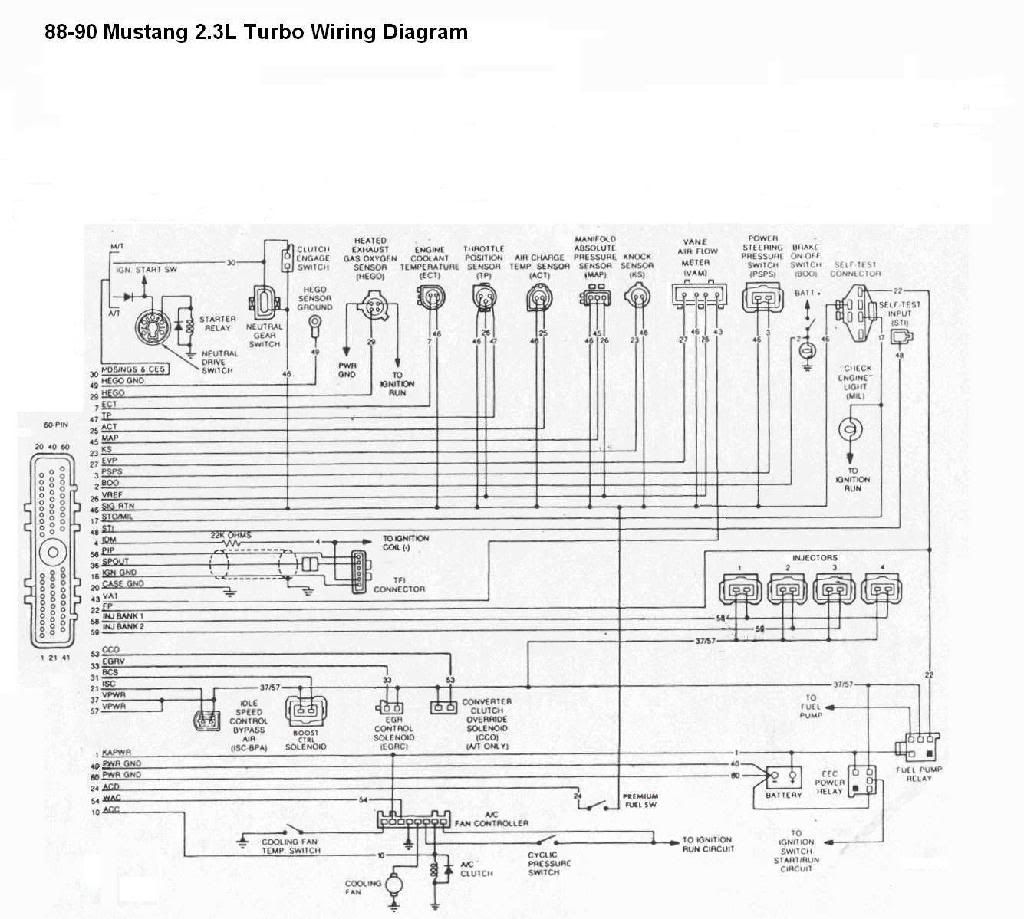

NOW, lets take a look at these CRAZY, CRAZY wiring diagrams for the LA3... ALL the "goodies" that came WITH the 87-88 T-Bird have pretty much been ripped out, no A/C either! So, you can pretty much take the two wiring schematics I'm about to post and "visually" delete out any "Ride Control", "Boost Control", Knock Sensor Stuff.... etc, etc...... A LOT WAS CUT OUT, ONLY THINGS LEFT ARE WHAT I NEED!!!
NOW, with those seen and everything.... can you find it?! No one else could for some odd reason. After I DUG INTO the wiring harness again and looked AGAIN, it ALL MADE COMPLETE SENSE!!! Believe it or not, I was correct on my assumption that I posted previously....

Now, one is the "EGR Control Solenoid" (my EGR is blocked off, so I can COMPLETELY delete that out of the mix (THIS IS THE RED AND YELLOW WIRED PLUG)! I'm not sure if I need to put a resistor in it's place, but I left enough wire for both in the "wrap up" of everything in case something needs to go back in or something. DOUBTFUL! Here it is...
NOW, the OTHER one is EITHER a "Converter Clutch Override Solenoid", which it SHOULDN'T HAVE due to it being a 5 Speed and NOT an Auto!!! So THAT can be deleted as well, for MY application.
It could ALSO be a "Boost Control Solenoid"... and AGAIN, this is NOT going to be used in my setup!!!! I will be using my OWN setup to flip from 10ish-20ish PSI, on the fly....
SO THATS THAT!!!! Here's the OTHER "unknown" solenoid!!! LOL! Not really...

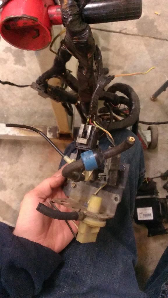

HERE'S YOUR (MY!!!!) RIPPED OUT SOLENOIDS!!!!!

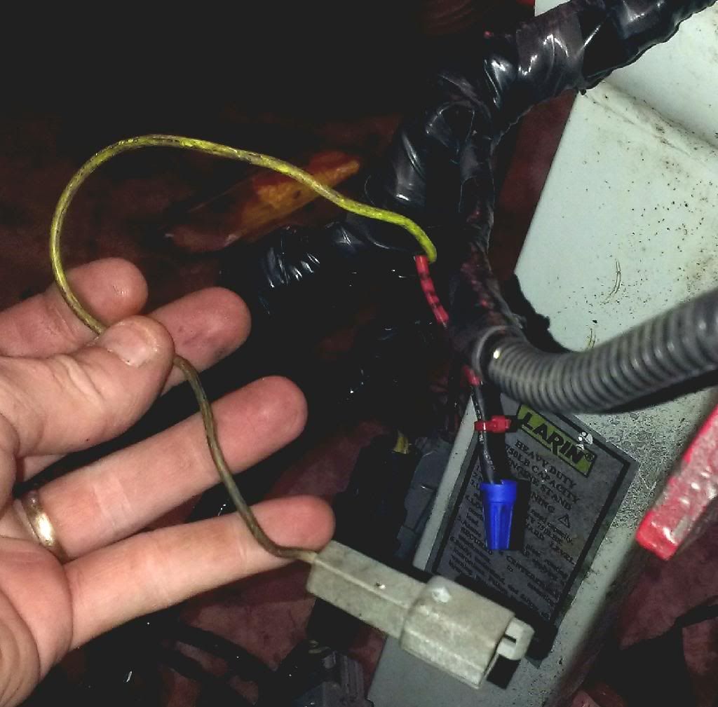

I LEFT THE RED WIRE, SHRINK WRAPPED AND CAPPED OFF, SO THAT I HAVE A "SPARE" "PWR" JUST HANGING AROUND, READY TO BE TAPPED IF NEED BE! EVERYTHING ELSE WAS CUT BACK, SHRINK WRAPPED AND TAPED UP!
Here it is and NO, THAT'S NOT THE SAME YELLOW WIRE!!! IT'S FOR SOMETHING ELSE, AS YOU WILL SEE!

I really don't know squat about these motors and I hope you're right, but...I still stand by my original observation;
and

The ONE is MOST definitely the EGR solenoid, the one with the SOLID RED & YELLOW WIRES, no questions about it!
The other, whether related to boost control, knock sensor, or that OTHER "thing" I mentioned, can be deleted too! As the knock sensor is deleted from the intake manifold. YES, THE INTAKE MANIFOLD! Lol... :headbang:
