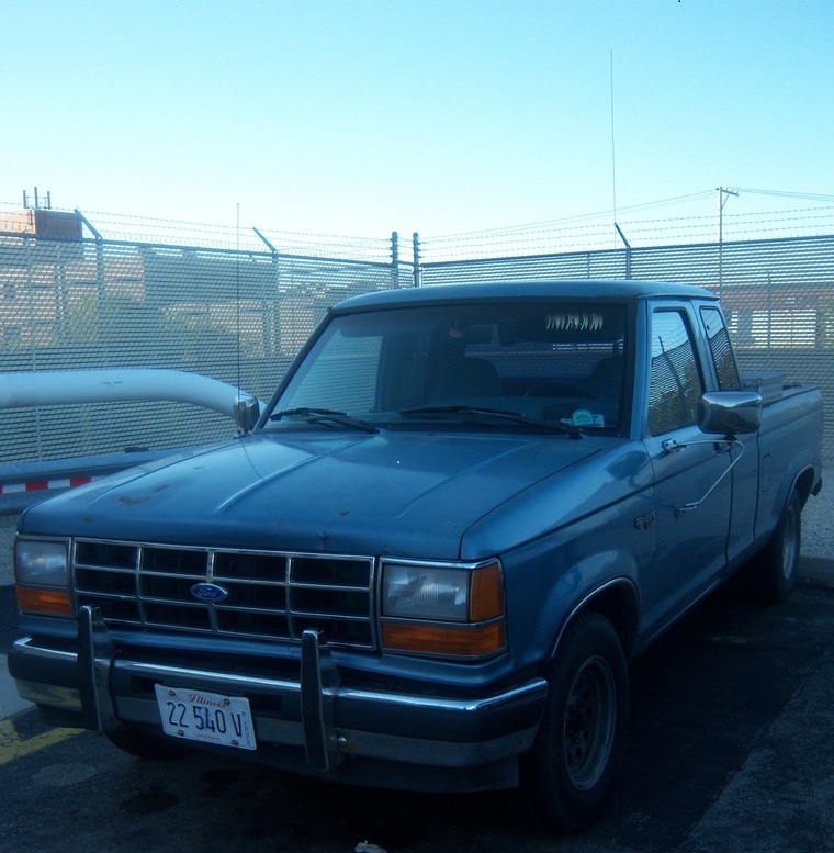

I want to do a V8 swap into my 1990 ranger, but funds are tight so i cant afford brand new parts. i was hopeing there was anyone here that has parts they are willing to sell or know of a place to get them used. i already have a built 302 and AOD out of a 83 mustang but i need everything else. please help out another ranger fan and help me get my project on the road.
