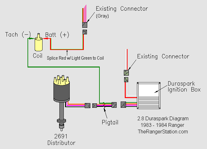

It should, mine did (for a 2.8 though)
This is how I have mine wired, works great. I left the stock wiring to the coil in place and just spliced in where I needed whatever kind of power I needed.
awesome diagram. thank you. what would i use for the ignition module though? mine dont have that do it?
